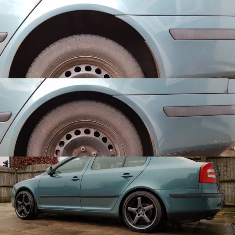

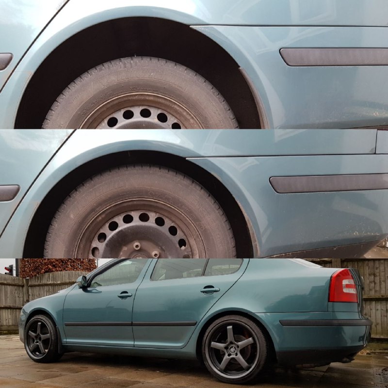

- Rear coils on, yet to do the fronts, but... it's not low enough for me... :D Here we go again!

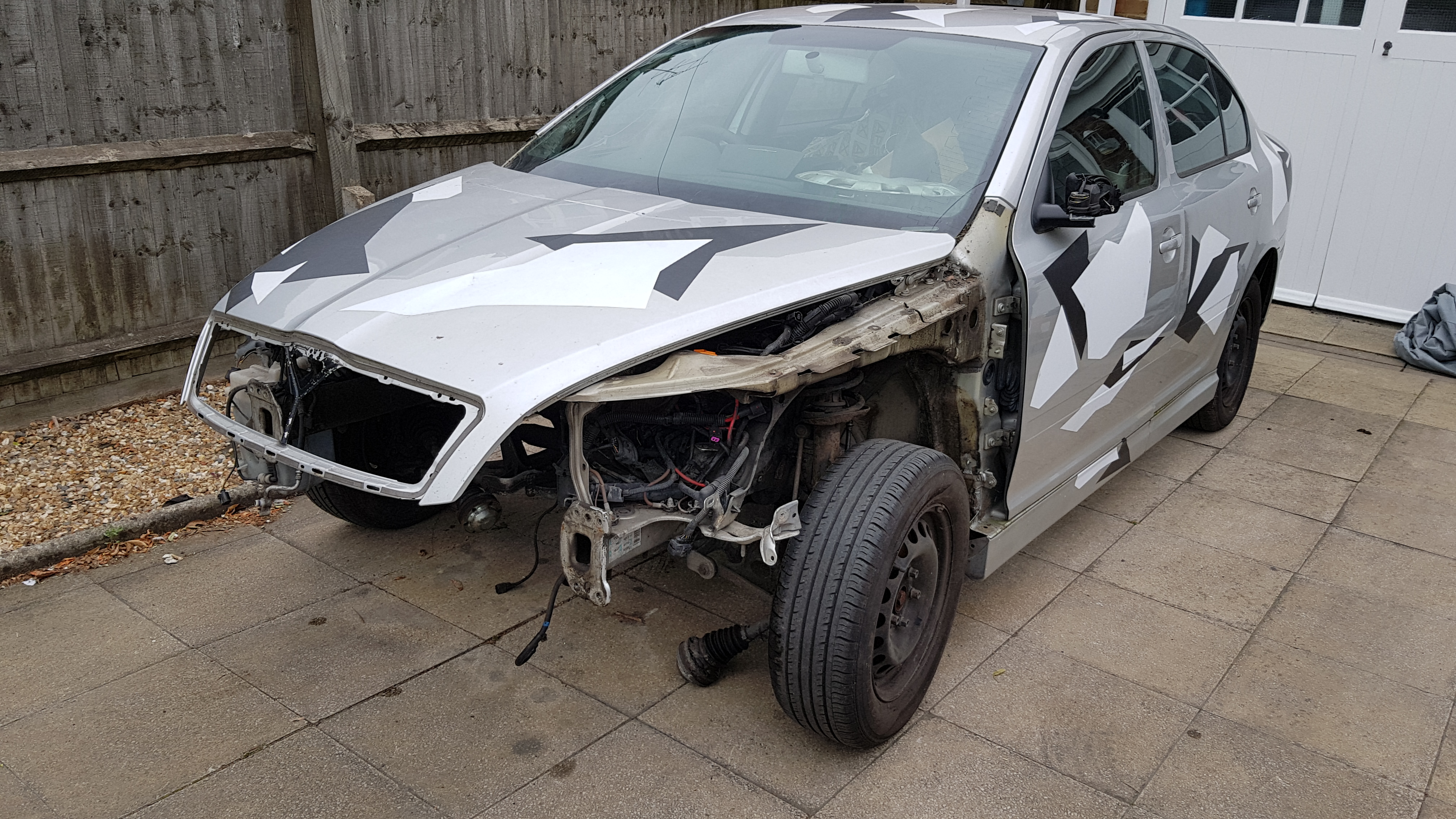

Not much to report on. Dead Skoda taken away the other day by ASM.

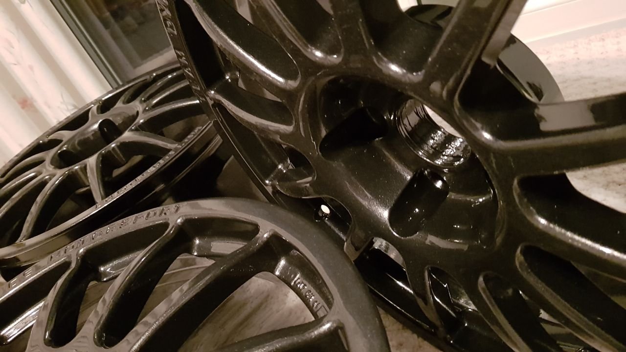

Bagged a set of Team Dynamics Pro Race 1.2 in 17"s \o/ Woooo
A fine choice!
It's amazing what a difference the simple change of a rear anti roll bar does to handling. Well, I say simple. Garage mentioned that pretty much all the bolts snapped when they removed the old bar. It's pretty rusted underneath. May look into getting another sub frame and getting it powder coated and what not, then replace the rusted one. The rest of the body is okay, just the frame, but never mind that. I'm having too much fun with lift-off over steer at the moment!
I have the new wheels in storage currently. Coating and rubber will have to wait until next month because I'm poor, which I also have a week off work to reinstall the turbo and all the other goodies sat in storage. Then it's off to get mapped again.

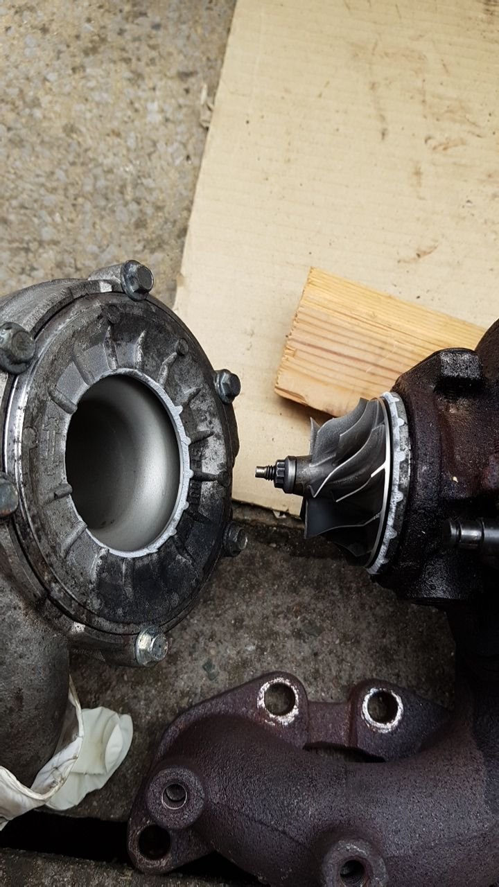

Few days later. No reply from Narco about having a new map. (And still nothing to this day. Somewhat disappointed) Friday, on my way to a drift session at DriftLimits, It goes into limp mode. Okay I think, more teething problems. Do the session, go home and check over. Overboost error. Check the VNT arm. Its solid. So out with the good old oven cleaner and do that for a few hours. Still stuck. It's currently Saturday, it's starting to eat into my other plans I had, so its all or nothing now. Made the call to remove the turbo and strip it by hand and clean it out by hand. Undo everything, squeeze it out of that stupid gap (For real. That gap needs just an extra inch and you can slide the turbo out, but nnOOOOooooo)
Get it all out. Put it on my lap. Start undoing bolts and then... it slid off my lap... to the ground... with a dull hollow clonk. It didn't sound good.
I lifted it up and found the compressor side to be... floppy, as it then came off in my hand.
Not sure unhappy really covers it currently. Undoing most of the work, still nothing back from Narco and TurboTechnics want around £500 part-x for a new unit which I don't really have...
