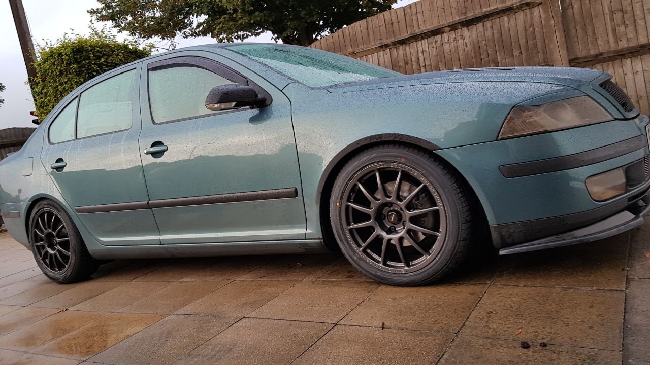

So I spent three hours getting home, after plonkers rubbernecking on the M23 brought it to a halt... I get home, had a quick dinner and set about putting the new wheels on.
Got them all on and as I'm putting the old wheels back around the garden, I find a pile of wheel weights. A LOT of wheel weights. Would appear they've not stuck to new wheels good enough and have just fallen off into one pile.
So all the new wheels came off again.

The wheels had come back from Max Powder last week Thursday and had been 'curing' in the warmth of the conservatory over the weekend.
Well, they did look good whilst on the car... for all of ten minutes!

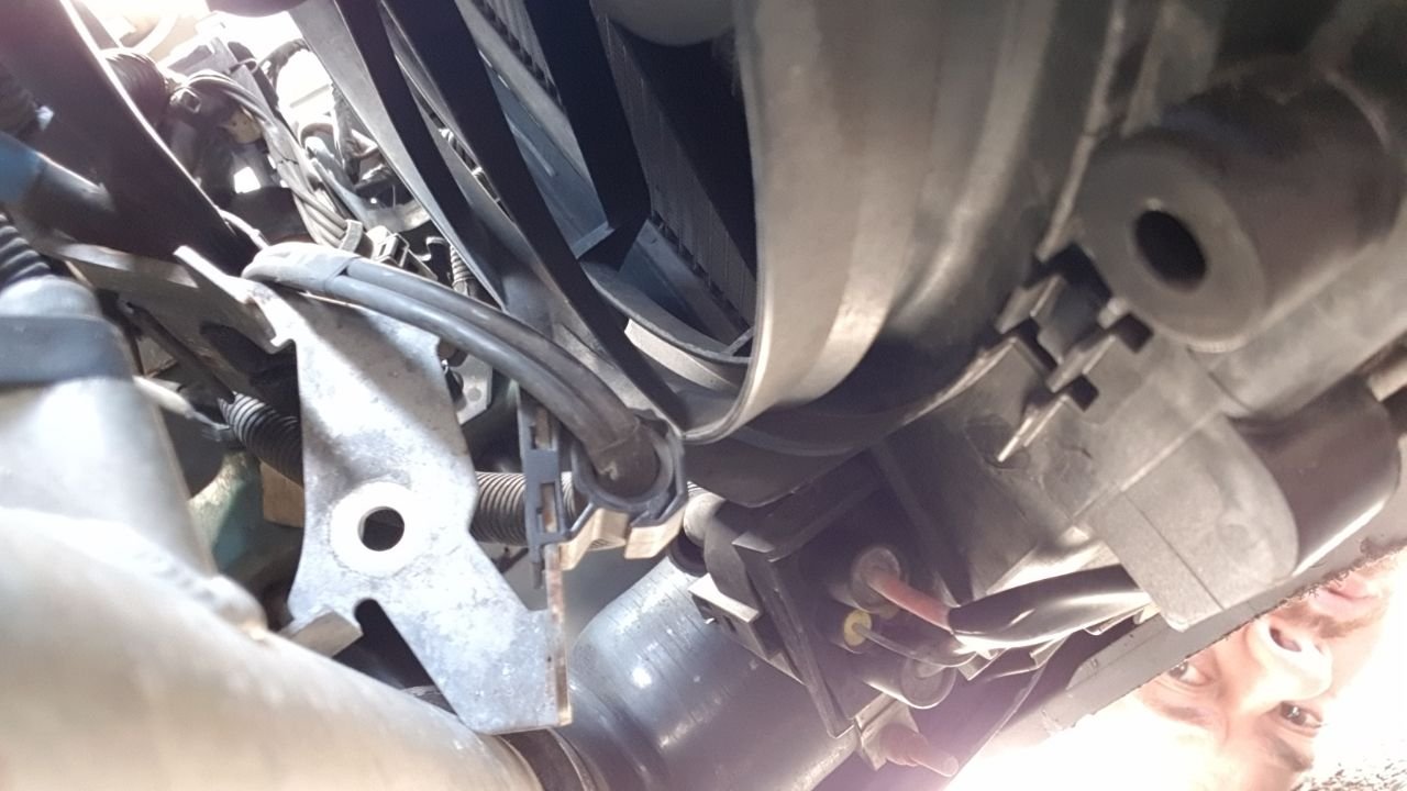

But had a question. Could hear some metal on metal clonking from the front, so had a poke and found this bracket hanging about. (To the left of the picture, resting on the intercooler pipe work) It wasn't there before, but I can't see where it goes.
I can only guess it goes somewhere around the gearbox/starter motor, but I'm not able to have a good look at the moment until I reach home and bung it on the ramps.
That goes on the stud on the end of one of the starter motor bolts with a 13 mm nut.
Noted, Will have a better look when home.

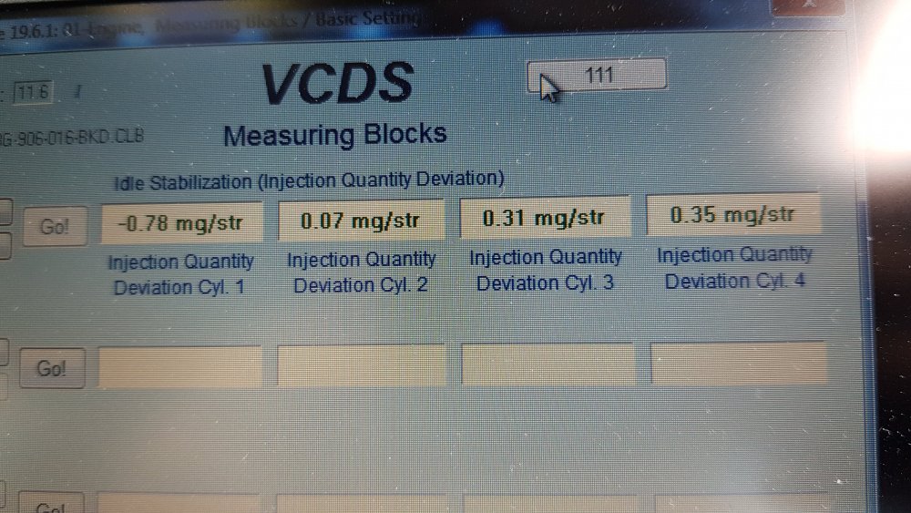

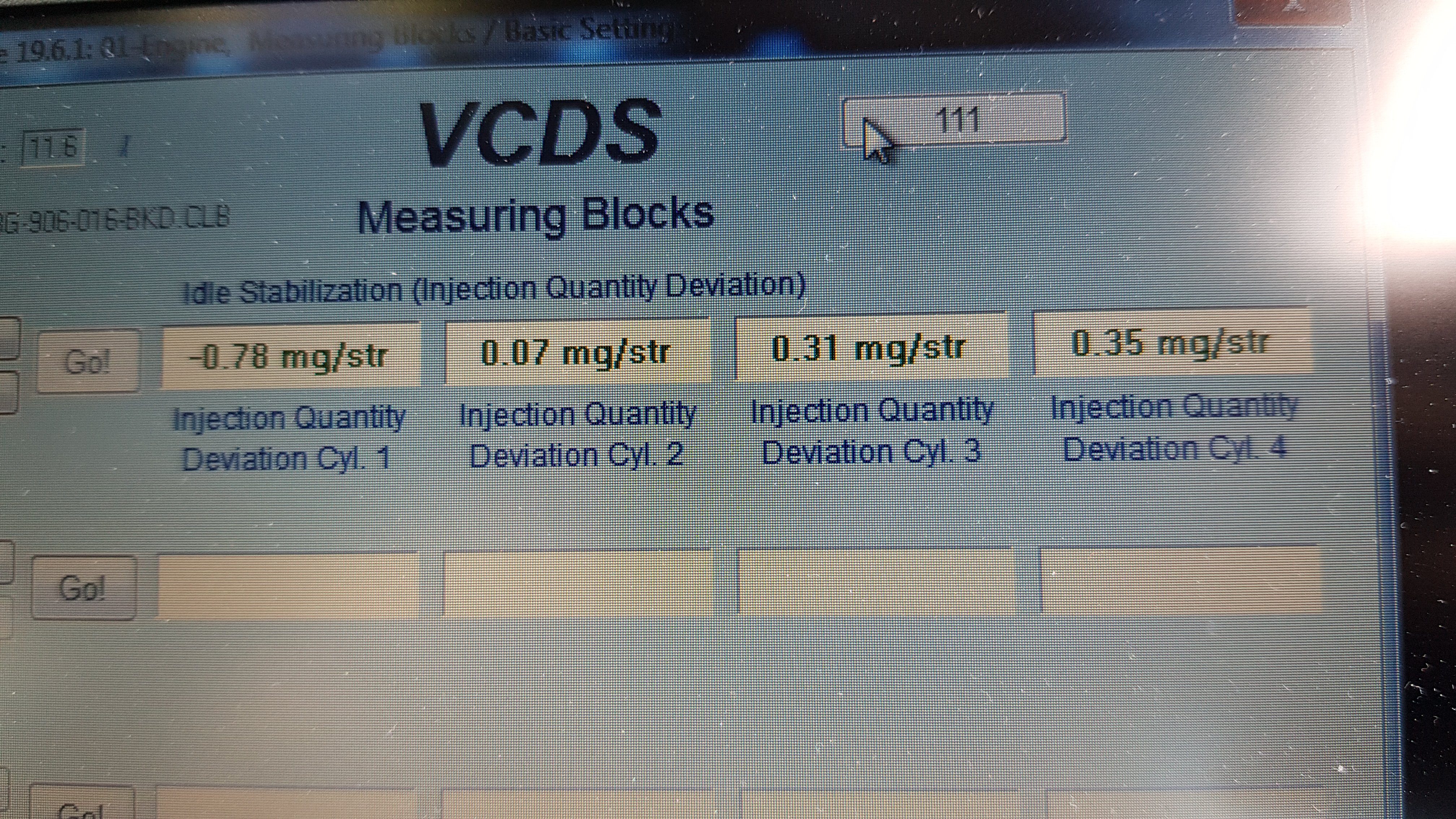

I have some reason to believe not is all well currently, but wondered if someone could glance their eye over my VCDS reading for the injectors.
Basically:
Car starts drives fine. Warms up. Only when it gets warm does it smoke. But it only smokes when I've been sat at a light or junction or other reason to stop. As I pull away, there is a HUGE plume of smoke. It's hard to tell, But it looks grey. The black soot on the exhaust pipe says to me it's either fuel not burning, or oil. But I can't find any other evidence to suggest its oil.
It did smoke a bit BEFORE the map I will point out, but it seems to be getting worse lately.
No smoke as I'm driving or on boost. Not using oil as far as I can tell. Only when its warm, sat and pulling away from a stand still.
Any thoughts?
VCDS readings okay?

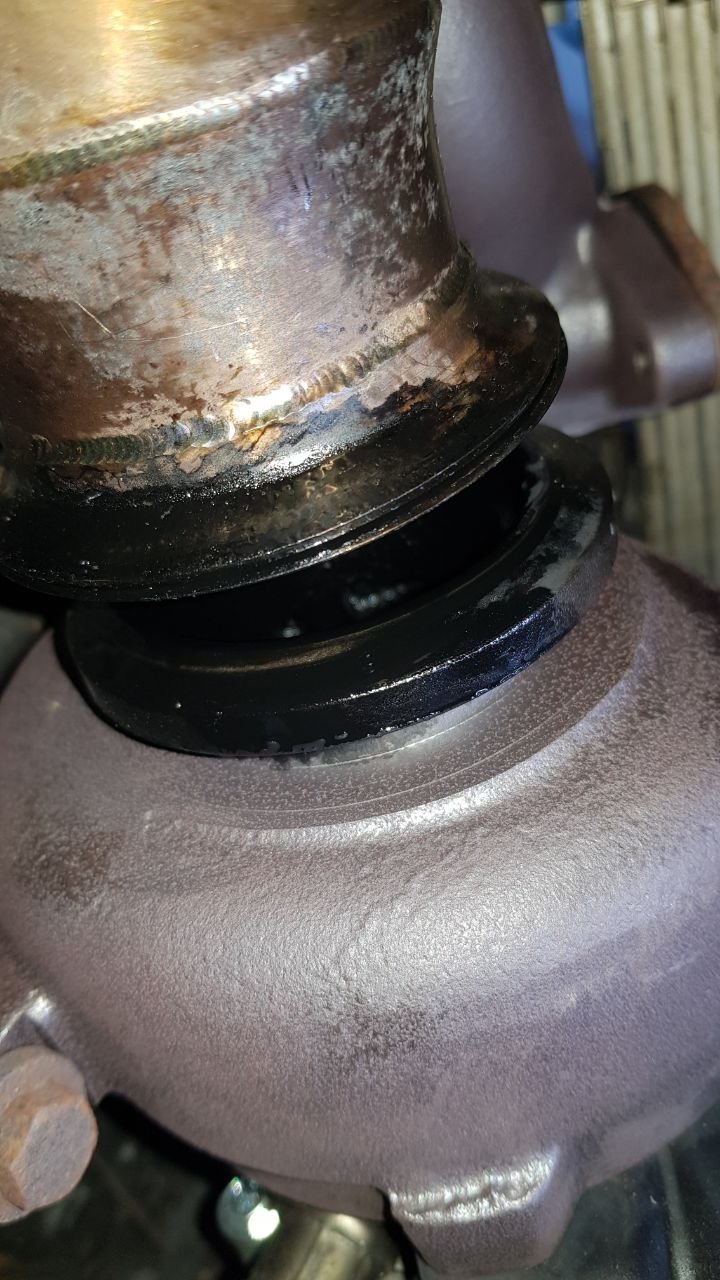

Hey erm, recall my smoke problem? Well...
Oh.
Oh no. A sad snail indeed.

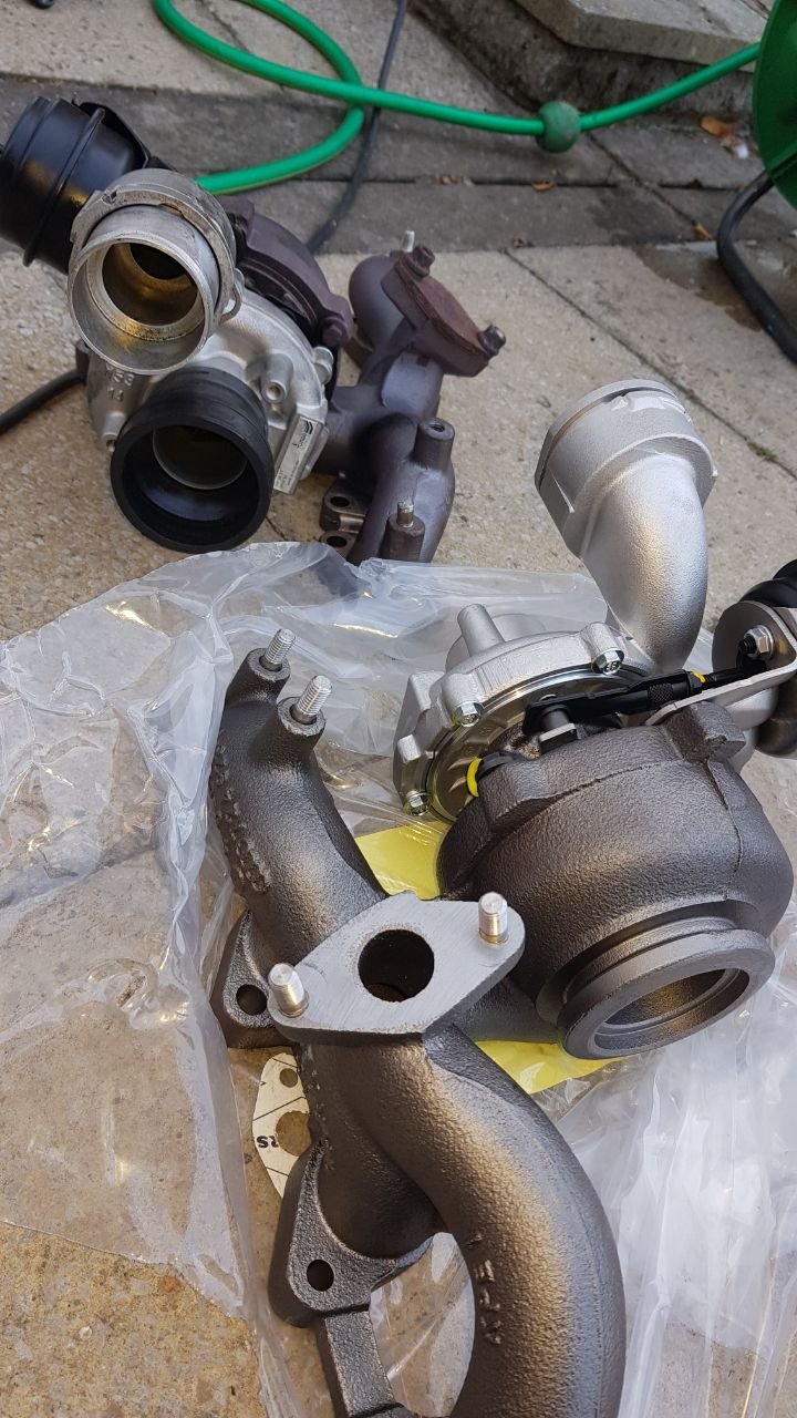

It's a good thing I had another brand new S212 sat in a box then!
Either something has gone very wrong internally, or I'm just not having much luck. This turbo wasn't even 4 months ago in use...

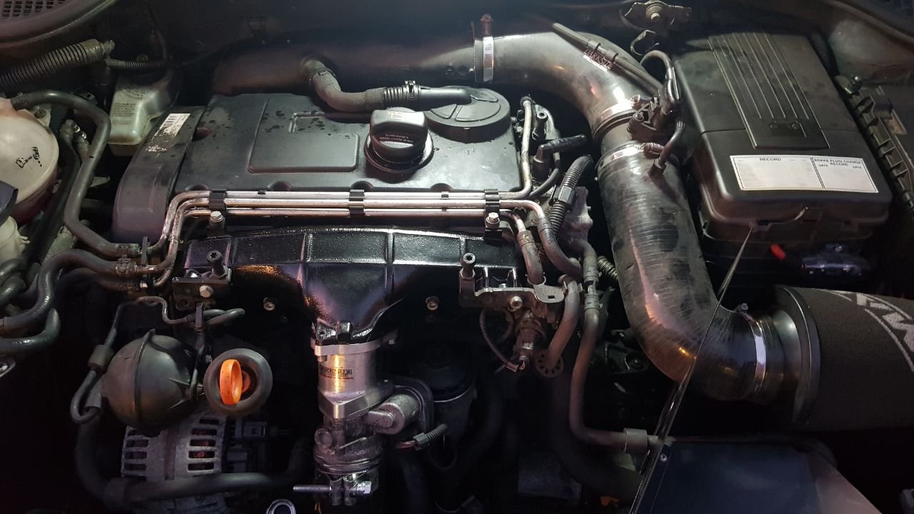

Slightly modified intake. Painted with heat resistant paint and removed the lump of metal on the right hand side of it, just above the EGR (Which is now removed) Unseen is the EGR cooler delete also.

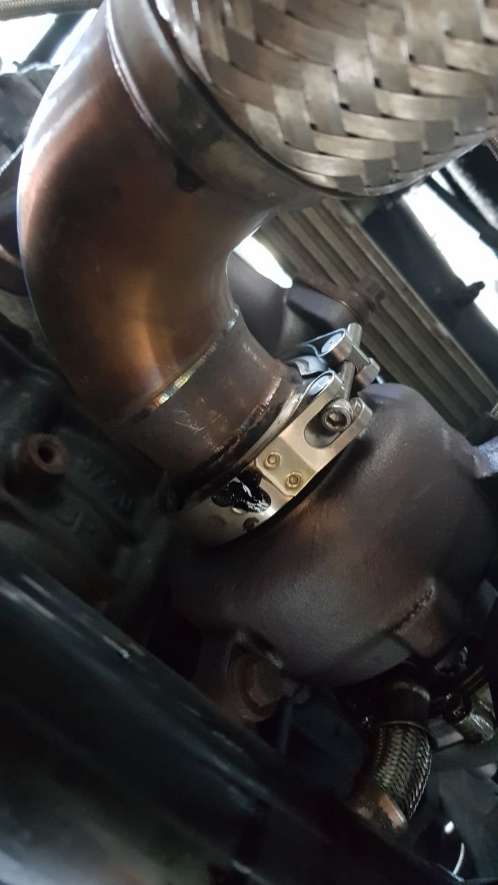

Okay been a while BUT GOOD NEWS EVERYONE

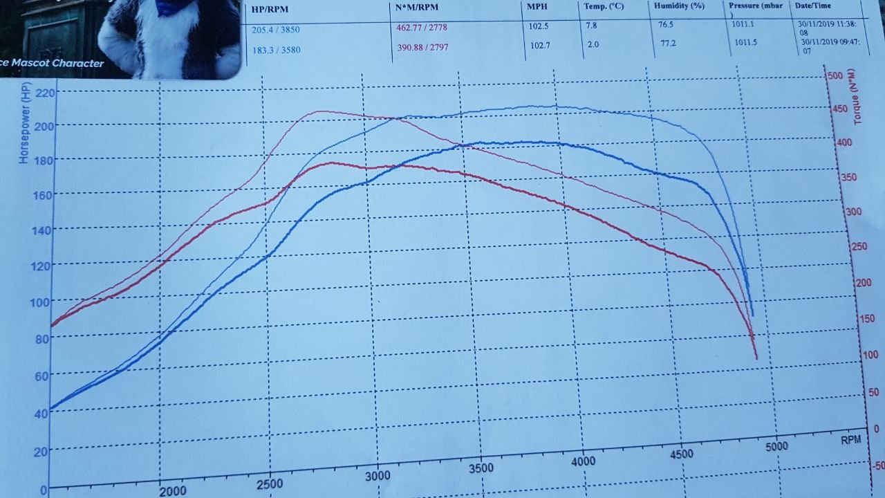

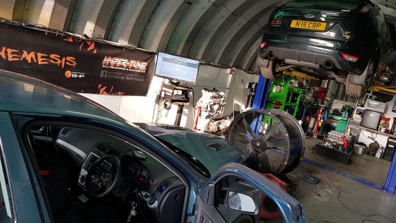

Popped down to Hyper-Tune again after changing out the duffed turbo. Not had a closer look at it yet, but going to guess a seal has failed. But, had another one, so in it went.

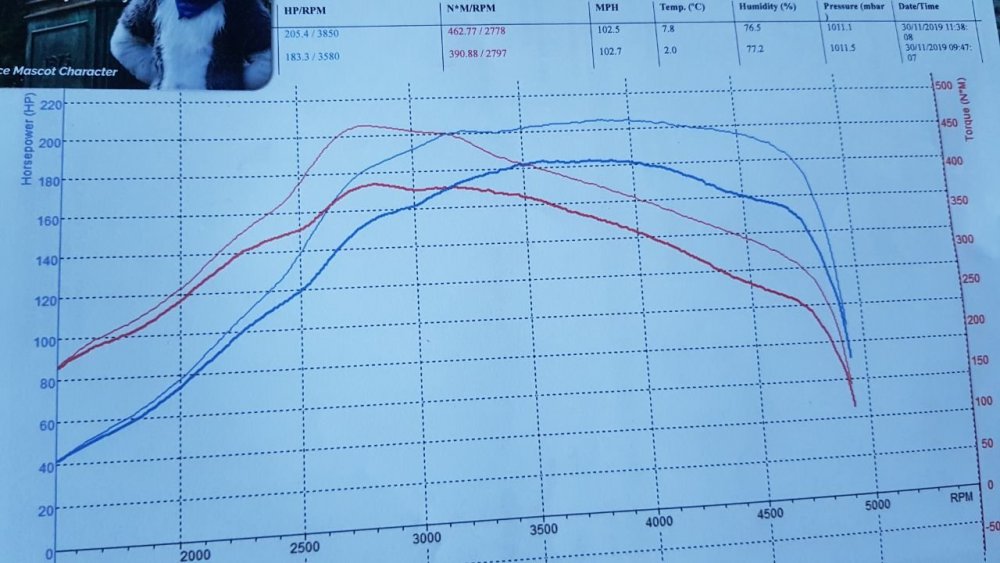

The base map was from Angel-Tune, so not the original map, Always room to improve on it, but Hyper-tunes opinion on the map... isn't repeatable (!) So a lot of fueling and timing was re-done.
Can't go wrong with 205hp/462nm (340ish Lb'ft) Not as much as the original Silver Octi I had, but for the sake of reliability and drive-ability (Is that a word?) Wasn't going to push it to the limits of the original injectors.

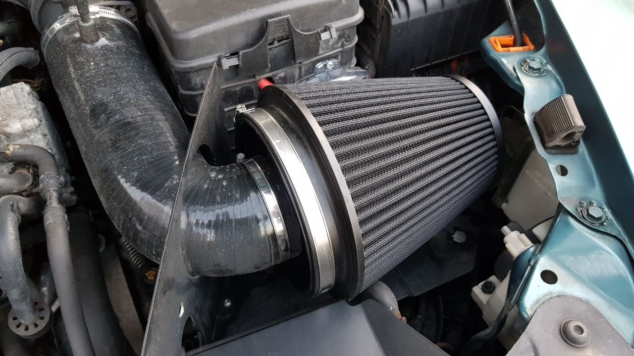

Also treated it to a new non-foam intake filter from Hyper-tune also. Yeah, I know, bay needs a clean.
