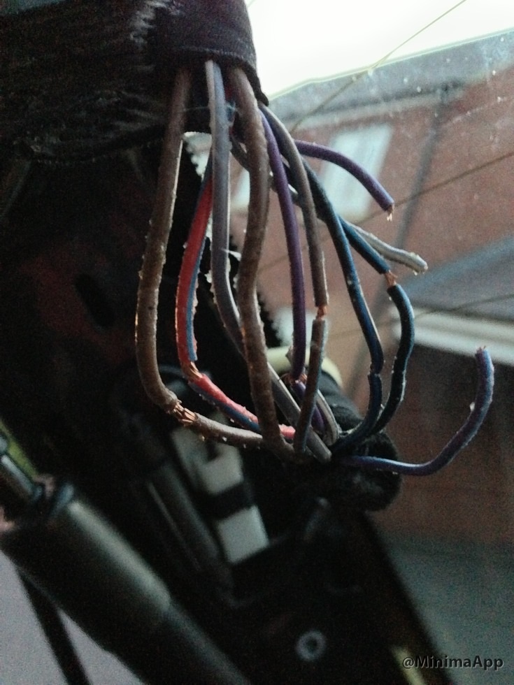

Hi Guys/Girls.
just got my car back from Skoda regarding the light fault. this is just a quick post as i don't have much time, if anyone needs a more detailed explanation i will be happy to do so.
long story short, its broken wires between the boot lid and the glass in the twin door. see piccys below

I recently had similar problems with the rear fog light in my '09 Superb Twindoor. It started with a warning that the left rear fog light was out so i replaced the bulb then it said the right rear fog light was out so I took that one out to test it and it was fine, after putting it back in the maxidot then said both left and right rear fog lights were out.
I started remove panels inside the bootlid to trace the wiring back and found that the same wiring loom as mentioned above was broken in a similar way (see the attached photo).
I don't understand how skoda ever thought that this would last, it's a wiring loom that bends back and forth by about 60 degrees over a square metal edge every time you open and close the boot lid!
I am sure that this will happen to many of the Superb II hatchbacks over time just depending on how often you open the boot.
I have temporarily fixed mine by soldering the broken wires back together but this will not last long. It needs the loom replacing and a strain relief fitted to spread the load over a larger area when it's bent over the metal edge. Unfortunately it looks like it won't be very cheap to repair properly but I think that this should be covered by Skoda even if the cars warranty has expired, it's clearly broken down to poor design.

Looks like I'm having this twindoor harness issue as well in my 2009 sedan: faulty rear fog light bulb from the "wrong" side -message, and the trunk lid buttons quit working. I can only open the smaller lid with a remote.
Based on the good pics in this thread it looks that the harness will break around in the hinge area and in order to get access to there you also need to open the "large trunk-lid" (twindoor?). I removed the smaller lid inner trim and all cabling seemed good there.

Hi, sorry I didn't get around to posting pics of my experience fixing this fault, I will do it in the next couple of days. As for the wrong light messages the plugs do only fit one way but I assumed I had incorrectly joined the two brown earth wires also my wiring fix is only temporary and I'll buy the loom repair section next time there's a fault.
