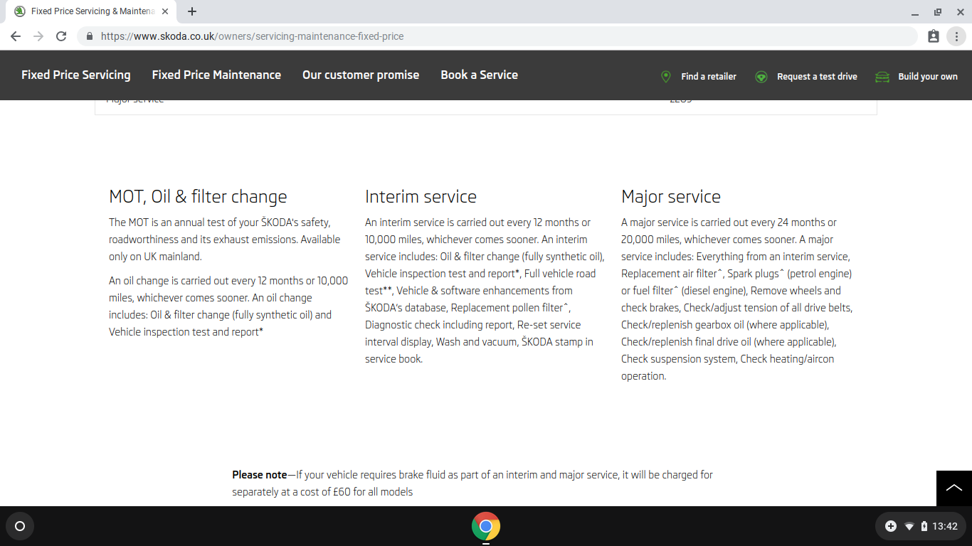

The Skoda Fixed Price Website / Advert really is saying again that the wheels will be removed at a Major / 20,000 mile service.
That would be at the 2nd / 40,000, so 4 years maybe if even then.
A few years back where there were rear drums as there still are on the same cars that had them,
the site also said Check Brakes, and some places did, but still the wheels were not off after, 1,2,3,4 or even more years with Full Main Dealer Servicing.
So those trusting to a Service Plan or FMDSH should maybe ask for the things that supposedly gets done. Or not as the case is.
