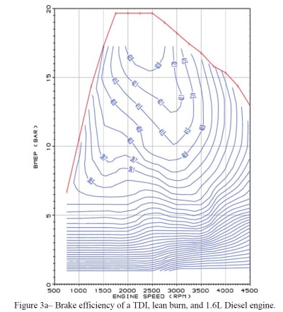

I found a BSFC plot for the 1.6tdi in a research paper which was not officially supplied but created by the researcher. It is attached below.
