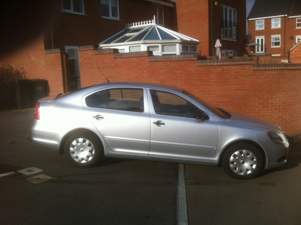

Hi there, see attached pic to get an idea of the slope I used.
Put car into reverse, it didn't go forwards at all, just crept smoothly back up the slope, I didn't touch the accelerator, as on the flat revs climbed to 1000 rpm

Thank you, that confirms for me that my car is not behaving as it should. Mine would definitely not crawl up that slope without lurching.
