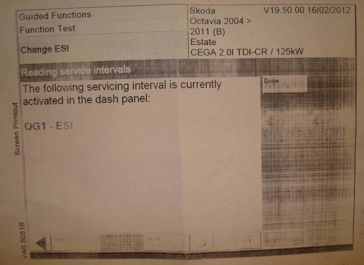

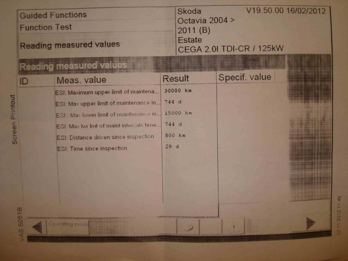

Another update.
Dropped into another dealer the other day and they checked it out. The settings they found are below. Are these what they should be? At this point the service display was showing 8900miles and 343 days.
READING SERVICE INTERVALS
The following servicing interval is currently activated in dash panel: QG1-ES1
READING MEASURED VALUES
ESI: Maximum upper limit of maintena... 3000km
ESI: Max upper limit of maintanance in...744d
ESI: Max lower limit of maintenance in....15000km
ESI: Max lwr limit of maintenance intervals time....744d
ESI: Distance driven since inspection 800km
ESI: Time since inspection 29d
They said the settings, although correct, didn't match the display as I know only too well. They have reset the whole thing again so I'll have to wait another 350 miles to see what happens this time. If it doesn't show the correct info this time they say there is a problem with the instrument cluster which will need replacing under warranty.
