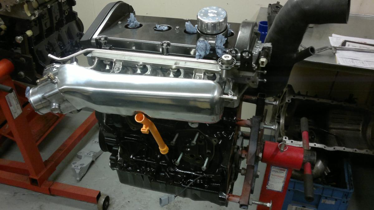

the full build spec of the engine and box are as follows....engine bored to 1.9L,scat rods,JE pistons,fully lightened and balanced bottom end,full arp bolts,ported/polished/gas flowed small port head,port matched manifolds,supertech inlet valves,inconel exhaust valves,uprated springs and titanium retainers,new gaskets,cambelt etc, agn smooth cam cover,pro alloy motorsport spec baffled sump,polished air con pump,alternator,inlet,034 billet fuel rail,saikoi michi occ with black braided lines,vt engine mounts,rebuilt LCR 6 speed box,awesome gti 400lb/ft clutch kit,20lb billet smf,quaife atb diff,all new s/s bolts where possible,gaskets and seals!

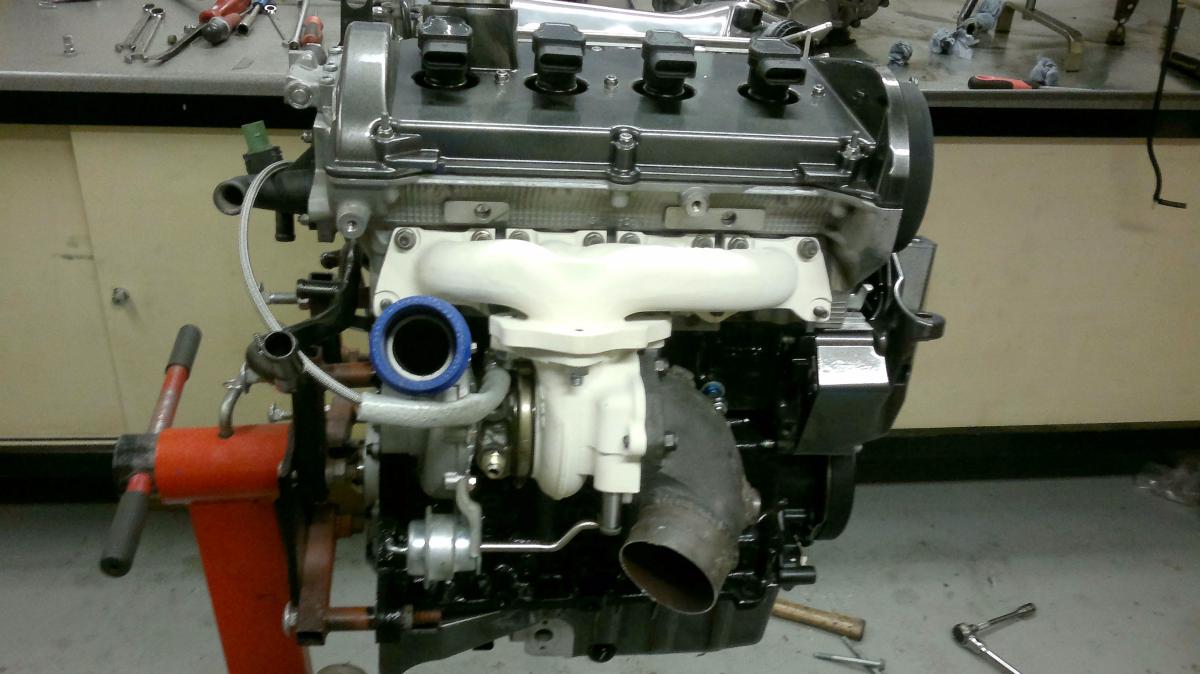

the turbo kit spec includes a jabba ceramic coated manifold,an IHI VF22 hybrid with td05 (360-370bhp capable apparantley) wheels also ceramic coated,custom jtech downpipe,bosch 450cc injectors,badger 5 custom ally/silicone TIP,rtech CAI with heatshield,bosch motorsport fuel pump.

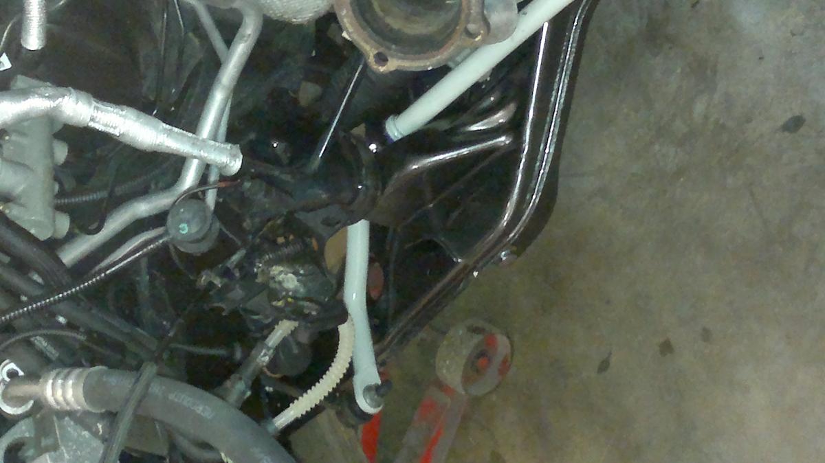

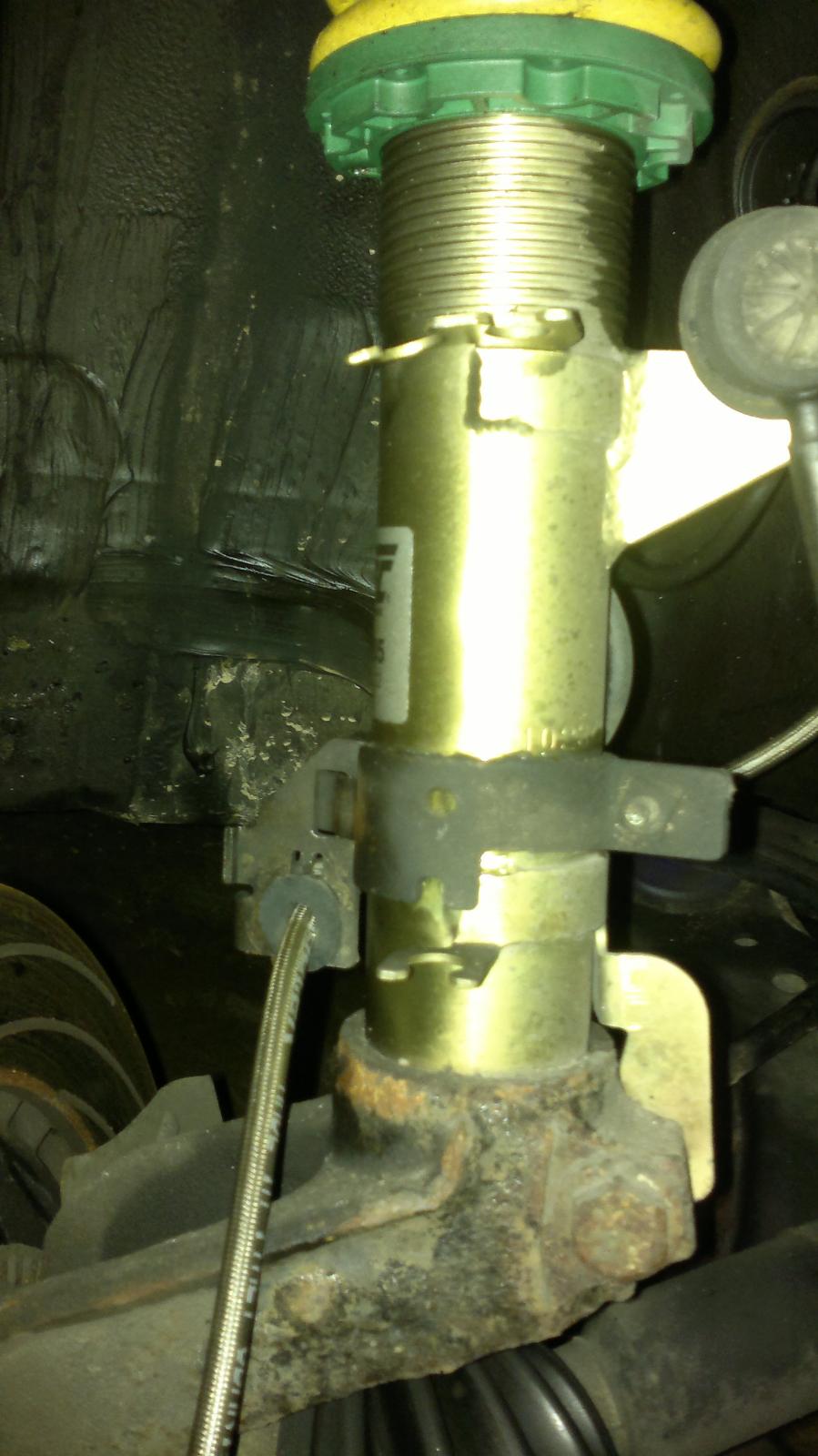

the first part of the build for me was to get the deconstruction under the car started! i stripped all the front end off the car first,got all that powdercoated in gunmetal grey with gloss over the top! then put new powerflex polybushes in! as the car came apart it became clear that a few extra parts would be needed,mainly things like wheel bearings as they **** themselves when removed,abs sensors,track rod ends,brake pipes,clips for the brake pipes and the like! below is a pic of the front suspension before...
Edited by vrsmark

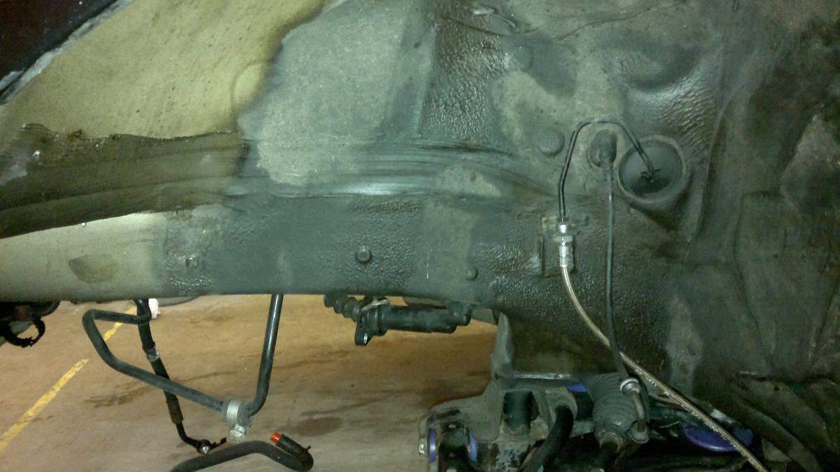

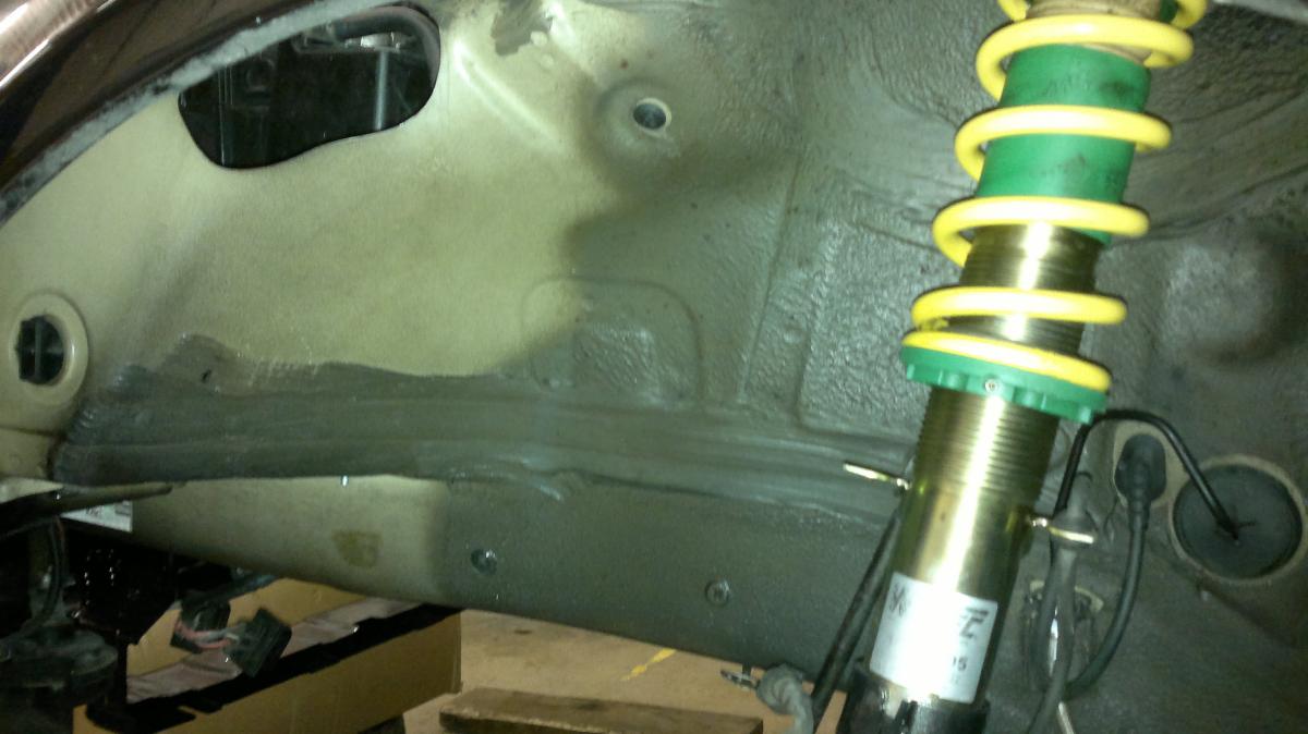

once removed the front arch looked like this,a big stinky mess!
Edited by vrsmark

after the arch is cleaned,which takes about 8 hrs (if you do it all the way up behind the wings),it should look like this!
Edited by vrsmark

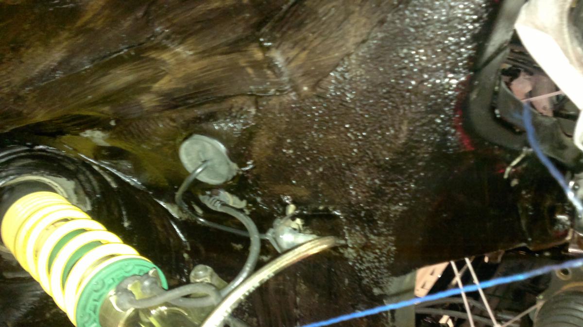

then its ready for some underseal! i used the waxoyl underseal from halfrauds,it was £15 for 2.5L and its enough to do the underside of the whole car.once applied it looks much better,if a bit shiny.it does go a bit dull after a few miles though.
Edited by vrsmark

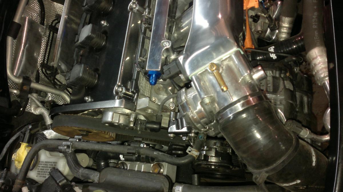

manual tensioner will give you security if reving hard past 7600 as you have a built head with valves springs etc you can safely rev to 8500
but with a normal hydraulic tension it has to much stress forced onto it due to high loading of the double springs so can fail causing belt failure
witha manual tension you get rid of this issue 100%

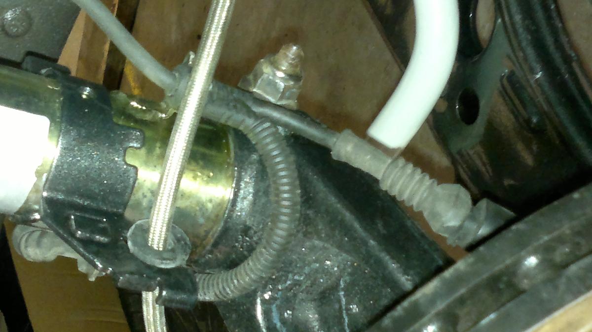

some how i dont think the ihi will still be producing power at 7500rpm tbh,i think it will tail off before then,say 6500-6700 at the latest off the top of my head! the picture below is the only one i have that i can upload due to the file size,that may show the area of the tensioner.there is a coolant pipe in the way though!!
Edited by vrsmark

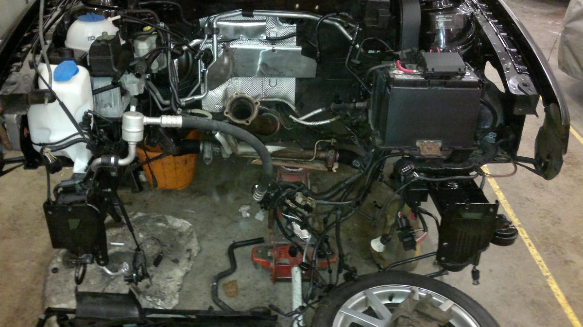

as the suspension was at the powdercoaters i decided to strip the front end. dont be intimidated by this,its really straight forward.just dont lose any bolts,clips or radiator mounts!! i renewed them anyway,but kept the old ones in labelled coin bags from the bank,just to be sure....the picture below makes it look worse than it is,trust me!
Edited by vrsmark
