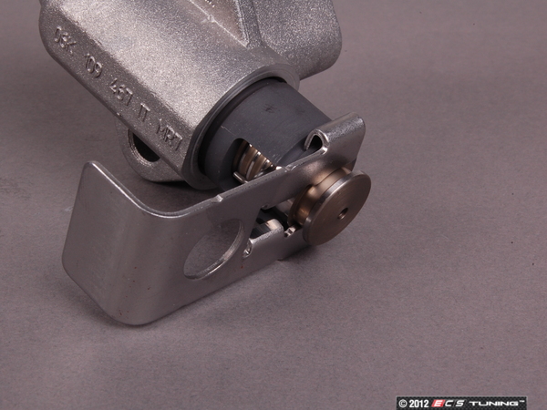

  • Finally we have confirmed that the tensioner is faulty!!!! It took us to go to the dealers ourselves and show the mechanics the fault, but finally we have both arrived at the same conculsion..... The

I now have a copy of the Skoda Technical Product Information, detailing the exact fault with my car... The fact that they have known about the fault since June 2012 at least (thats the latest revision of it anyway, not sure how long before they knew about it)
My dad is off to the dealer who has my car today, to test the tensioner himself (following the instructions in the TPI) as we do not believe the dealer has carried this out themselves, or has and is not telling the whole truth....

Thinking about it again... The tensioner operates on a ratchet system such as serrations on a knife blade if you know what i mean... If the tensioner serrations have worn away at any point along its length, it could have re-tensioned again on one of the not worn out serrations thus showing now as being in perfect working order.... The tensioner needs stripping to confirm there is not internal damage.... Which obviously has not been done!!!

I enquired and my dealer said the updated tensioner WAS available (think it was about £100 or so), was on it's FOURTH version (guessing that would make it a third revision), and it would obviously incur labour charges to fit.
It took us to go to the dealers ourselves and show the mechanics the fault, but finally we have both arrived at the same conculsion..... The tensioner is fecked! :-)

Whether I believe the mech or not, he said he tried the test several times without fault, seems strange though that when we pressed on my tensioner it shot straight back into its housing, the ratchet mechanism was completely screwed!
