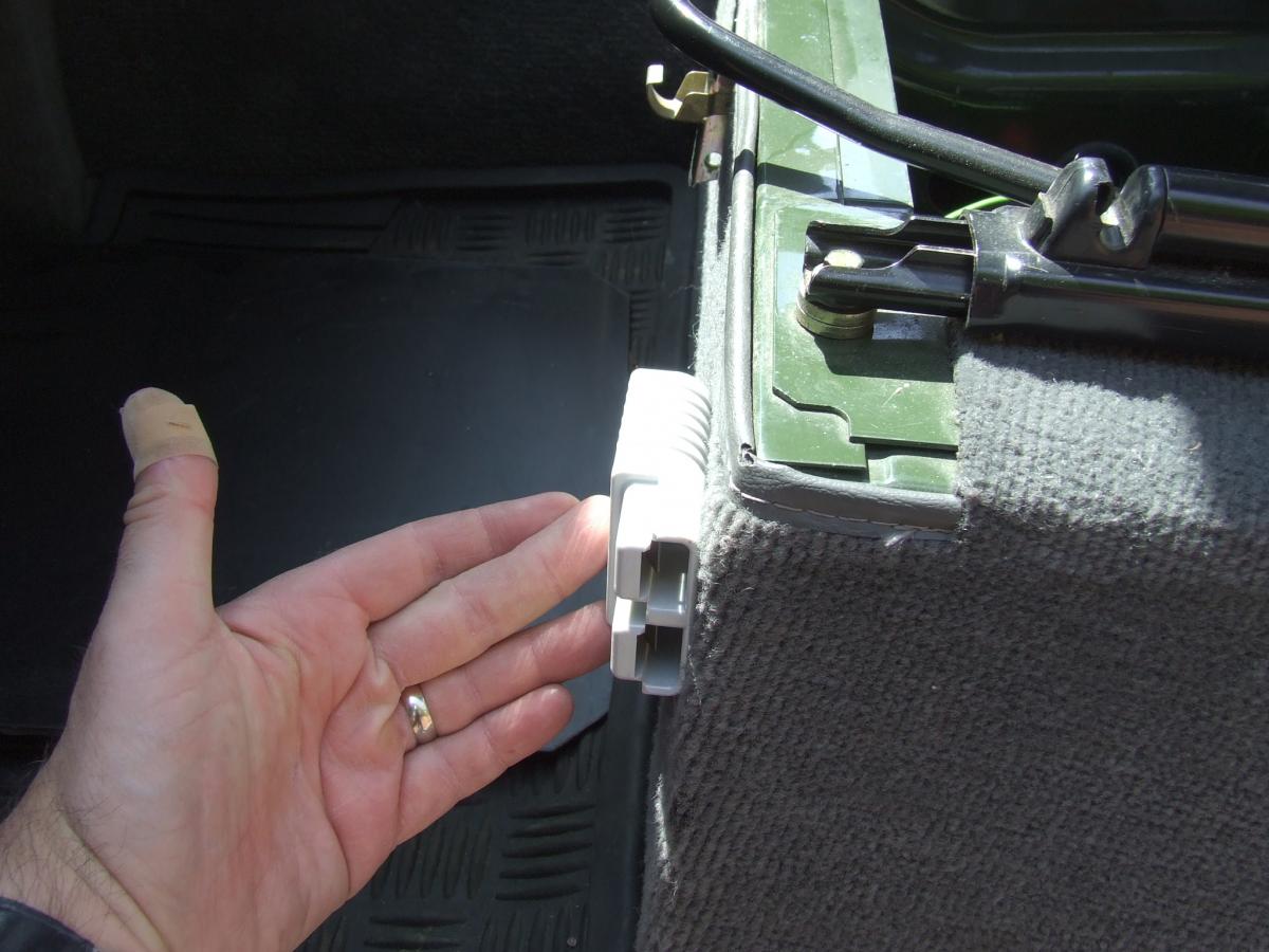

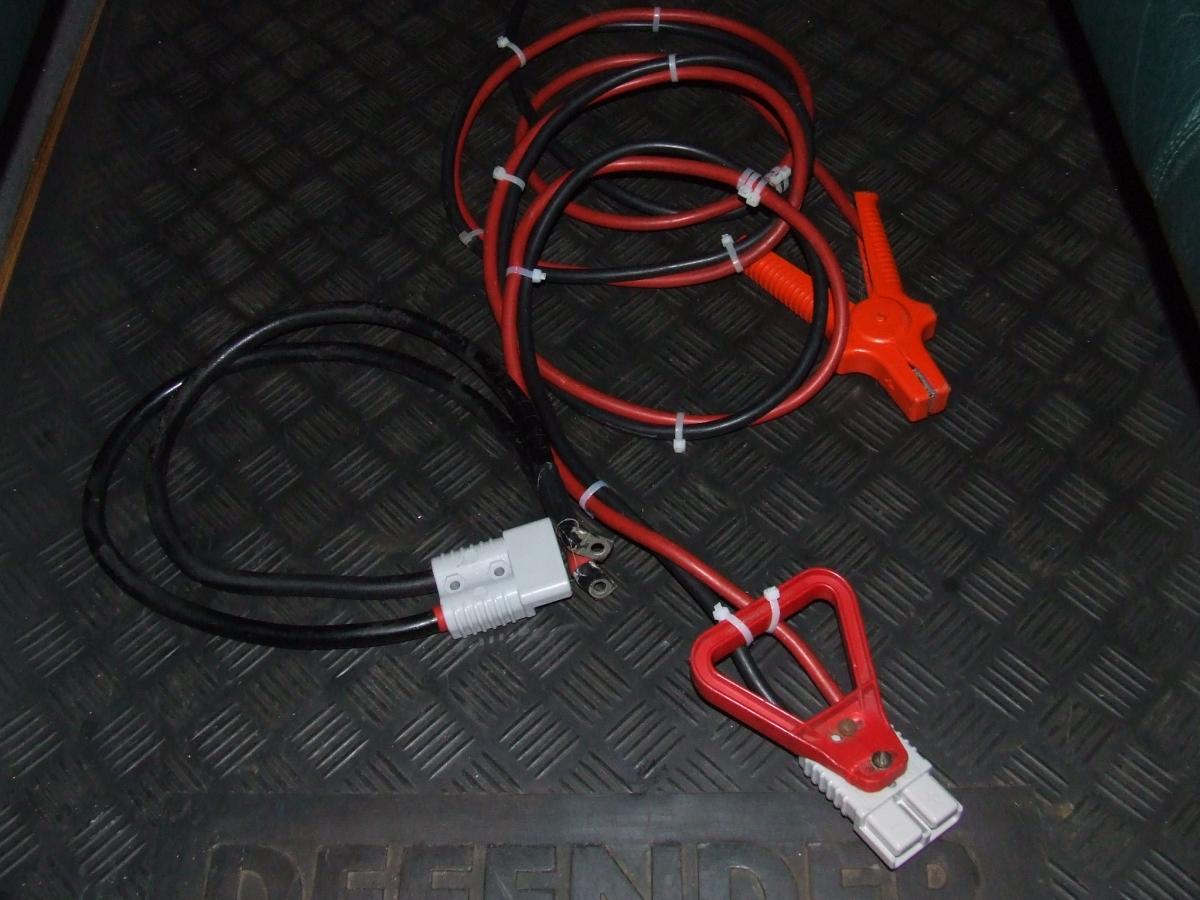

When I had my Land Rovers, I made a set up.
These were 600Amp welding cables, with the terminals (Anderson plugs at the battery end, with a permanant attachment) crimped on via a contact who serviced fork-lifts\
i think they're about 20 foot long? (still in garage, even if my last Landie isn't)
Now that's what I call ' a set of jump leads ' ....
