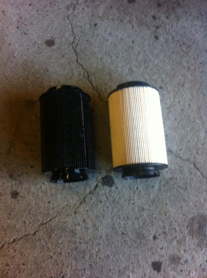

Well I have had the Octavia over a month now and I have worked out all of the little Jobs that need doing to it, So this weekend I set about a few of them.
My first Job was to service the car, It has full Service history ( well it has the stamps/recipts in the service book) but as it is on a 55 Plate and is well outside of warrenty I will be carrying out all of its services and minor work myself for the rest of its life with me.I drained the oil and changed the oil filter, changed the air filter and all looked good ( air filter was not to grubby so looks like it was changed at the last service) then I moved on to the fuel filter.
OMG!!!! for a car that has full service history I have never seen a fuel filter like this on any car I have had, I watched a how to video before changing my filter and the one taken out was only a light shade of grey. I dont think it has been changed in the 72,000 miles the car has covered, Just goes to show that a full service history should only be taken as a guide line that the car has been looked after.

Diesel fuel filters go black very quickly, this is why its replaced every 20K miles. They all look like that when they are removed, diesel is after all oil and is constantly running around the fuel system when the engine is running. The fuel pressure is constant and unused fuel is sent back to the fuel tank via the return lines, resulting in what you see in the first post.

I must admit mannyo I have never had a diesel filter come out that black before, my last car was a peugeot 406 HDI and I changed the fuel filter every year and I did 12,000 a year and it was never that bad , also My car had a stamp and invoice stating it had been serviced one year ago at 64,000 miles it currently has 72,000 on it, the car is set to variable servicing ( although from now on it will be serviced every year or 10,000 ) and has stamps every 2 years at around the 20,000 miles marker so it should have been done 3 times, my guess is that it was not done at the last service and as all the stamps are from the same garage I have to question if it has ever been done.

PDs are known for blackening their fuel filter very quickly due to small traces of injector blow-by and oil from the tandem pump getting into the the fuel system. The official service interval is far too long IMHO. It should be less of a problem on a CR however.
The filter on a PD can get like the one in the pic in 20k or less, but in my experience common rail fuel filters can go double that mileage and only be slightly discoloured.
Same experience with mine, I serviced it myself so I know it was done.: Changed at 2 years 17000 miles and 4 years 38000 miles. on both occasions the fuel filter came out pure black. I am reverting to fixed interval servicing and I will do it once a year from now on.
It's a 60k to 80k interval on the MK 2.
FWIW you can end up with the tandem pump putting oil in the filter if it's an issue.
Was going to say it isn't 20k and hasn't been for a long time. My 1.9PD Bora is 50k intervals iirc but always have it done at around 25-30k.
