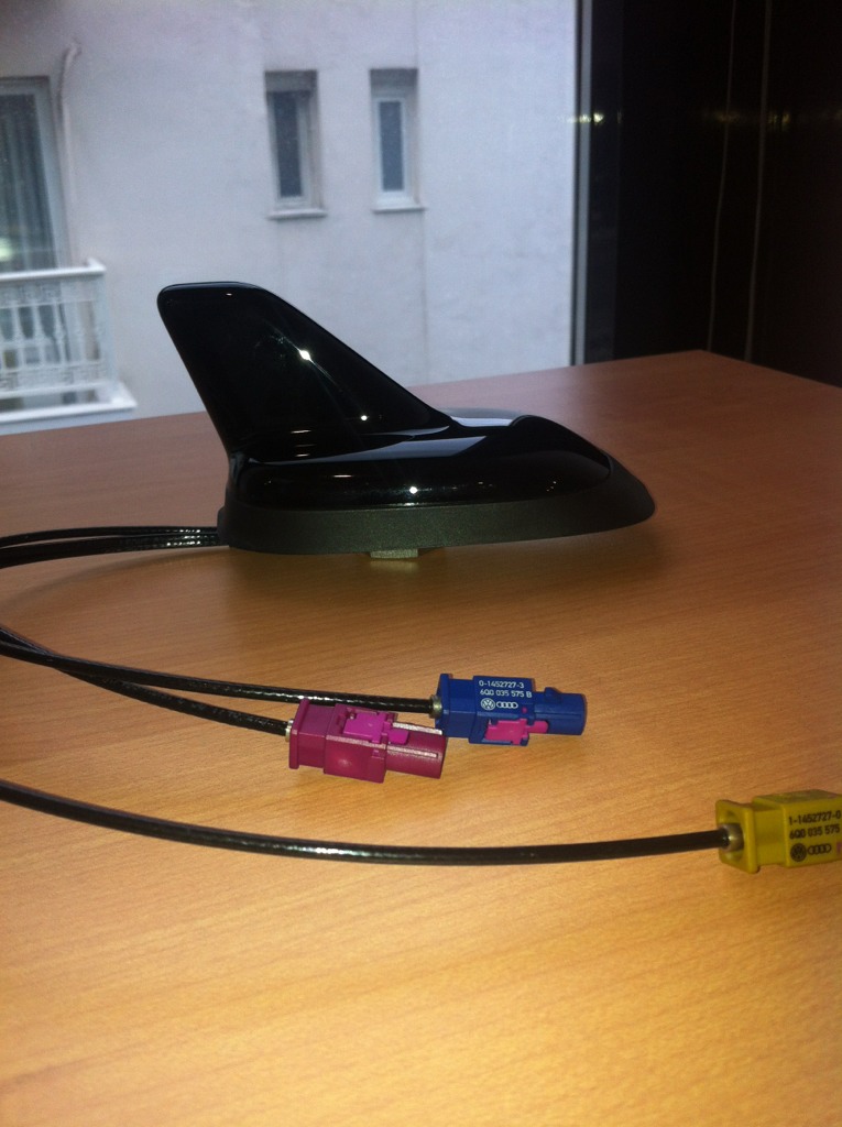

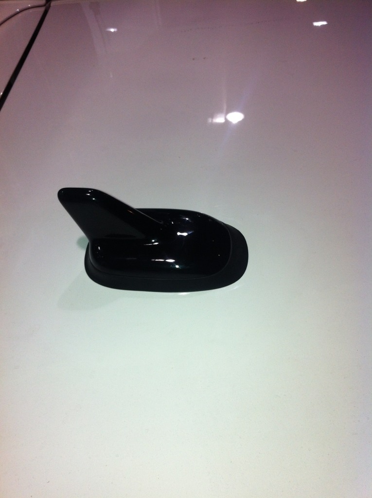

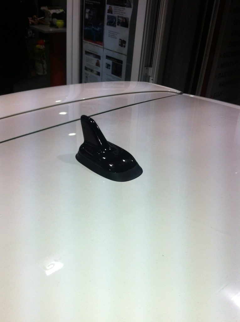

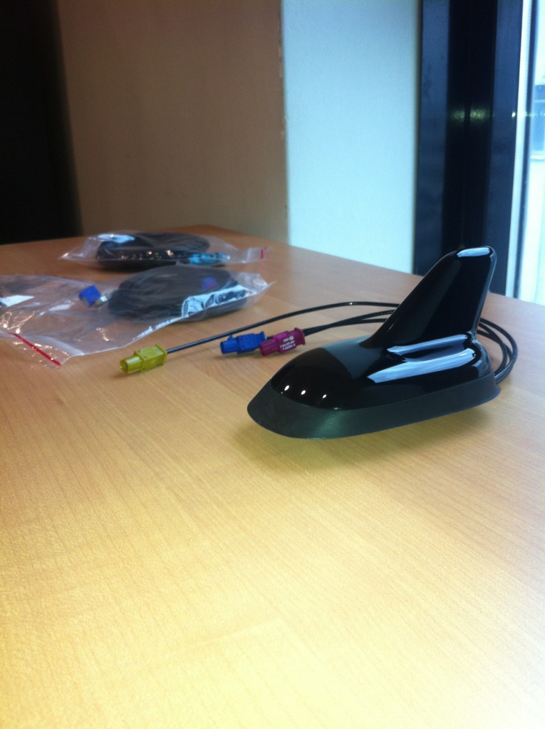

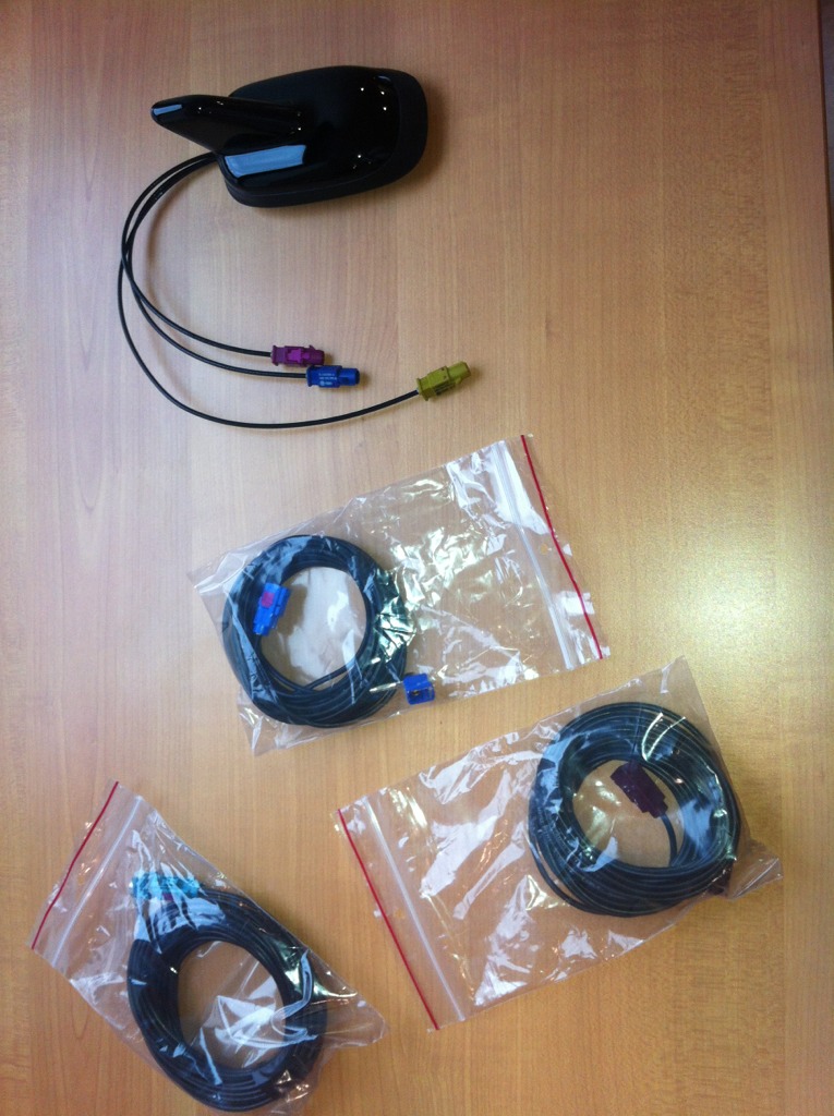

New mods for the snow white :-)
Price 59€
Specs with triple figure:
1) gsm/umts
2) gps
3) webasto
