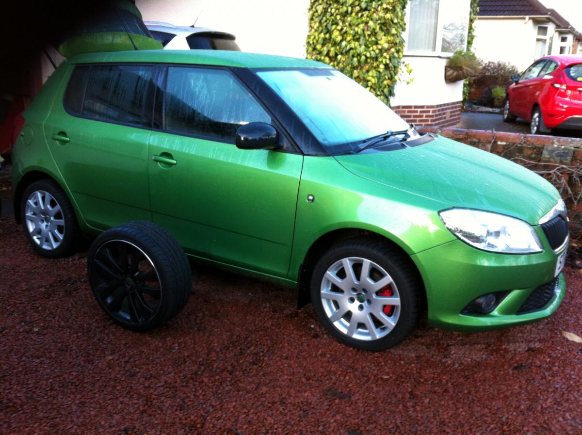

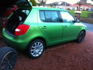

These could be going spare if you're interested, less tyres
16" Audi TT Comps
Those TT comps suit the Mk2 well.
Hi Brimma, how much and would you ship if I arrange a courier?
Mk1 vrs 16's on Mk2 vrs - straight swap over
