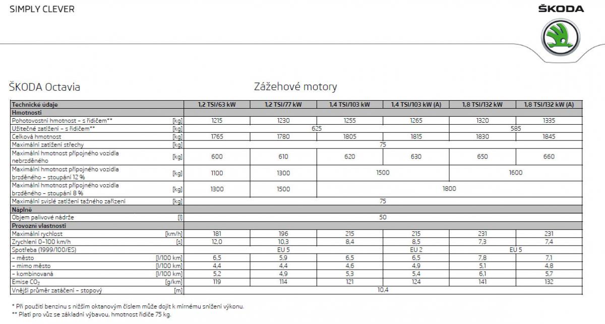

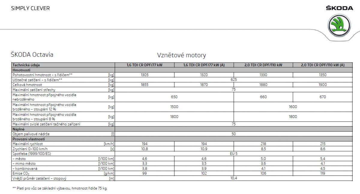

Hope you understand Czech :hi:
Thanks, it's easy to read without pulling out the google translate.
Specs are looking good to me :)
Unsure what the -12% etc means though?
That means the gradient you can pull away on 10% is a 1 in 10 hill in old money, so 12% is slightly steeper.
Ian
Looks like good towing specs then :)
