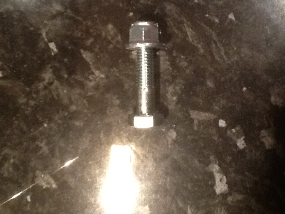

Cheers for all the help fitted the one pictured and seems to have stopped any play in the hole the bolt that I got was from a local supplier but just did not have the correct shoulder length but the one I took out was the same apart from the nut that did not have a washer on it I also got an exploded copy of the hub and other parts from the dealer and also a list of some part numbers would these be any help on here or could someone tell me where I could post them cheers

No I forgot but I only noticed the pinch bolt was wrong when I looked at the other side and saw one was different looking.So that was the reason for the pinch bolt.As the ball joint was lose in the hole on the hub so now I suspect that the hole on the hub is out of shape and this is the reason for a new hub sorry for the confusion.
Yes is possible, if the pinch bolt was loose the pin on the ball joint could have worn the hole oval.. I don't have a spare one to give you at the moment.
