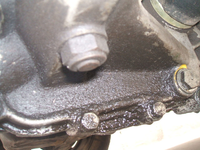

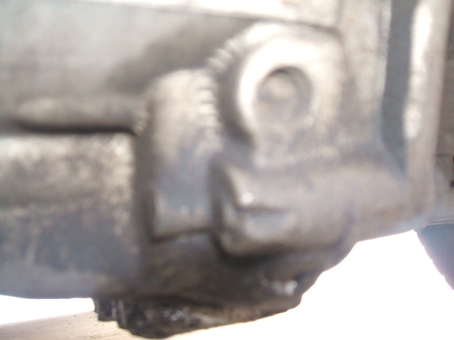

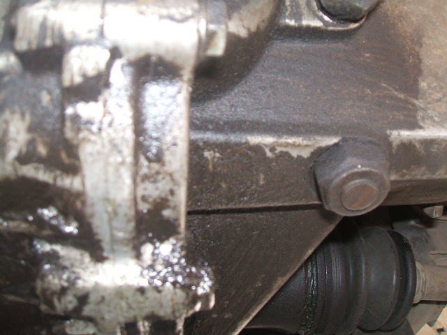

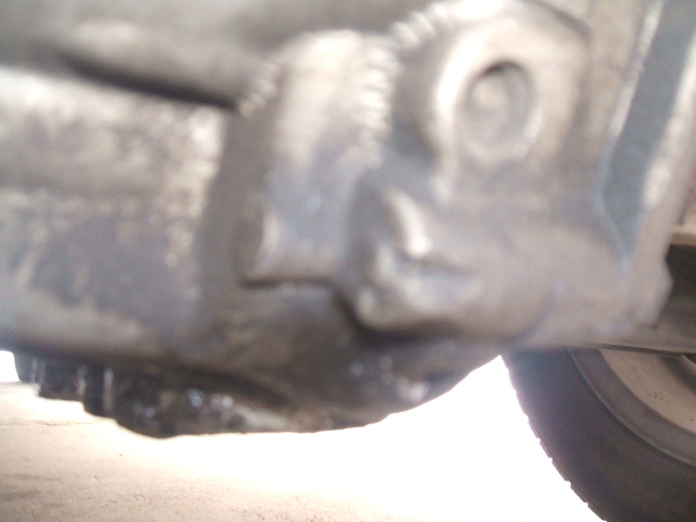

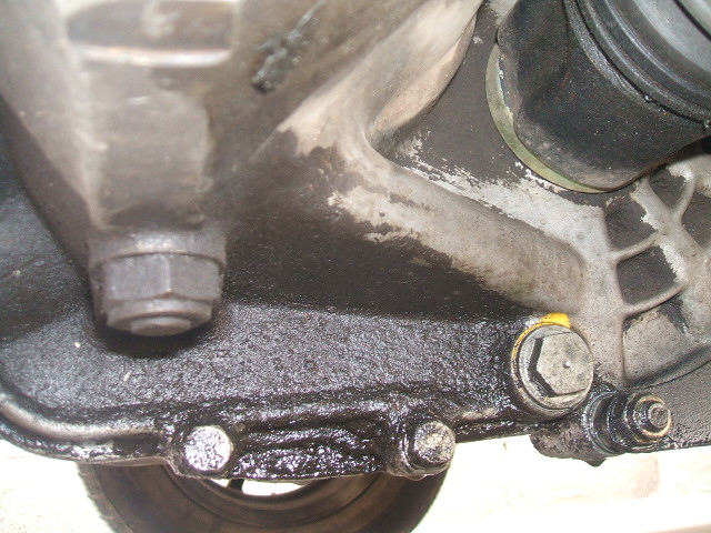

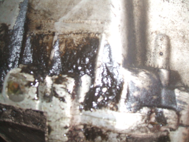

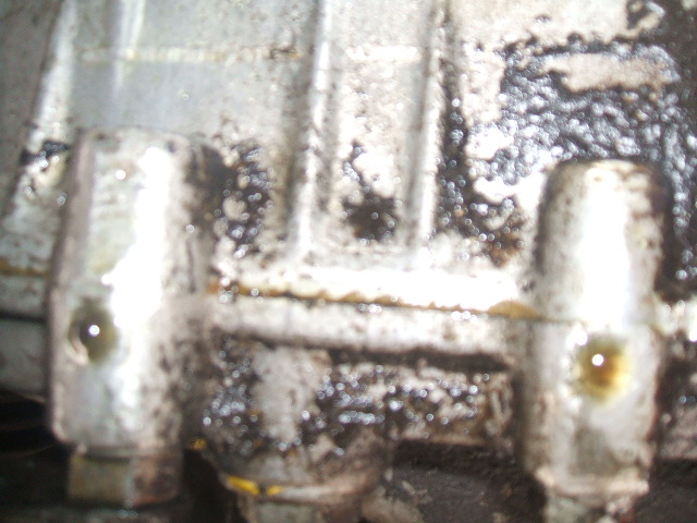

look like its been grounded out a few times looks to me like the gaskets gone
From the pictures you posted, can't tell if you have an oil leak, or it's just splashing from the road. Looks can be very deceptive.
If you really want to know, clean thoroughly the gearbox outside with gasoline and a small brush, then wipe with a clean rag.
Drive some 10 km (preferably on dry roads if you have at that altitude) and park the car on a clean spot for the night. If you have a small pool of oil under the car next morning, or gearbox is dirty from oil, then you have a leak. But I doubt it.

My yard is stained with oil drops. Every morning I see a small spot of fresh oil on the floor. A mechanic suggested me the same as adurer i.e. cleaning the gearbox surface and detecting from where the leakeage comes out. However it is a difficult task since the car is too low and there is a little space to maneuver. According to the mechanic I have to change the oil retainer seal or perhaps the gasket. But I am afraid I can't make it by myself. I will add some more oil trying to avoid a more serious damage. And that will be all. I want to be sure where I have to pour the oil. I want to show you some photos.

looks like your leak is from the joint between the casings due to the box being hit against the ground to many times (lowered car maybe?)
it distorts the casing and as there is no gasket just metal to metal it leaks.
you could try pinpunching the alloy either side of the join in a hope to seal it (I have used this method and it does work sometimes) otherwise its a strip and rebuild or second hand box.
Yes Sir the plastic cog is split but it still works, but now you make me wonder, perhaps should I change it or should it remain untill it breaks, which could be dangerous, fragments could go inside the gearbox, is that what you meant by your remark?
"the box being hit against the ground to many times" I think so too. The former owner hit the car for sure. Our street roads are full of potholes especially after a heavy rain. I will take my Felly to the mechanic to change the gearbox gasket. I could try pinpunching the alloy in an attempt to seal it but the car is too low, I don't have enough space to maneuver. I wish I could have an inspection pit in my own yard. I am saving some bucks to pay the mechanic.

Now on a technical level, just to see how 'annoying' I am: do yourself a favor and don't 'save bucks' for this gearbox issue. Your gearbox isn't leaking. I know what is your concern, you heard that rattling sound inside gearbox when the engine is cold and you THOUGHT it is from lack of oil. Then you looked under your car and saw something that LOOKS LIKE OIL. Well, that's not oil from your gearbox, it is a mixture of dirt, grease, rubber, water FROM THE ROAD. You live in an area where it is raining very often, so here's your water and dirt, and if you ask yourself where is that grease and oil coming from... well, it's from other trucks that do leak. Then you park your car in front of your house and all that oily slime splashed under your car is dripping from the lowest spots (such as gearbox) making you think you have a leak. If you don't believe me, pour 0.1 liter (100 ml) of engine oil on asphalt and let it spread over night. You'll get a spot the size of a car the next day! THAT'S A LEAK.
