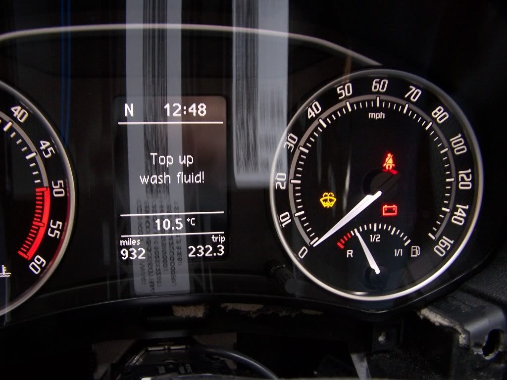

Just bought an S4 and it has this feature, came on 2 days ago. Promptly refilled and no dirty screen for me :)

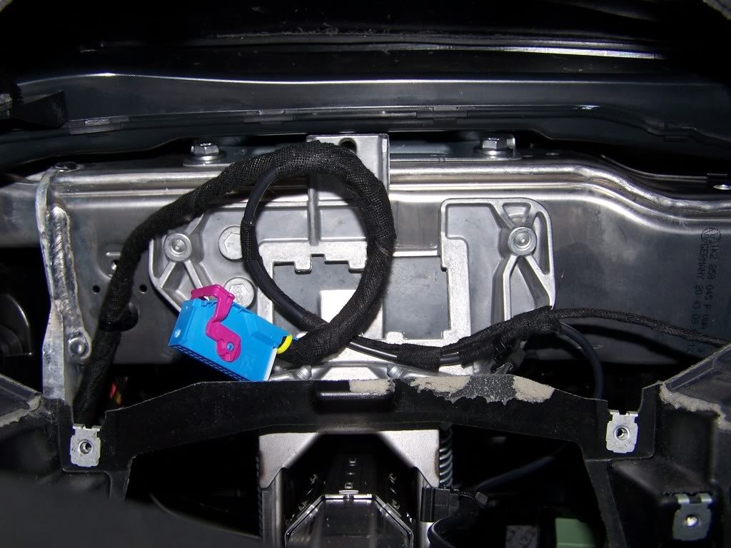

where do you run the wires to? Any more info much appreciated :)
I will update my first post with more info and pics soon :hi:

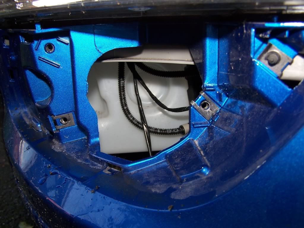

The washer bottle is the larger one, it has the slot for the Headlight washer pump (I would have fitted them too, if I didn't need a new bumper cover)

Could you please share the part number of the clip and to where do you run the wires to ?

I'm guessing the warning comes on when it is low and not empty? So when you get the warning it is low but still has a little in there?

it is around the quarter mark, so there is enough till you can top up again.
as I posted earlier the bottle is the large one
