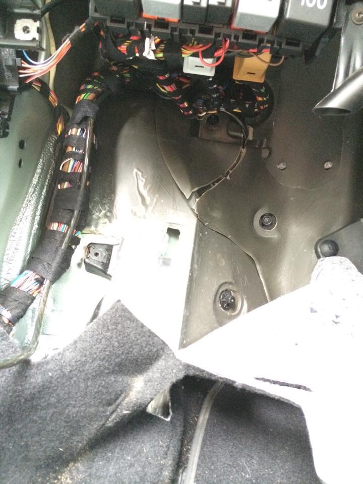

Did mine today using this guide, great mod, although you must have womens hand eddie, trying to cut/fit the sensor into the reservior was a giggle!
Were do you rute the cable from the engine bay to the instruments?
where the bonnet release cable passes through, this may be in a different place on a LHD car

Could anybody give me a rough location for the instrument cluster plug please?

it is behind the cluster
if you want the pin number location, look at my first post

Do you need to take out the cluster to get to it or is there an alternate route?
Many thanks.
Cluster will have to come out
Yep, cluster out, get a steel rule or similar to release the top clips, it's easy one you figure it out.
I ran the wires into cabin via the rubber seal for the bonnet release catch, released OS scuttle to get into it.

Got this picture from a Danish group.

Sorry I don't quite understand, do you pry the cluster from the front to release the clips?
I've had the dash apart before but never the instruments.
Edit: Just found another topic by Eddie that pretty much answers this
http://www.briskoda.net/forums/topic/277884-facelift-maxidot-fitted-today/
