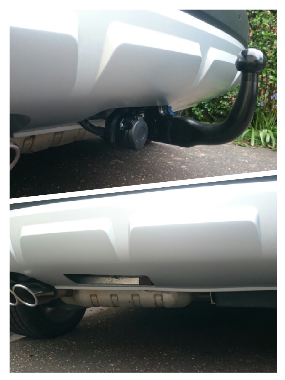

OK so started fitting my tow bar today, I've done the easy bit now I need to get the wiring from the back to the front of the car, I've got the trim all out of the boot and I'm trying to get the trim pieces off along the sill inside! whats the secret? I can't shift em.
Edit to add the price of the infill piece for the bumper is £30.30 and the part number is
5L6 807 499 AU34  I've gone with cutting a smaller hole as per the Witter Instructions and I'll see how this looks.
It's within the markings of the Skoda infill so I can always change it later
Edited by Yeti333
Just a couple of photos in case they are of any use for any body in the future.
The sill trims are removed vertically, the picture is inverted and shows the clips.
Not a job to under take lightly! swapping wires in the fuse box is one of the worst bits, there must be a special tool that does it easily but I really struggled.
And no where did it tell you to slide the purple part at the back to unlock it.
Nothing is really difficult, but when you're not familiar with how all the trims come apart it just take ages.
Now I just need to borrow VAG com from a friend and code it.
