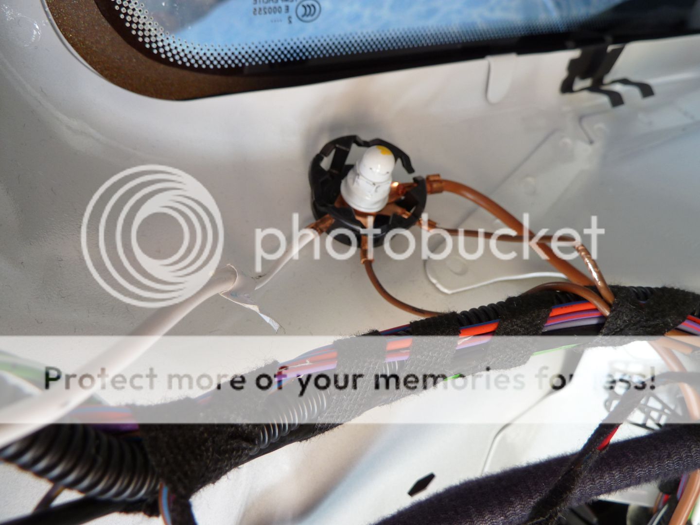

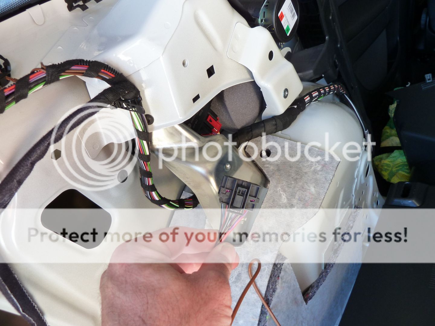

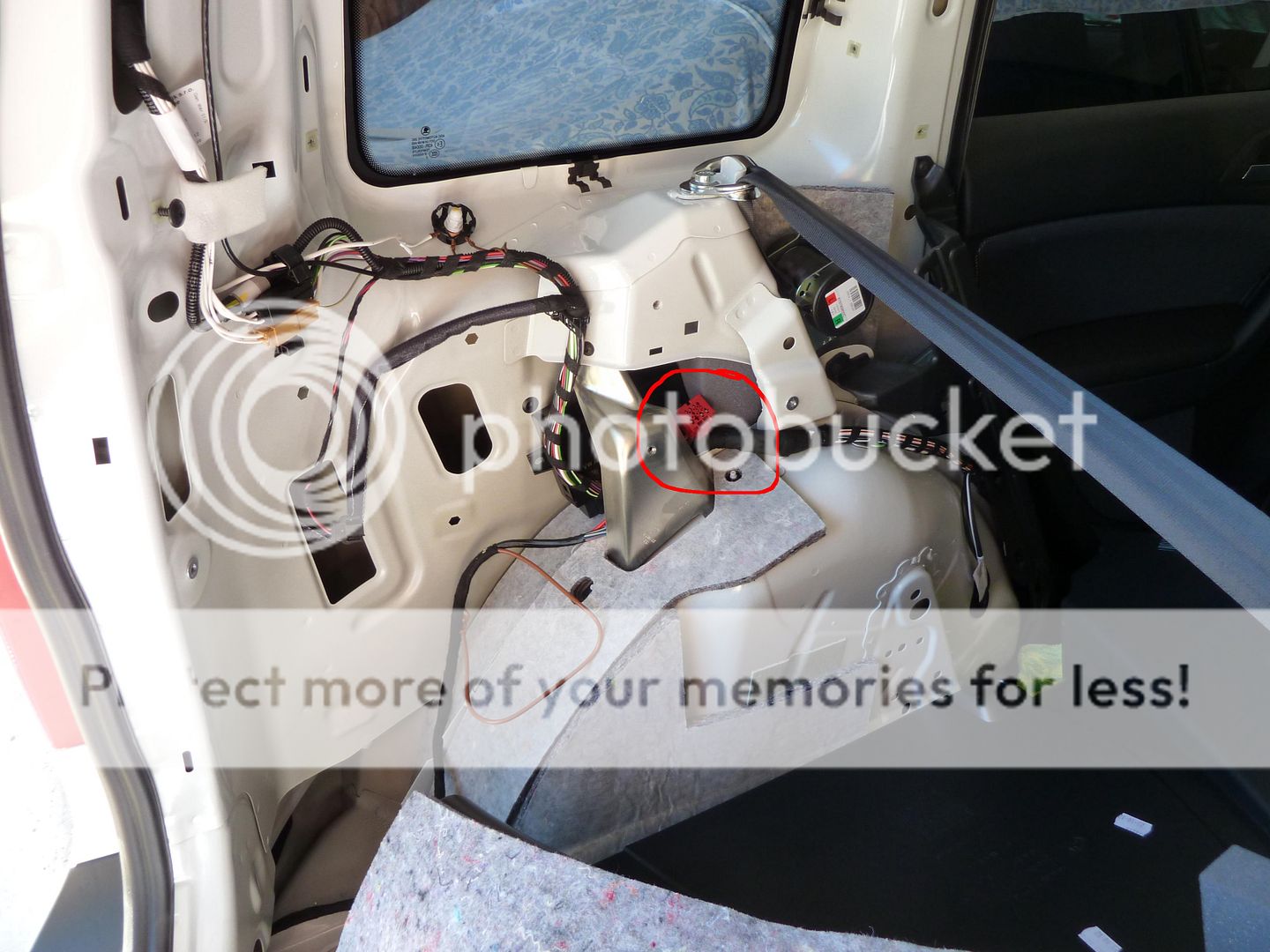

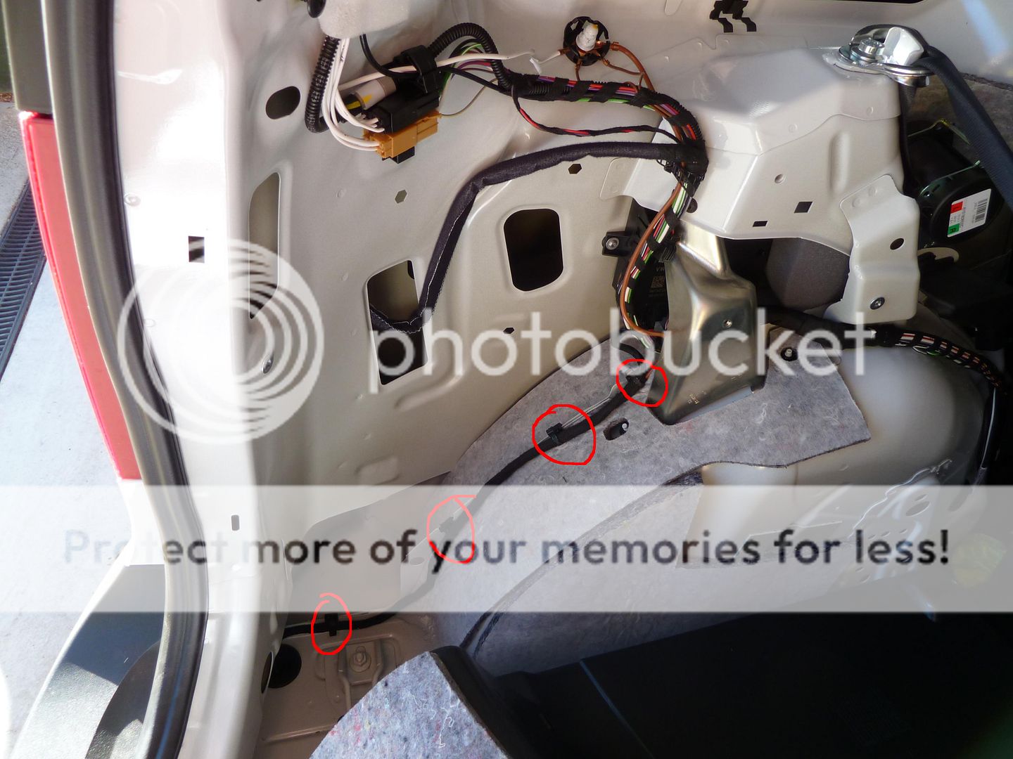

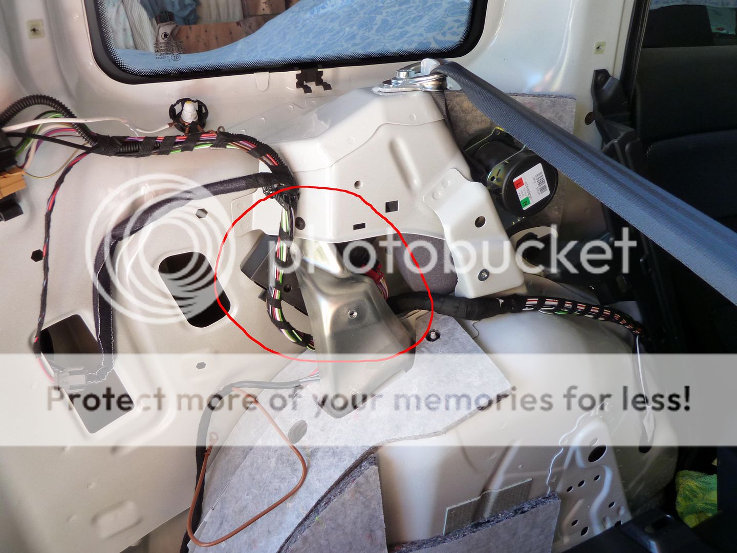

And one here:
And they are all here:

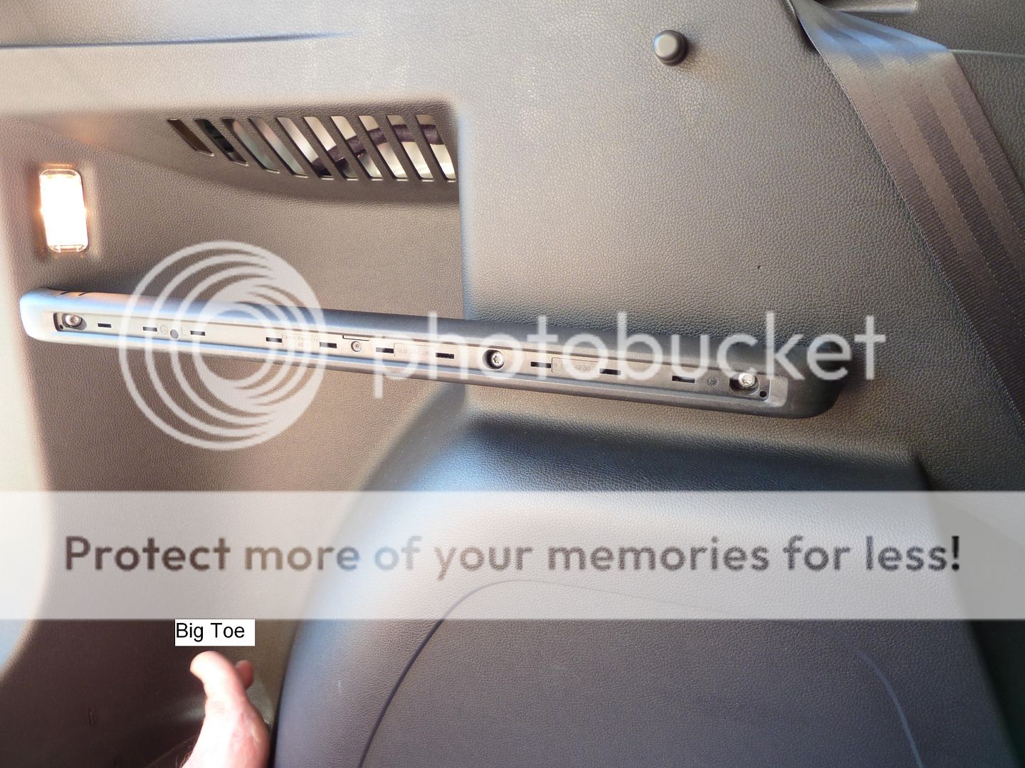

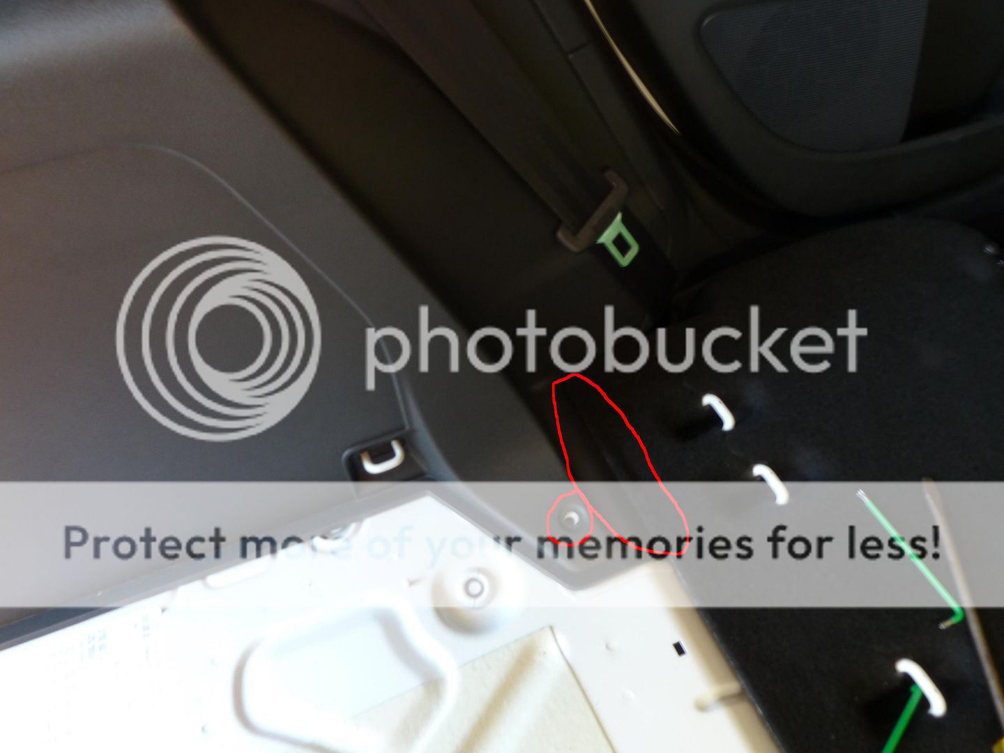

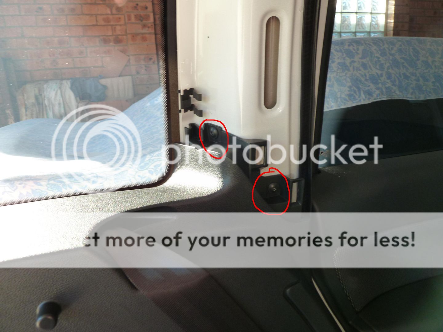

The hook rail has 3 screws:
Which are under this plastic strip:, I carefully lifted one end with a knife.

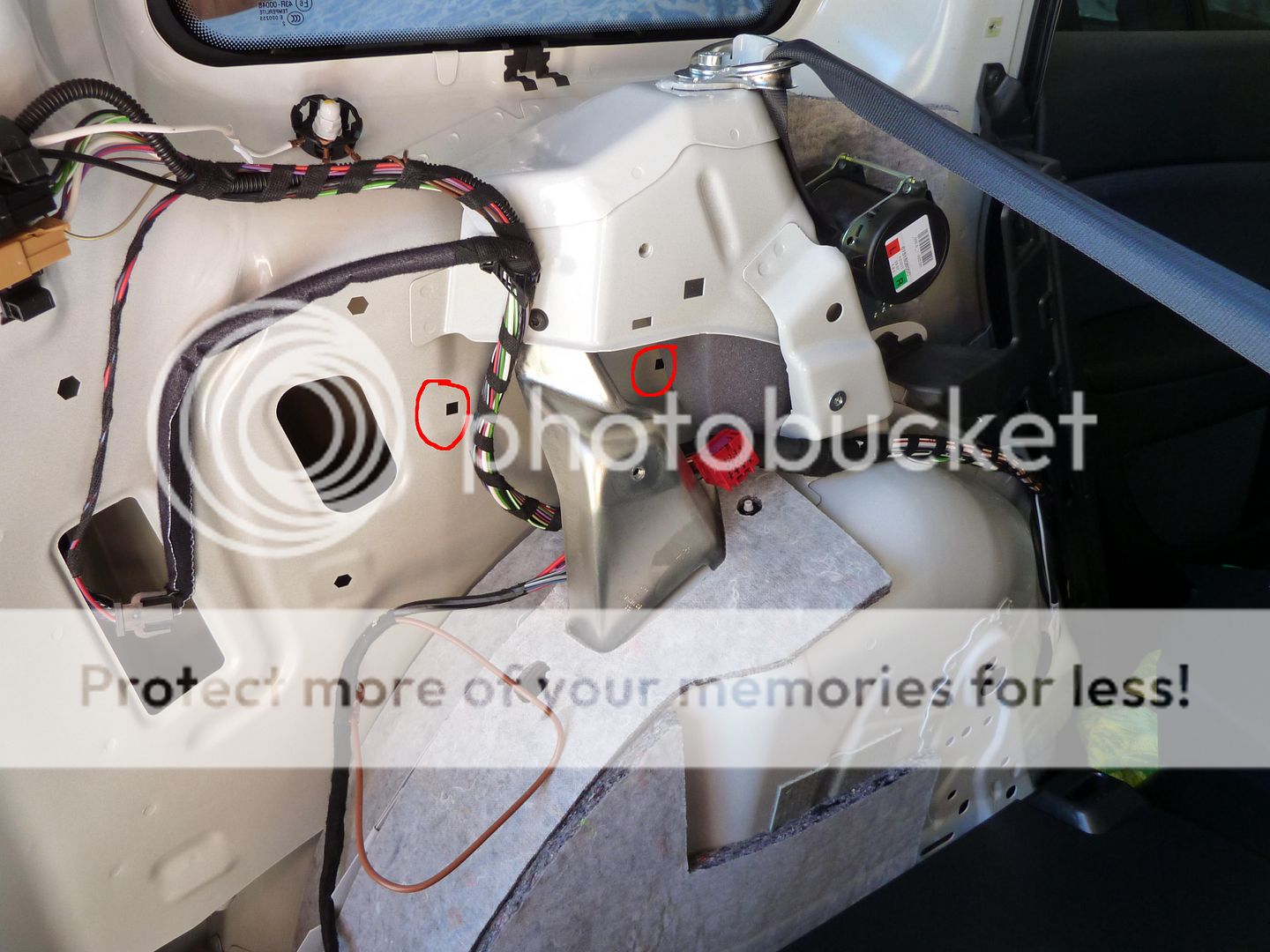

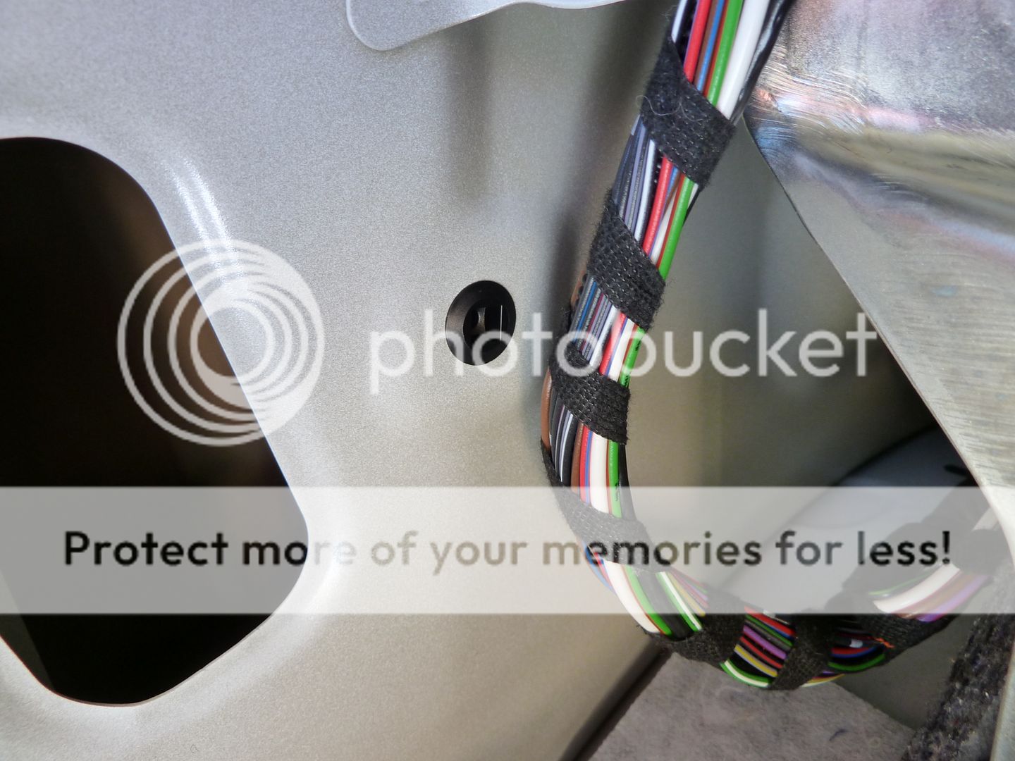

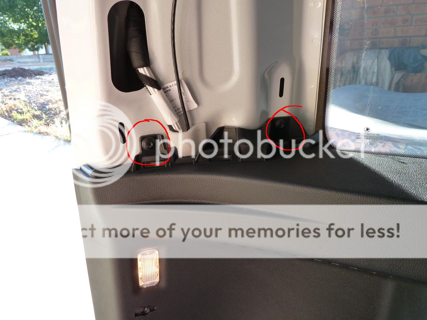

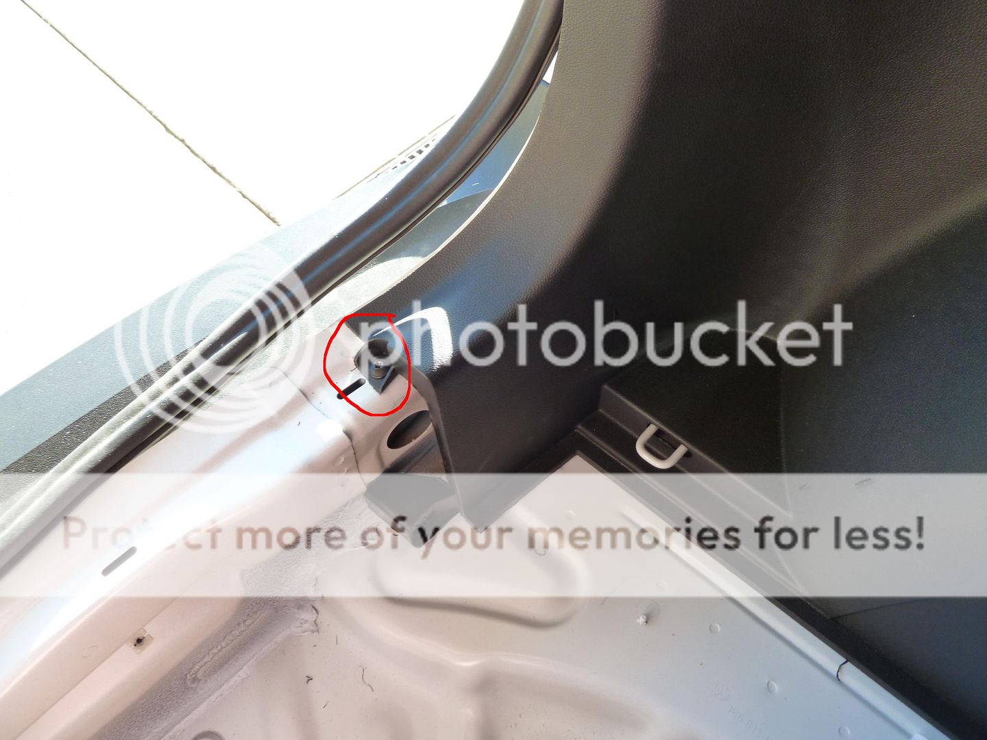

“C” Pillar cover has one screw at the top: There is no airbag under the little cover that says airbag. The airbag is under the roof lining.
The “C” Pillar cover slots in at the top and clips in at the bottom before the screw goes in:

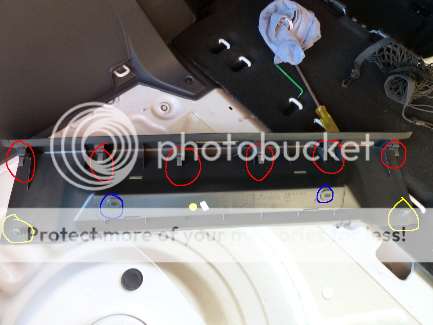

The rear center panel: Red clips go down before the yellow clips go in then 2 screws in the holes circled in blue.
Excellent! I'm a bit worried about th big toe though :hi:
Fred

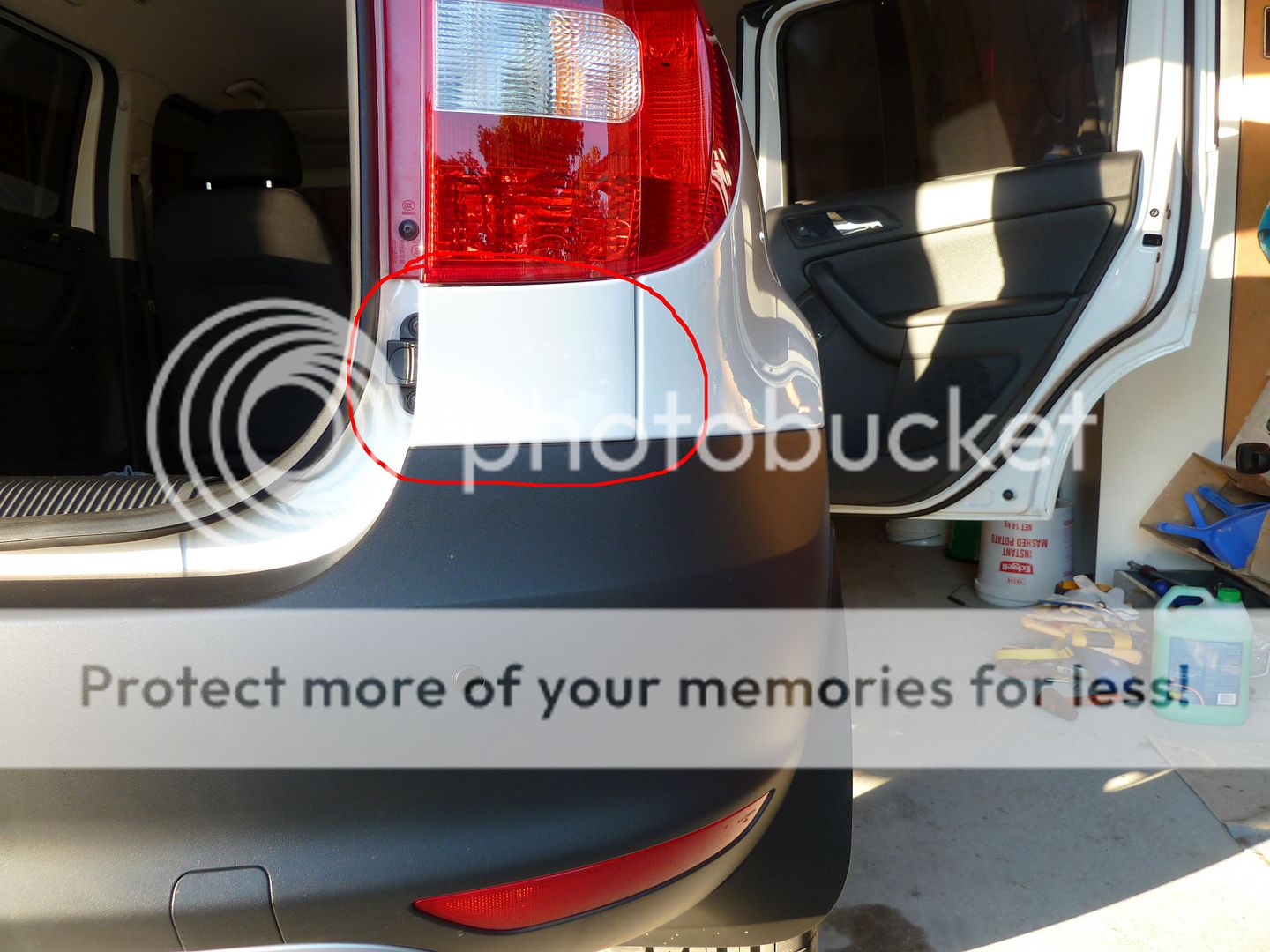

I didn't take any photos with the bumper off or how the actual tow bar was fitted. It’s really simple though. The bumper comes off by removing these covers:
Like this:
And then you can remove these nuts:
There are 4 plugs/clips under the bumper. 2 screws at the edges which join the bumper to the inner guard and that’s about it. The bumper is not much more than a cosmetic thing. There is nothing solid behind it, which is a good thing when someone bumps you in a car park. You might break a couple of clips but the plastic bumper should bounce back and since it’s not painted it shouldn’t show a scratch too bad.

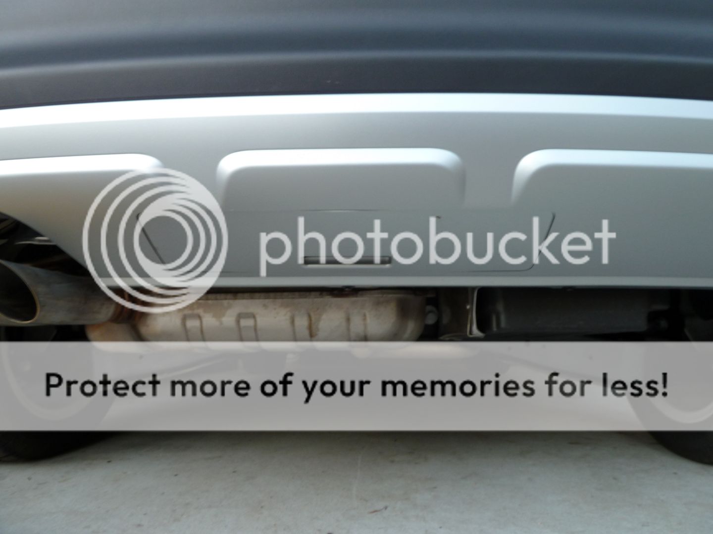

Here is the socket visible with the cover off:
And the cover on:
