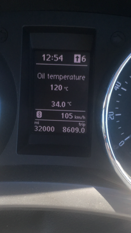

Living in a country with HOT :sun: :sweat: summers , temperatures up to 40 C and above, the highest oil temp I have encountered on my Yeti was 110 C.(2.0 TDI DSG) What do you think is the highest figure that I sould watch out from?
From recollection 115 deg C is the highest I've seen maybe a little higher on prolonged climbs on Alpine roads in the summer months with four POB. Generally the local Garrowby Hill climb will take the oil a couple of degrees past 100 in the winter with the lower grill winter cover fitted and a little more in summer without.
