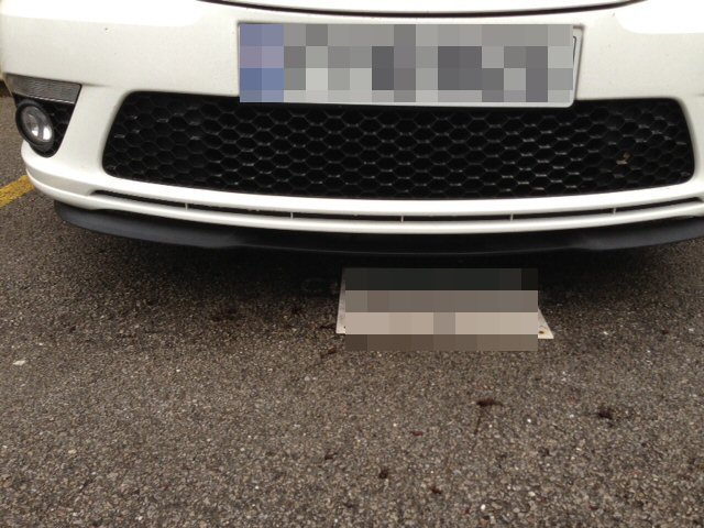

Yep its just the standard Leon Cupra R Splitter. Basically it has some mounting posts in the middle which fit the leon skirt which you need to cut down to make it a flat fit on the vRS skirt and then it's just a case of literally lining it up and screwing it onto the bottom of the skirt. I found the easiest way was to line it up on the front of the wheel arches with the help of a mate and then gaffer tape it onto the skirt at the ends, then get under the front and screw the middle screws in then go back and screw the ends in. All in all took about an hour including sawing down the posts. I'll get some pics and post them up

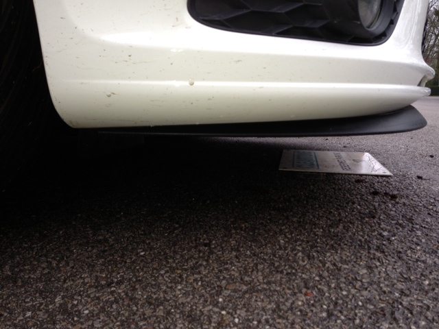

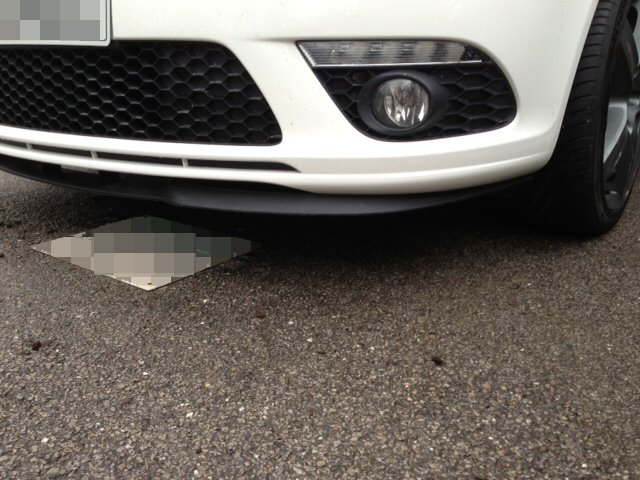

Not very good pics im afraid but you can get the idea:
In the second pic you can just about see the posts in the middle that have to be cut down to fit the vRS skirt

Im not sure the cupra splitter looks that suited to the octy...im thinkin the superskoda one looks a perfect fit tbh
Yeh looks too small.
Sorry but have to agree with the others, the FL has some decent splitters and front spoilers , this one cheapens the look of the car. Don't be too embarrased , just take it off quick , you will be forgiven :angel: .
