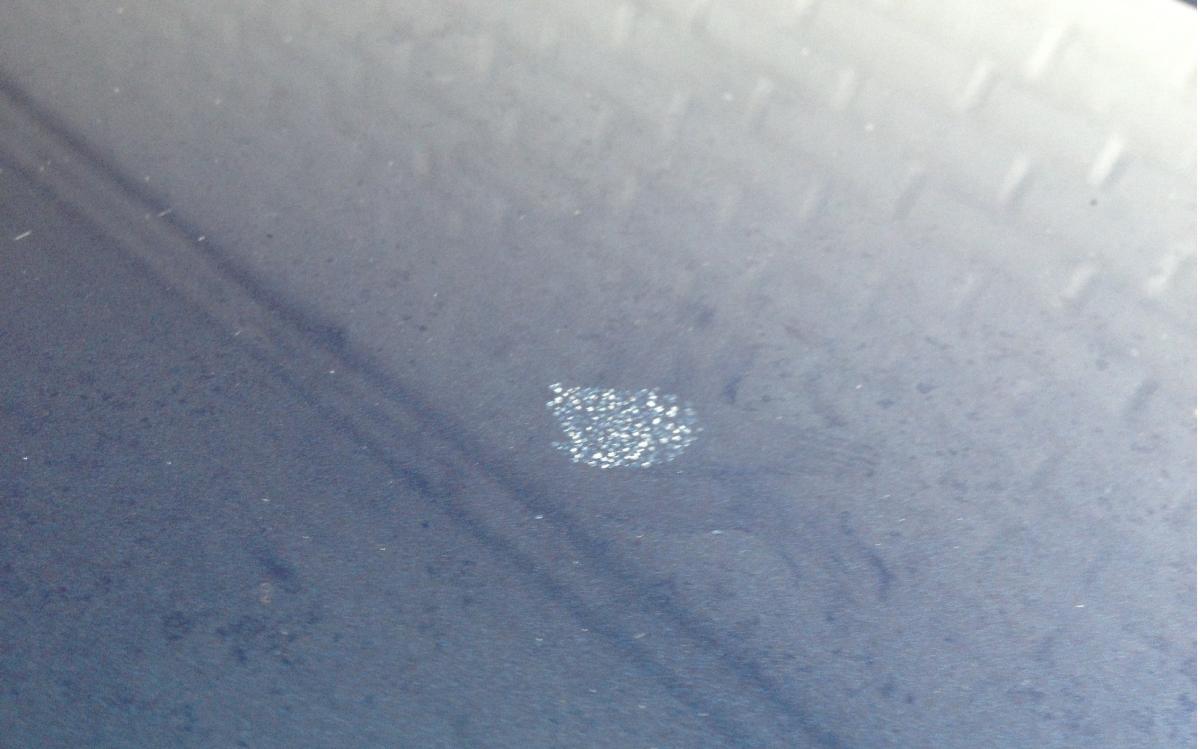

2 small scratches (pics included)... What should I do?
Hi all,I
noticed these two scratches on my boot this morning. Gutted!
I've already planned to give my car a full detail once the weather improves. (The snow is making it pointless right now) and I was going to wash, clay, swirl-X and auto glym resin polish.
Will this be satisfactory to protect the scratches or ahousl I use a touch up paint?

If you can get your fingernail in it, it will need spraying I'm afraid
If you cant it will Polish out with a Machine polisher (DA or Rotary)
get my fingernail in it? as in if I run my nail across it it catches?
What doe sa re-spray on a boot cost? (ballpark)
As youre in Germany. I have no idea
Here in the UK, I would recommend ChipsAway (Smart repair)
