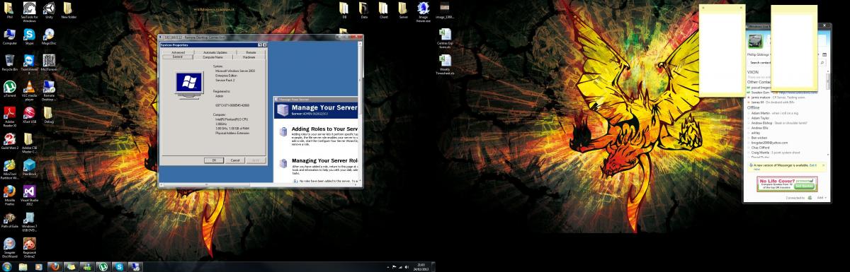

they are pentium D i think
this is the specs, i know ram is on the low side defo for virtual servers, so ill look into getting more for that say 8gb or summit per server only issue is that ram is pricey :(
