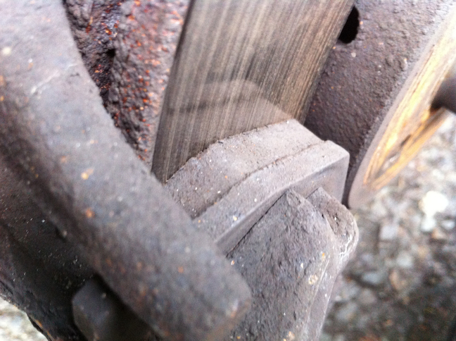

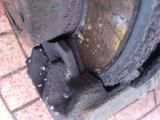

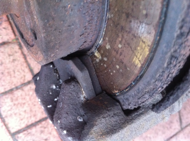

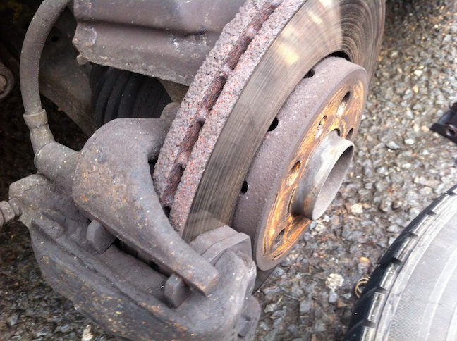

My brakes squeal a bit and have started making a rubbing sound now too. I've inspected the pads and they seem to be fine. Can anyone suggest any solution? Pictures attached.

It looks like the LH brake has not been working as well as the RH, they look as though they both could do with a clean up, I suggest unscrewing the Slide bolts, one at a time, clean them up and use a little white grease and re-install, when finished take the car out and use some heavy braking to bed and clean up the LH brake disc.

Strip an clean the lot, the last two pics seem to have a lip on the outer edge and marks that would suggest the pads have imprinted previously (lack of use/stood for a while?). Also the backs of the pads seem to be lacking copper slip.

..also, are the rear faces of the discs in good condition? No corrosion.

Also check to see how thick the discs are on the surface (not the rusted outer edge). Some times they'll wear below the limit but with new pads on it'll be hard to tell.

Remove the pads, measure the discs, that lip I mentioned looks large in the photo but corrosion can exaggerate the wear, also it doesn't look like you're getting the full contact patch on the last two pics. Clean the lot with brake cleaner, you'll probably have to wind the piston back slightly. Apply copper slip to the rear of the pads and refit.
