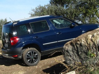

I have a Yeti 1.2DSG It was delivered on 225/50/17 Pirelli P Zero Rosso tyres. Quite often the wheels will spin when trying to make a quick getaway at a roundabout. Traction control kicks in and after a quick rise in my blood pressure the car takes off again. I have just moved to a new house where the driveway exits on to a 1in 4 hill. The road surface is concrete. The Yeti loses grip as you exit and traction control brings you to a stop. After reversing down the hill and centering the wheels I can restart with traction control OFF and can make it to the top of the hill with occasional wheelspin. With traction control on it is impossible to get up the hill if the road surface is damp. Is the Yeti the problem or is it the tyres?

Hi yeti-jeff. As the posters above have already said, this is likely to be a combination of the tyre type and size and the weight distribution of the 2WD yeti which I suspect is not as front biased as a typical hatchback. Once you are facing up a steep hill even more weight is shifted backwards. There is another factor too. The Yeti is fairly stiff in roll, so if the back of the car is on ground sloping sideways one way and the front is on ground sloping sideways the other way there is a strong tendency for two diagonal wheels to be "unweighted". This naturally increases the risk of the unweighted driven wheel spinning. Traction control will brake the spinning wheel in an attempt to divert more effort to the one with grip, but this may not be sufficient. If you had something really softly sprung like a 2CV then side to side weight transfer is minimal and traction would be better. You might be able to experiment with the exact line you take exiting your driveway. Dropping the tyre pressures to the minimum might help a little too.
Thanks Austin 7 for your input. I think that your reasonings are probably correct. The exit from the lower driveway (where the car shade is) is as you describe and can only be exited at fairly high speed after a run up. As you straighten up you lose all momentum due to wheel spin. You then have to reverse and straighten up and start again. In the dry you can set off (with ASR off) with only occasional spin, in the wet it is a different matter. My neighbours all drive Dacia's, Susuki's or Mitsubishi's. I am loath to take a big hit on the Yeti (its only 13 months old) but the only solution may be to trade in for one of the afore mentioned.
