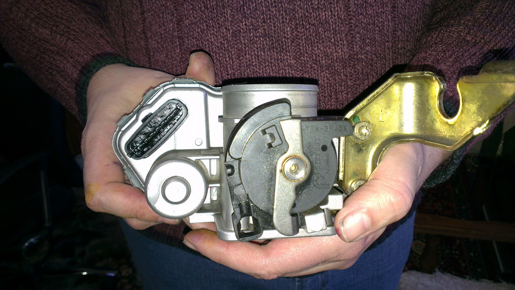

go there and told me today also I will go to a friend to measure throttle
Edited by adakt
friend I think find solution the side of metal lever that has spring was a little bit corroded!!! when I move the metal lever I had movement but not good like stuck.I spray with wd40 now the movement of the flat is much much smoother.
Thanks a lot
I like to ask you also.I will put now the old throttle body that I fix.If live the car without connect the battery poles,The switch the key to on postion the throttle will calibrated? do I will have problem with the ecu of the lpg ? or not thatnks
because I red somewhere in this forum to recalibrate the throttle body you can do the above procedure.

can you show me in this picture the directions of the pins, where is the start and where is the end. Also could you tell me where exactly to set my polymeter to get accurate readings?(2000k,200k,20k,2000 or 200?)
Look again on schematic showing how TB is connected to ECU. I painted each wire with the color existing on car. If you connect that 7-wires cable to TB socket, you'll be able to identify each pin number by its corresponding color wire.
About ohmmeter: use 200k position for measuring P1 and P2. If on display is shown 1, go up to 2000k. But if you see a value between 0 and 1, go down a notch at a time (20k, 2k) till you have a precise reading.
For motor resistance, start at 2k.
For MS, the ohmmeter has a special position for testing continuity, usually marked with a speaker symbol (beeps when there is continuity)
here the results of the measurements 20k pin 1,2 (1.01) 20k pin 6,7 (0.02 ) pin 3,4(2.32) pin 5,6(1) in 5,6 the value oone doesntt change at all
what do you think?

- pins 1-2: motor resistance looks ok
- pins 3-4 (microswitch) must show 0 (zero) when clicked, and nothing when not clicked
- pins 5-6 and 6-7: I don't know what is the resistance of P1 and P2, but it is more important that when you rotate the throttle flap, the measured resistance varies smoothly without any interruption.

friend everrything ok 3,4 zero as you said what do next also 5,6 as you said uniform readings
You need to do a TB operational test on car. Here is what to do:
- replace TB on car with TB we test. Leave cover open for now
- plug 7-pin plug to TB we test.
- you need somebody else to put key contact ON while you watch TB. Here is what should happen in 10 seconds: ECU will command TB and will rotate it to Minim, Maxim, then in 3 intermediary positions, and then will rest prepared to idle position. Listen carefully! You have to hear the click of MS.
- key contact OFF
If all goes well, start the engine.
i went a friend mechanic.I explain him what we have done i put that we test it .Now the car works perfect.The idle speed perfect.Very a few issues because ecu has the old valuesof the throttle.I think they willdisapeard.I will open that had problem to see what happend many people i think will interested.Really thanks i will wait
