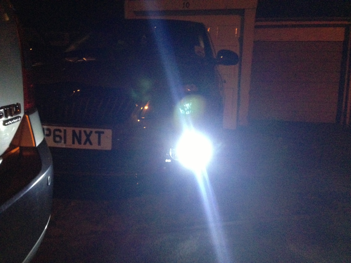

Just went out and took this.... Not CANBUS bulbs, no load resistors, no errors! £4:50 inc delivery.

I got it to work this time I think?!?!
You did:). Serious amount of light!

I didn't do a guide like that just explained how to fit them but I those are 15 led ones that look like the ones above but aren't CANBUS so a lot cheaper. Got a day time pic if it'll upload..... Files too big lol!
.... Sorry they're 18 led not 15.... Maths was never my strong point lol!

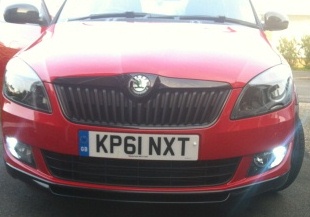

Try this pic, I'vecropped it to fit:post-97861-0-78014600-1366053444_thumb.jpg
Looks good more like drl's than standard bulbs think ill b getting some of them cheers oh and u sure u have to cut the wires? Thought the pins was opposite? And LEDs only work 1 way so turn bulb round lol ????
