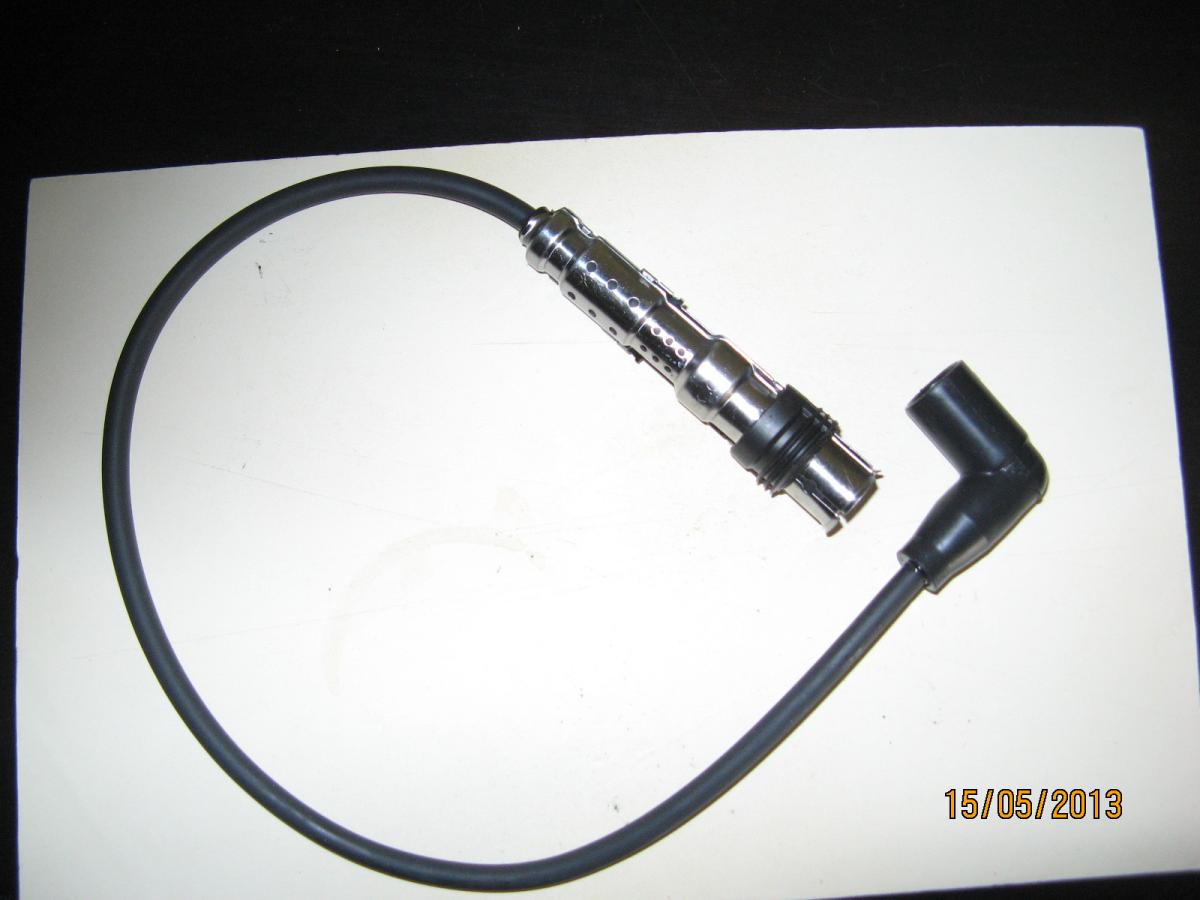

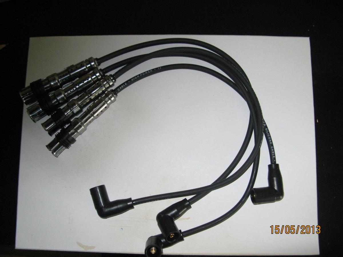

New HT leads arrived as promised. They look almost identical to VW/Skoda originals. Made by "Tesla" in Chech Republi. Probably significant! Just hope they are made to higher spec. However, at well under £40 the set I consider it cheap peace of mind insurance. We are driving from Lancashire to Gatwick next week, And intend to catch our plane. Roadside replacement may be tricky, particularly NO 4, but not insupperable.
As for the other worry of "limp mode", Surely this is as result of faulty lead. Replace that, and limping ends. Fault code will remain unseen in computer memory and can be reset anytime. If I'm wrong I'm sure someone out there will tell us
I attach two photos of new leads.
Thanks for the pics - those leads don't appear to have any of the additional 'mouse protection' though?

Quite right Weaver, No anti nibble protection!
