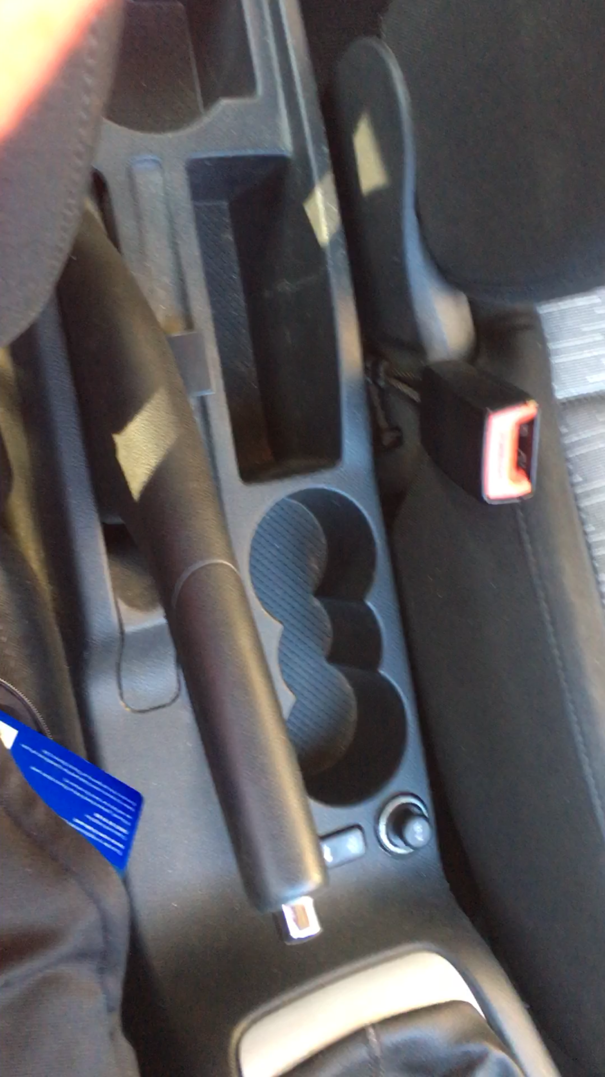

Can anyone help me ??
I have a Skoda octavia estate 2011
And I can’t find the aux cord anywhere
people are saying that it’s in the center console
but it’s not there . I’ve uploaded a picture of the centre console
and I also have a bolero mp3 radio system
and on the radio Bluetooth doesn’t connect and when I press the media button it says no medium available
plzzz someone help
At a guess, you might not have an AUX port or BT fitted :)
The aux port came as part of the "jumbo box" (the armrest with the storage inside) and was under the armrest.
So you don't have an aux socket.
Bluetooth also wasn't standard. It requires an additional Bluetooth module.
