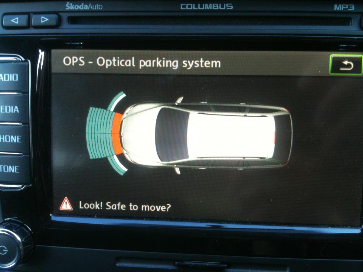

The main use of the graphics on the Columbus is to tell you which sensor is bleeping. Its very good for refining parking or checking an unexpected bleep. I thought it was a gimic until I used it in a hire car and realised how useful it is in tighter spaces once you are halfway in.
I also agree you should be looking behind you in the main, but quick glances to the display are also very helpful in the same way as glancing to the mirrors.

Wait, the Stream shows a display when you're reversing?
Stream MP3 Rear sensors active:
Columbus front sensors active:
No comparison.
Except the beeps, which are exactly the same...
