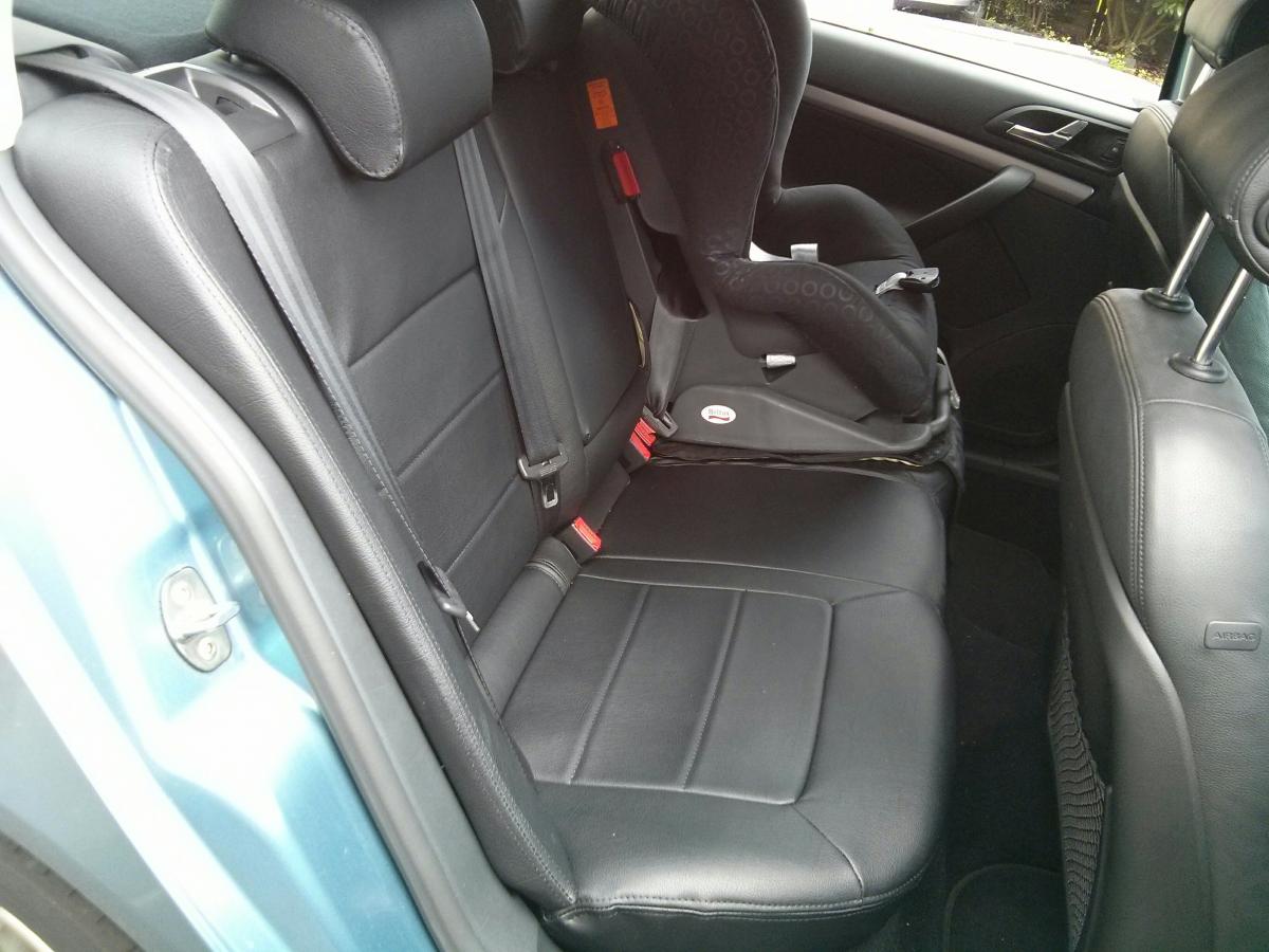

I've recently received tailored seat covers for the rear to complement my black leather A6 fronts and I think they match in well. You need the bench dismantled, two people and an evening of swearing to fit them but I think it's worth it. I wanted leather to match originally but it is so difficult to know what can be made to fit unless you've got VAG breakers locally you can go and inspect lots of seats in person.

Sure, they are from www.jcseatcovers.co.uk, it was about £200 all in for the back seats. Armrest still opens but doesn't split open with a 'lid' anymore, but split folding, ISOFIX zips etc all still function as before.
If you or anyone else fancies these to try to match up with some existing leather fronts don't just order based on the website colour chart standard 'black'. I specifically asked about matching leather grain size and colour and they had a few different black and anthracite samples sent out for me to choose from.
