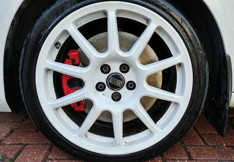

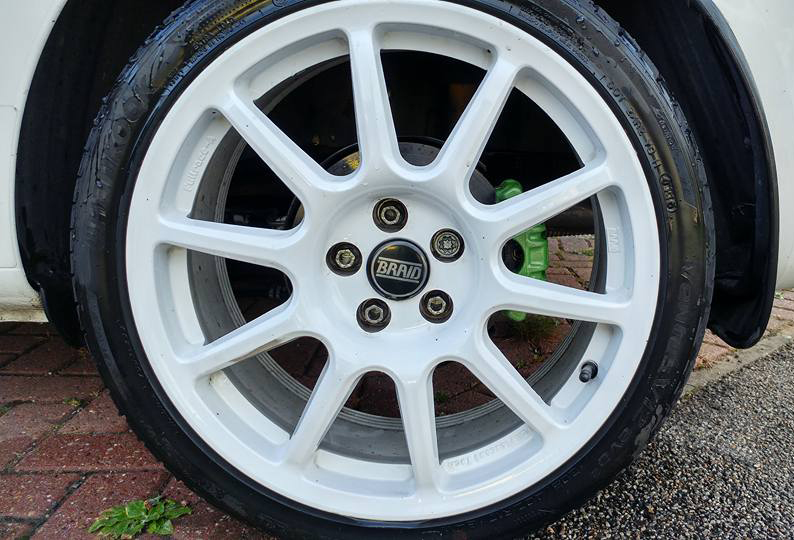

Finally managed to get the car in for the disc rear axle to be fitted, so thought I might as well get the 312 front upgrade done at the same time
Painted the rear calipers green, then bought red fronts, just to be a bit different, and to mirror the vRS badging
Very happy :)

How are you finding the brake upgrade all round? its on my to do list also, more so with the remap coming.
I dont see the appeal of the different colour calipers mind... but each to their own!
Exactly, wouldn't life be boring if everyone copied everyone else's mods?
my 312mm upgrade was a vast improvement over the standard, best mechanical mod to date.

A few more pics since the 312 front upgrade and disc rear axle going on
Have to say I'm very impressed by the brake performance
