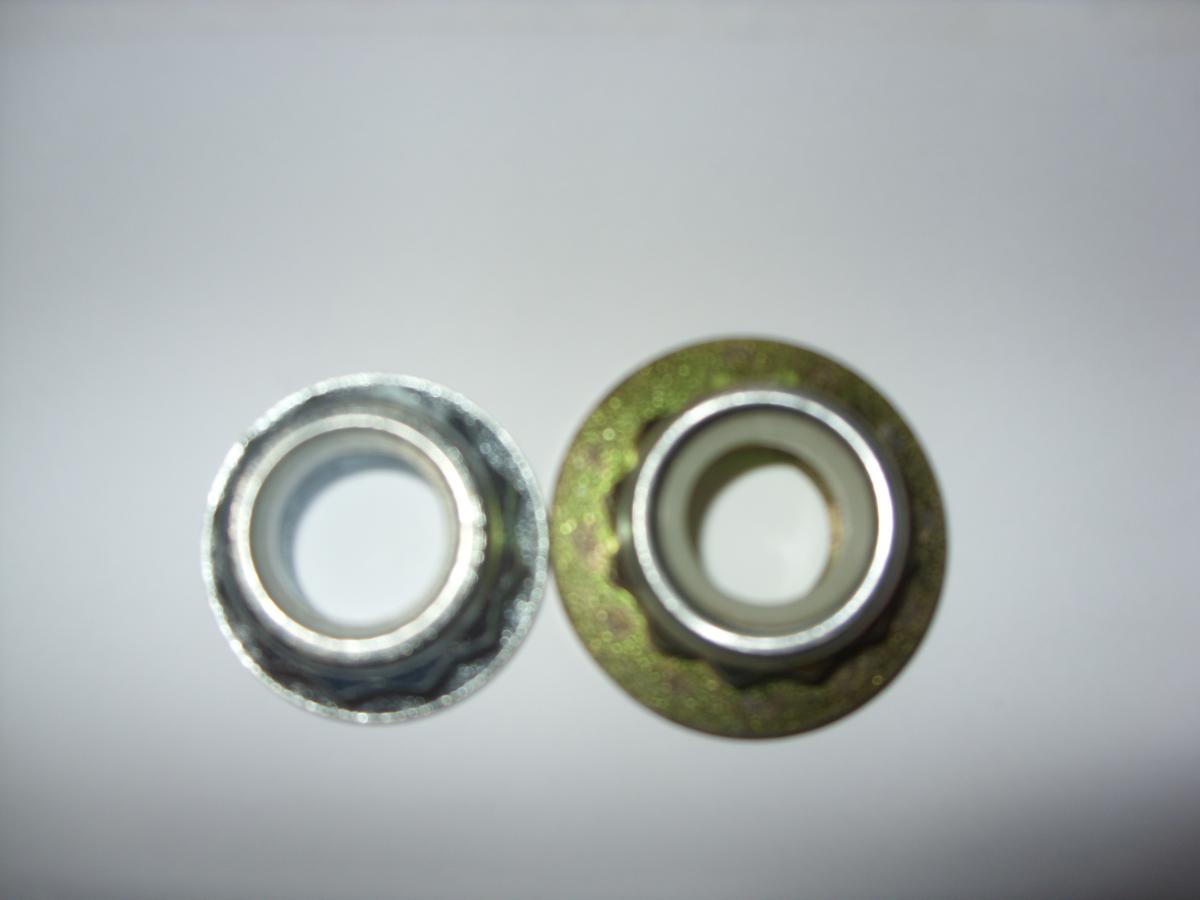

Can you take a photo of your hub nut please.
Oo er missus.
Sent from my Nexus 4 using Tapatalk 4 Beta
As requested 36mm Front Hub Nut...Picture attached....
Rear Hub nuts (two different sizes).
Maybe I've got this wrong, I'm thinking that Tech 1e knows exactly what these hub nuts look like, even in his sleep, what he would be asking for was "show us a picture of the hub nut on that car - the every one that is causing problems"!
Yes, I wanted to see if there was anything untoward with the hub/nut.

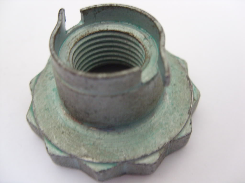

Hello All,
Today when I changed my wheels to winter tyres, I disscovered to my surprise that the 12 point (36mm) hub nut was lying loose inside the hubcap.
The nut is hollow and there is a thread on the inside
Now when I look at the other side of the car, I see that the central part of the nut is filled.
However I cant find the part which goes inside the nut.
I have the suitabel 36mm nut and can put everything back together temprarily (and get a new nut from the dealer) however, where or what is missing in the centre of that nut and where is that part ?
It cant have fallen out since the hubcap on the alloys kept the big 36mm safely captured.
Any suggestions??
Regards
Robert
