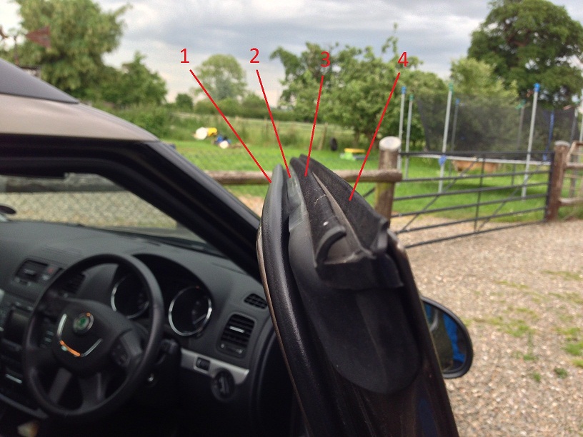

OK. Heres a picture of my door.
I have applied plenty of GP onto the main seal '1' but still creaking.
I then applied some between seal '1' and '2' thinking it was this 'lip' rubbing against '1' when the door is closed. Still no joy.
Now I'm tempted to apply some GP onto the felt seals '3' and '4'. However I'm hesitant as these are felty rather than rubber. Before I do this can anyone offer any advice on wheer they applied the GP to fix the creaks, or the location of the secret channel where the waxy deposits collect (no, not my ears :) )
OK - I also applied mine to the seal in the 'body' of the car and also inside the seal as it folded.
