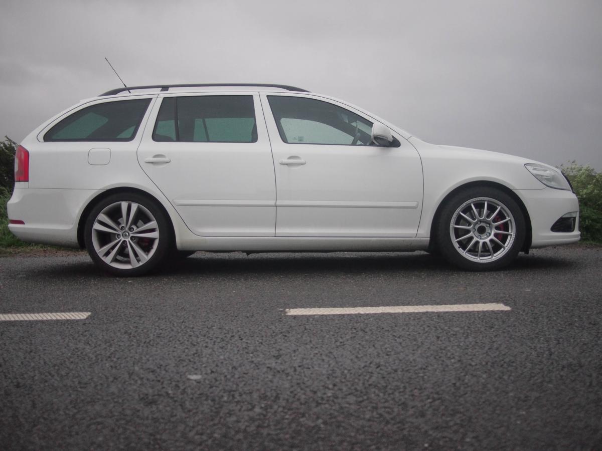

Mounted the fronts up.
One of the wheels was the wrong PCD but being sorted by Team Dynamics, so hopefully will be a full set very soon.
What do you guys think? Feel free to flame away :think:
I'll content myself with the fact that I saved almost 4kg per wheel.
Dave

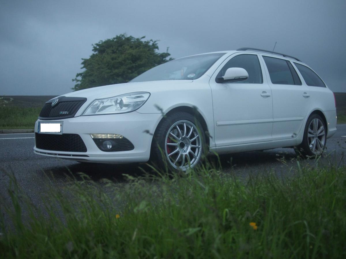

And one more: already growing on me!
Edited by davew255

Looks good :)
That's a vote from me.
I think they look good. Suit the car in that colour too - anything other than the standard silver finish and I don't think the result would be as good.
