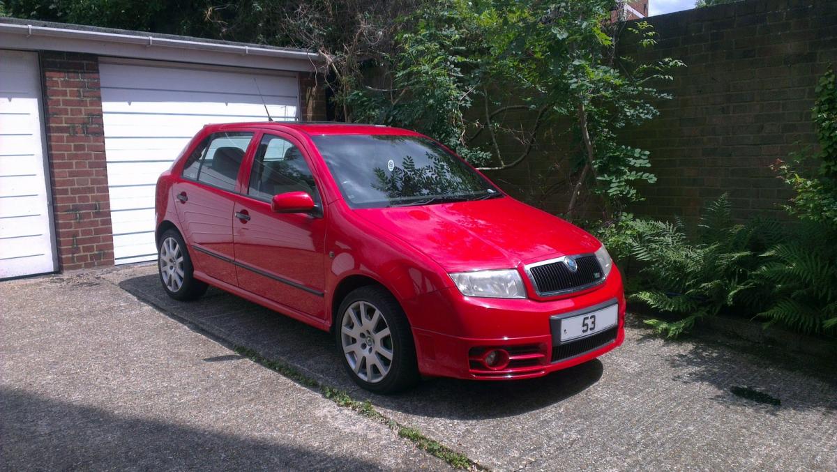

She only has 110,000 on the clock and in really nice condition. Getting a full wash, cleanse, clay and wax this afternoon so the red paint should be gleaming by tonight ;)

Cheer's guys, looking forward to your insight! cheeky pic never goes a miss....post-56167-0-19376600-1372672678_thumb.jpg
