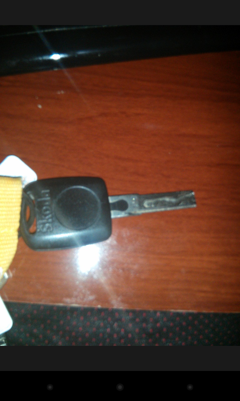

I would like to know how many types of keys are for the Skoda Fabia 2006, I have one (used) and the preview owner only had one key, this is a standar hey i does not have anything in special, I have seen others skoda Fabia Owners and they have different keys, there is one that is called flip key (very awesome, I would like one of those), there is another that has two buttons and then there is mine I will attach a picture of it.

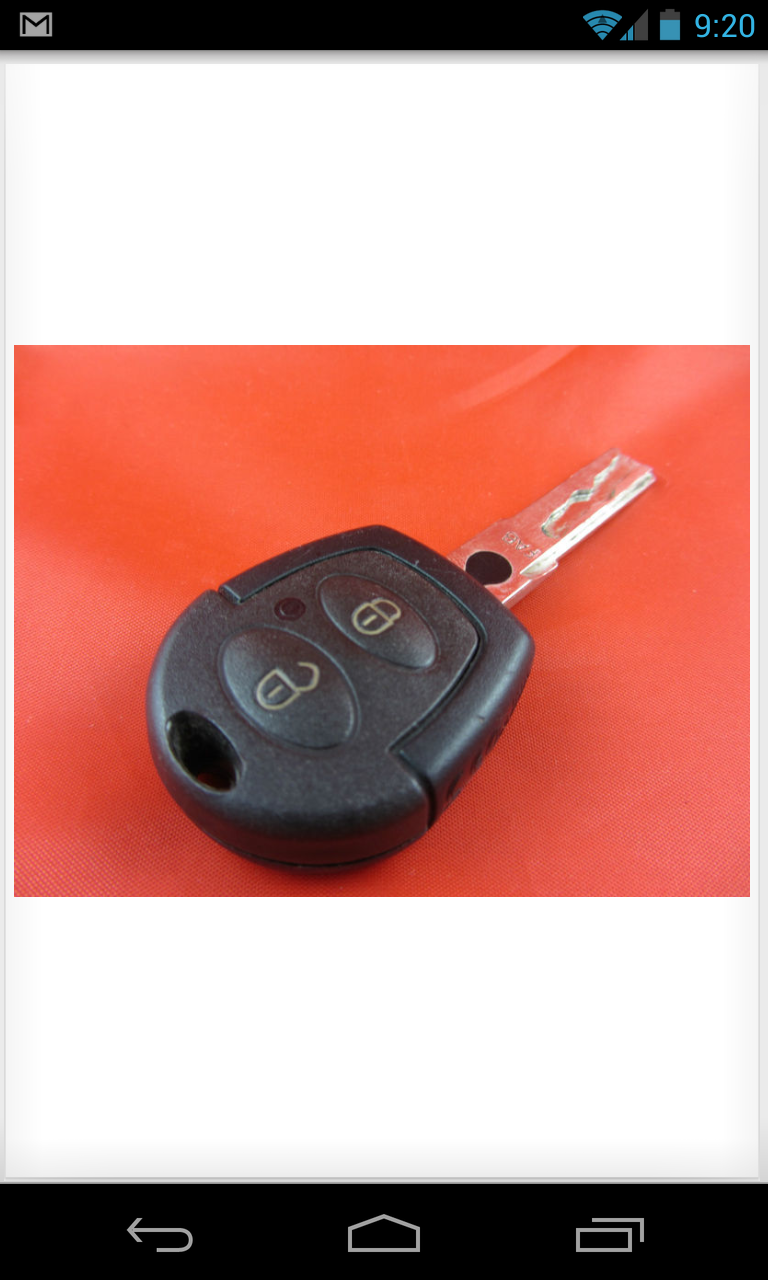

This is one of the keys that I´ve seen online
and this is the one that I have

I believe that lesser models which came with remote central locking got non-flip remote keys (as i previously had with my 2002 Seat Ibiza)

I can but imagine that your car is either on the next step down and has no central locking?
so you only get an old school twisty key

Or it could be that you car started life with the remote one as the main key which got lost so the owner reverted to the spare non-remote key which is now all you have.
As you say you should be able to get a new key cut a matching blade and it will open the doors but will need to get the immobiliser chip is programmed to match to make sure that it will actually start the car.
This i believe is an expensive process which can only be done at a dealer.
what KenONeill mentions about being able to sync a new key to the immob if you have 1 working key is incorrect. You can sync a new remote using the manual methoud but the immob part of the key, AKA transponder has to be programmed diagnostically using the SKC(pin code)
Don't go to Skoda unless you like paying more than you should. There'll be somebody else that can do it cheaper & will come to you. I do car keys for a living & i'm usually about half the price of what dealers charge local customers. If I have to travel a bit further the price goes up but i can generally still beat dealers
