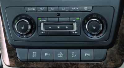

take a picture of your controls.  My Yeti is a 2011 MY12 build my controls look like this.
Mine are the same, only I have not got seats heating.
I've turned on the recirc button when I posted before, and I've just check it and still on... :drunk:
I'll check it tomorrow and I'll tell you if still work... Maybe it would be related with other setting (turning off the climate, open the roof, or something like that).
Thank you again James. I'll be back with updates...
Climate fascia is the same as mine - I do however have somewhat less "buttons" than your car - just ASR for me!!
that is a generic picture, I too only have ASR and off road button.
Not even an "off road button" for me - just a set of steelies, 2WD and a set of winter tyres!!
