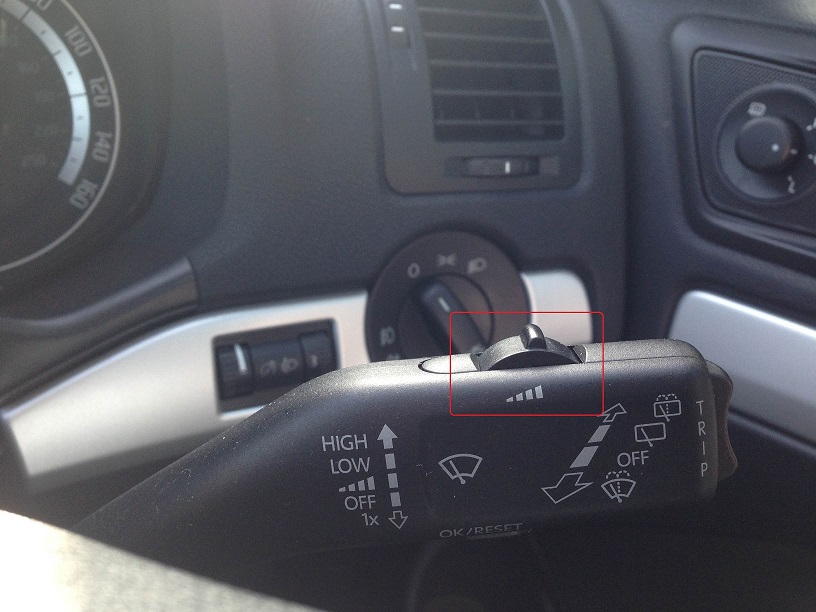

Secondly, see attached the picture 'WindWiper.jpg'
The intermittent switch which allows me to change speed of my Wiper when on intermittent mode has stopped working.  No matter what setting I put it to, the wiper goes at it's own speed... either very often, or... very slowly.
Has anybody else experienced this problem?, if so... did you buy a whole new stalk?

You will probably find that the stalk needs taking apart and cleaning on the contacts. Search for a tutorial on cleaning the cruise control switch and it's basically the same.
One way to check its operation is with VCDS as it is possible to read the various states of the switch and identify if it is indeed the switch or a problem elsewhere.

Your sure you don't have rain sensitive wipers? If so moving the stalk to its first position sets them to rain sensitive, when in this position the switch I think alters the sensitivity.
This would explain the different speeds your wipers are moving at.
A truck goes past flinging water on your widescreen and the wipers go really fast. A constant drizzle and they move more slowly. They can be a bit random at times but on the whole I think they're brilliant.
Move the stalk a second notch it's a constant wipe, third notch constant but faster.
