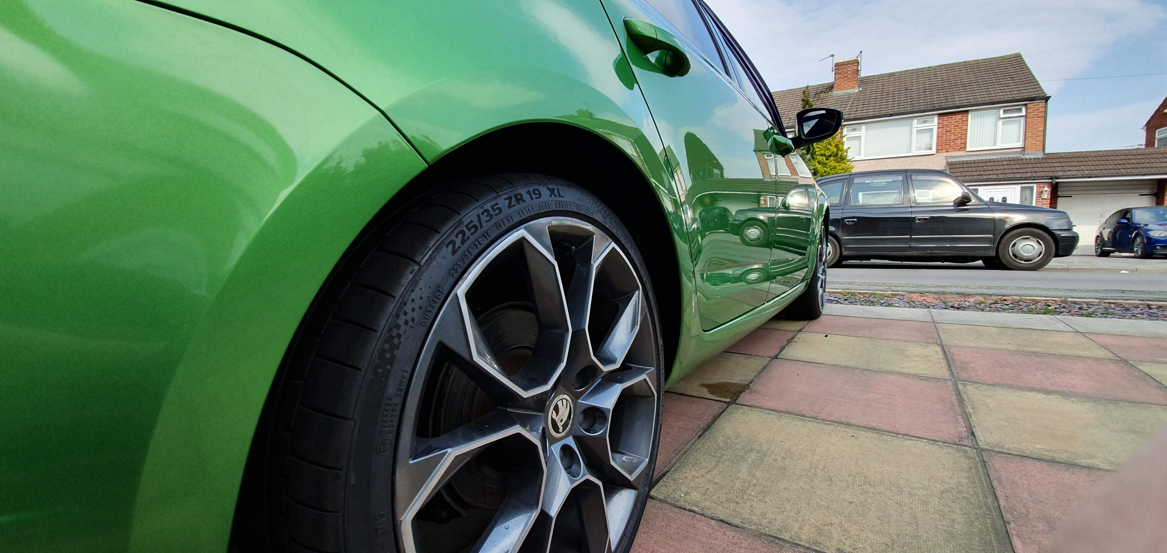

Been mulling over hundreds of designs since getting my ralley green vRS. Decided this week to get some GMP Italia's in anthracite. Once fitted... I love them. 19" 225/35/19ZR (Dunlop SportMaxx RT2) 8.5j 5x112 -
