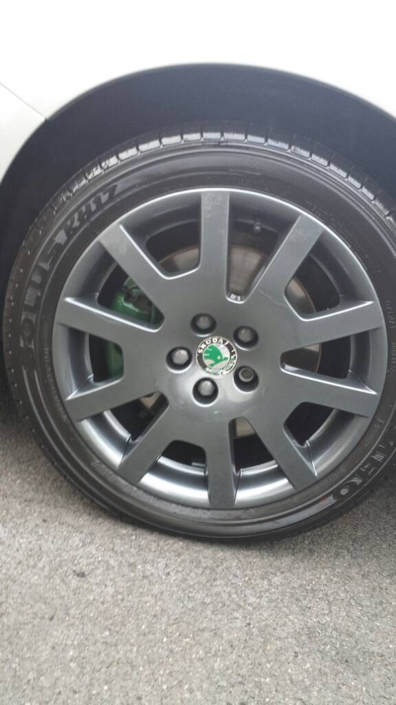

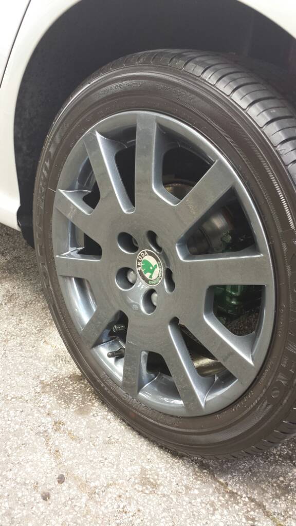

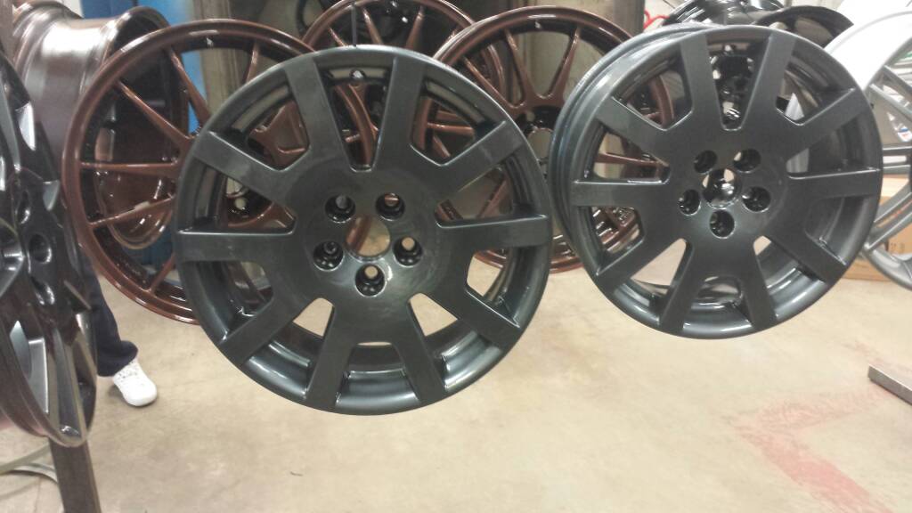

If anyone is interested. All 4 wheels powder coated for 50quid by city powder coaters in birmingham

Finish looks iffy but could be the pictures.
Are they 100% powder coated?
I mean on the rear too?

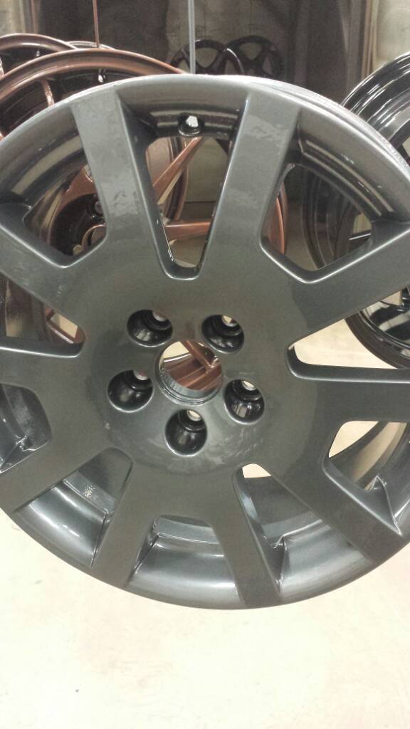

It looks like the bolt holes are also powdercoated, that's not
ideal. I hope the mating surface on the rear isnt done as well?
Right the pics was taken during the process. Meaning they wasnt finished. When finished the hubs and bolt holes are cleaned out and yes 100% powder coat

It cost 60quid including stripping and fitting including balancing. I did leave them with him for a week. They are shot blasted and dipped all depends on condition of alloy. My wheels had been shot blasted. Treated. Primered. Then grey metalic flake and then laquar. I got them done through a mate of a mate. But he will charge that price to anyonr that mentions my mates name
