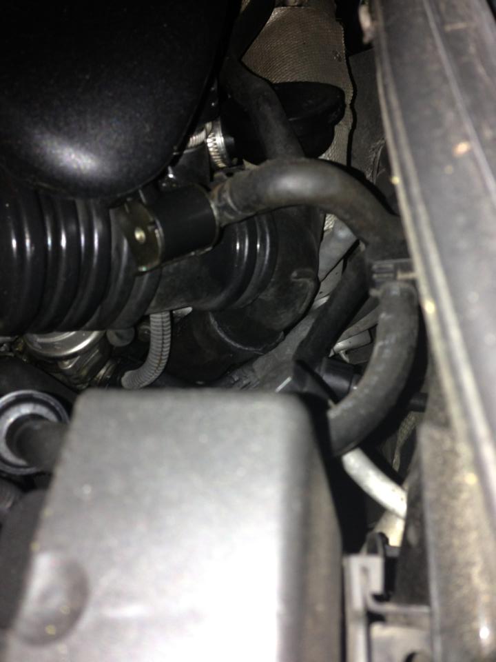

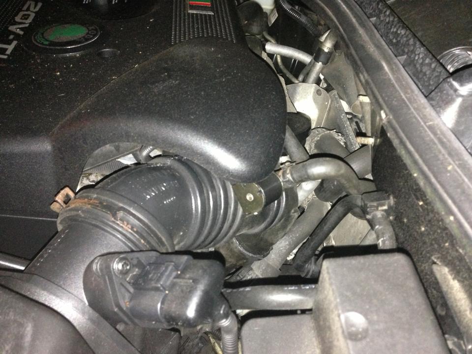

However looking at my hoses tonight I could see that the Turbo to Intake hose has a slight wetness to it, and it's an oily substance.
This will obviously need to be changed, would somebody suggest what to go for?
Also could this cause the problem? The car feels fine to drive! Thanks :)
That could be due to the PCV hoses putting in oil. The crankcase ventilation goes in at the flat disc (hockey puck) thing on the TIP so could be wet inside from that.

Thanks for replying, mine is almost the same as yours only it doesn't smoke at all from cold. It's very odd. I'm going to buy the pcv hoses and the TIP as well and replace them and fingers crossed that's the problem!

It clears on a drive, well i dont see it in the mirrors anyway, boosting perfect driving amazing, just poxy smoke. From what i can see i do need a new TIP, not sure if that's enough to stop this but definitely needed as there is a bit of oil around it. Possibly the pcv hoses need doing too, but its a costly game if they dont fix the problem.
If you check the breather piping be really careful with the pipe that comes up past the head from the crankcase and the ''Y''one that comes from the rocker cover they are both really brittle and if they're not cracked already they won't be far off it.
