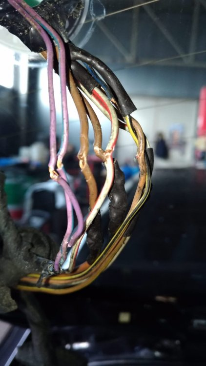

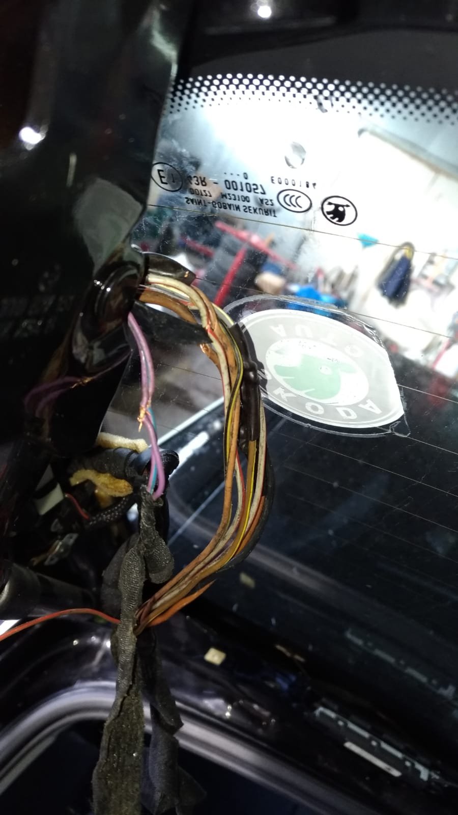

Working inside the boot lid release the wiring from its plugs, note the route and feed the wiring loom out of the lid through the hinge and free of the car to just past the damaged area, below are 2 pics of the wiring condition that greeted me! Plus stripped tailgate open.
I repaired my loom but believe that a repair section is available from Skoda, the repair can just about be made without shortening the loom so much that it is strained at the boot lid connectors, when repairing the loom mark the wires carefully as some are the same colour!  Refit and connect the wiring.

After many error regarding bulbs from rear part of the vehicle it escalated to failure to open the trunk in full mode.
Wiring stretched and isolation compromised creating an erratic functioning of tailgate opening.
Replaced faulty wires from a British donor Jaguar XF - great quality :giggle:

On my car 5 wires were completely severed (6 if you count the one which someone else had bypassed previously), including the 2 thicker, brown, CAN buss wires. Obviously I had no way of knowing which way around these should go. In the end I either got lucky (there's a 50% chance of getting it right) or the CAN wires can go any way. Fortunately only one of the purple wires was severed so no such problems there.
Of the remaining wires 3 more had obvious damage and one appeared  OK.  As I was adding some additional length I cut them all then trimmed all back 20mm at each end so that the new wire would be in the problem area.
Got to say that this wiring routing is really poor, folding the wire back against the edge of lip of the tube which makes up the hinge is just asking for failure.  And for what? OK the twin door is a great party trick but who would really miss it if they only ever had a hatch. No wonder Skoda reverted to that eventually.

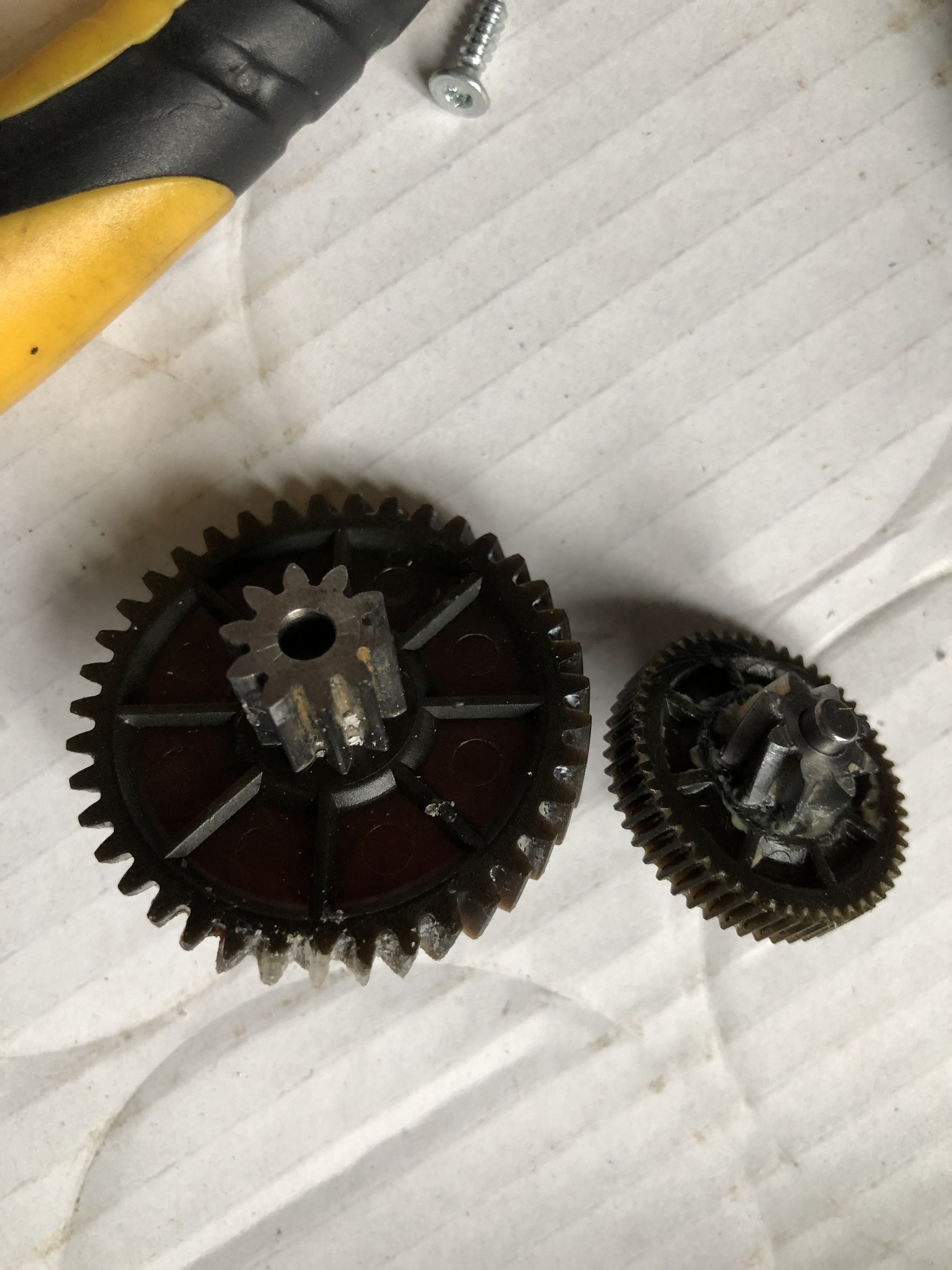

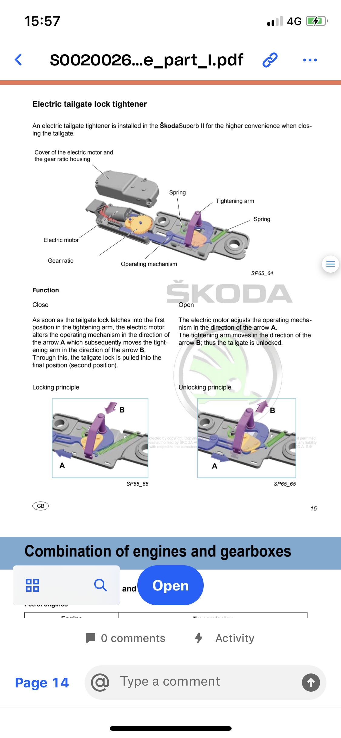

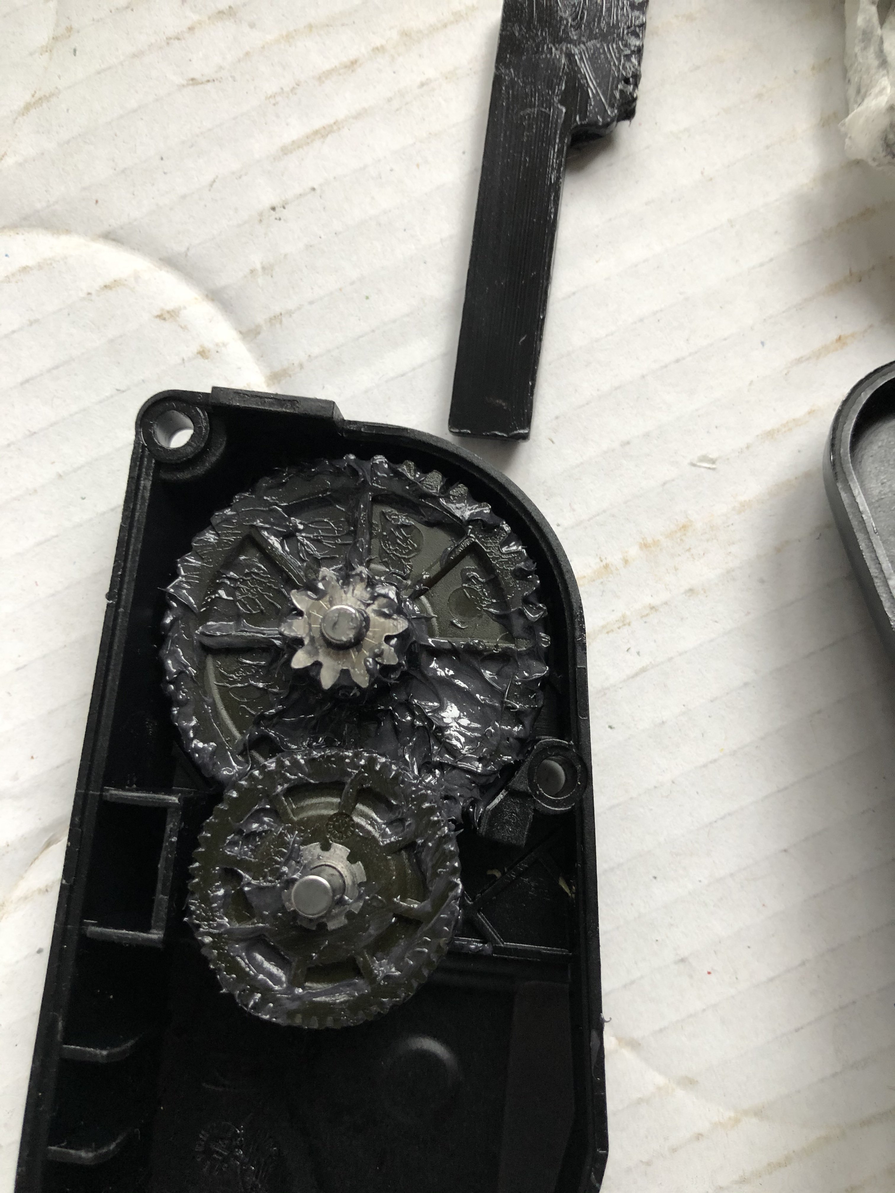

my Skoda Superb opens the boot’s door (the lid) after 5 seconds by itself. When I lock the latch with screwdriver on the boot’s door the operating mechanism moves to the right pulling the Tightening arm down, Just after 5 seconds that operating mechanism moves back to the left by itself and the tightening arm comes up (opens the boot’s door) but the hatch on the upper side remains locked until I press on the lock switch or by remote fob.
When I close the boot and go sit in the car, it opens by itself so I need to drive with open boot, the boot is not coming up but it’s loose and makes noise.
I can’t understand what’s the problem
Anybody Has any clues
thanks a lot

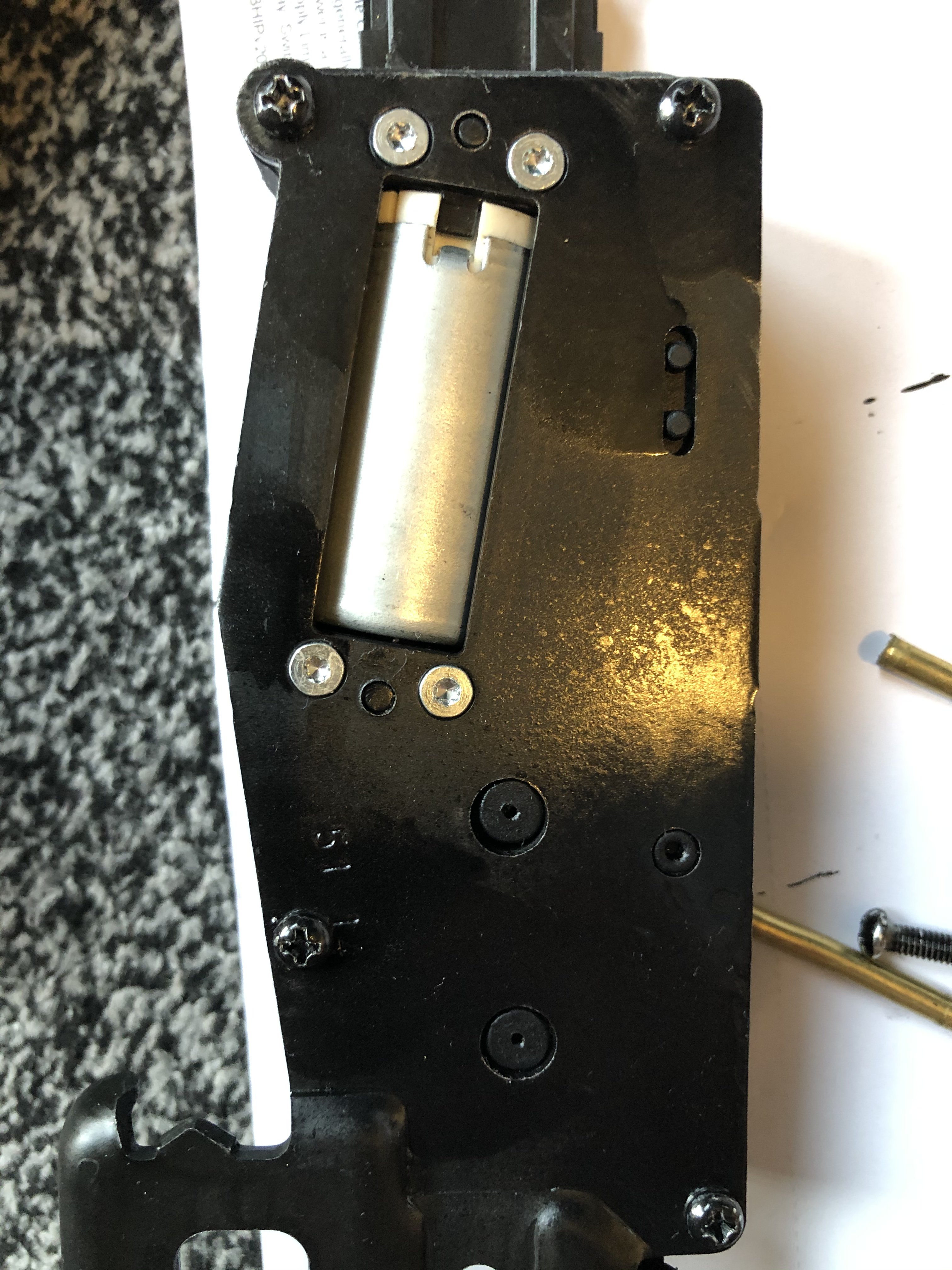

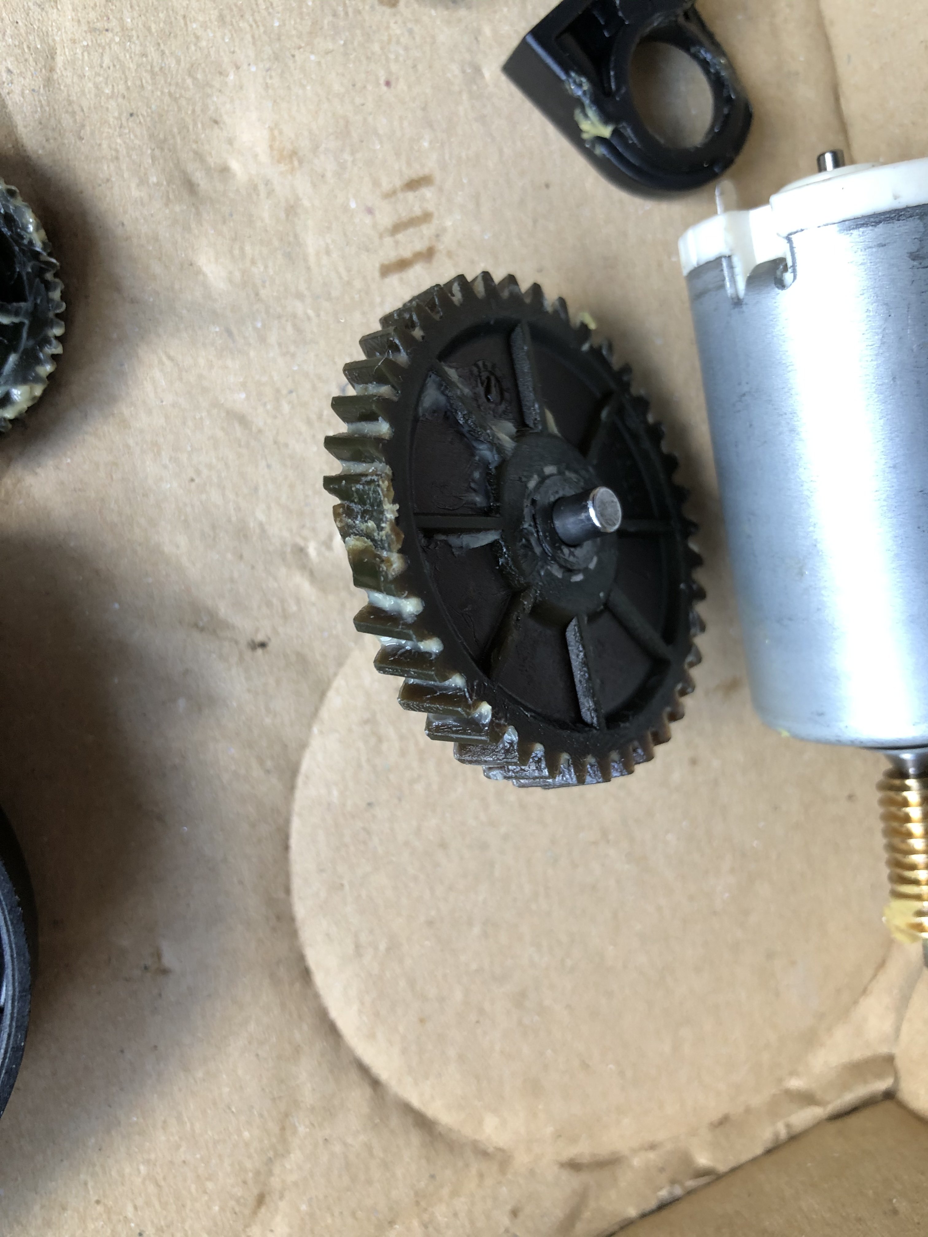

I answer my own question in case someone have the same issue: opened the lock, dismantled it, a plastic gear was damaged, repaired installed the gear and installed the lock works great.

Hi, I don’t think you can buy it separately but you could repair it yourself,
 It’s PA66 plastic hard enough not to break.

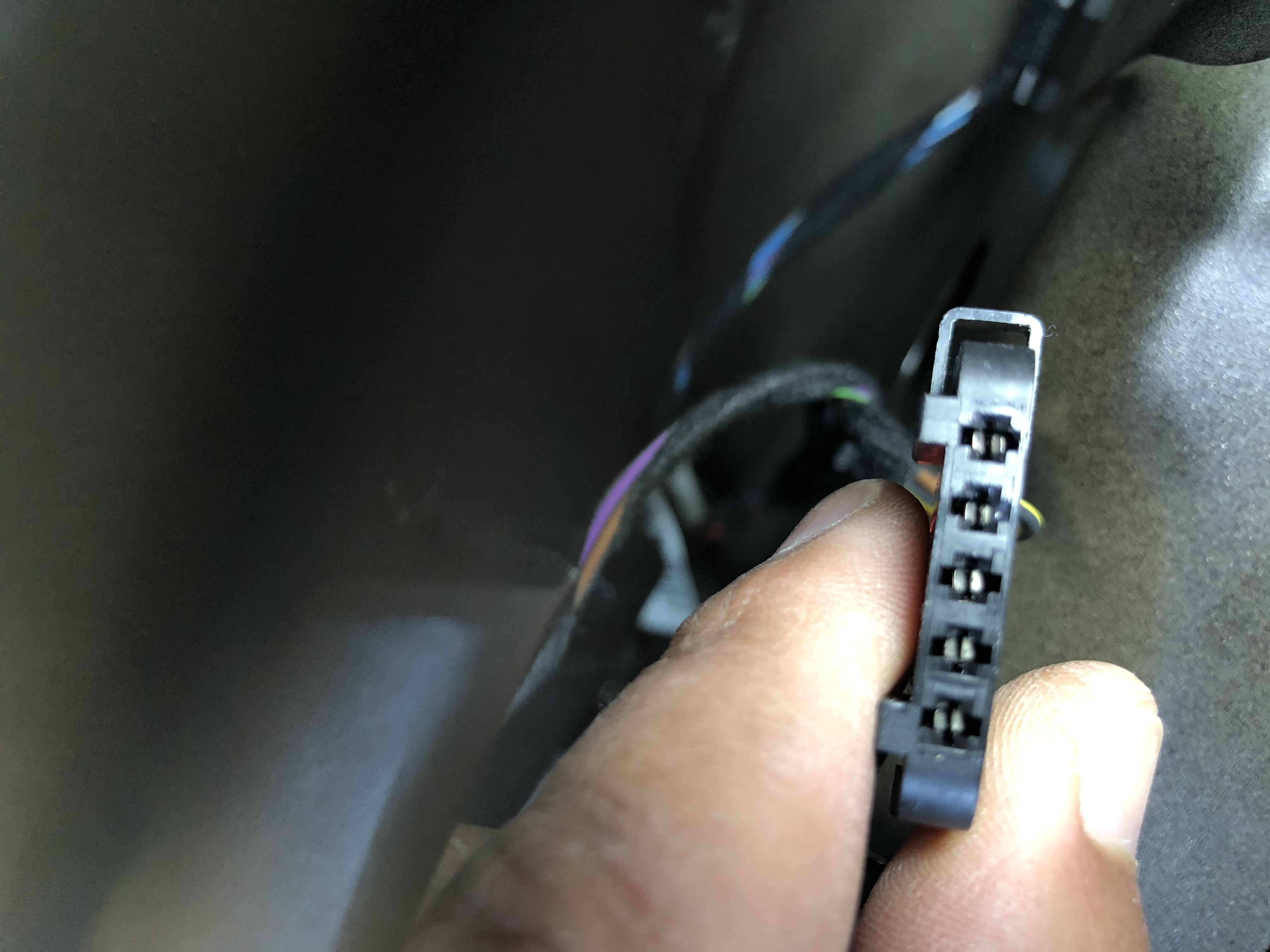

it’s not breaking easily try to find the reason why it’s been damaged. Test
the multi pin connector at the back of the lock if they work properly.
See the pictures one of those female connector wasn't work probably that’s y it damaged the gear.
