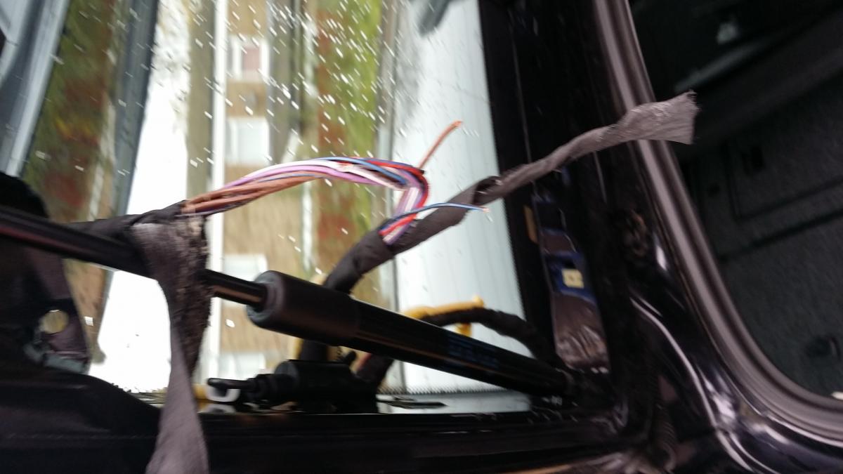

Working inside the boot lid release the wiring from its plugs, note the route and feed the wiring loom out of the lid through the hinge and free of the car to just past the damaged area, below are 2 pics of the wiring condition that greeted me! Plus stripped tailgate open.
I repaired my loom but believe that a repair section is available from Skoda, the repair can just about be made without shortening the loom so much that it is strained at the boot lid connectors, when repairing the loom mark the wires carefully as some are the same colour!  Refit and connect the wiring.

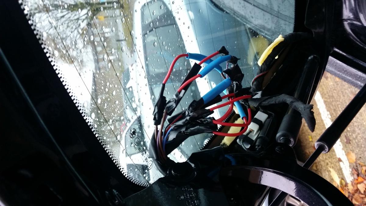

Option 1 - heat shrink crimp connectors to repair loom, using something like these, not sure of wire gauge though.
  • Could someone advise if I add in a series of these for all wires, will there be enough space for these wires to move in the space provided or is this too restrictive a fix?
Option 2 - replace wiring loom, price and complexity permitting.

I JUST DONE MINE AND THE WIRES WHERE BROKEN SOME EXPOSED SO I CHOSED TO EXTEND ALL THE WIRES SO IT SHOULD BE FINE NOW. ALSO MY RIGHT REVERSING LIGHTS WORKING NOW FOLLOWING ARE SOME PICS I TOOK. I WAS STUCK WITH THE RIGHT SIDE TRIM UNTIL I REALISED THAT I NEED PUT A TORX IN THE HOOK AND UNSCREW IT.post-149859-0-67807400-1479139259_thumb.jpgpost-149859-0-97359100-1479139286_thumb.jpgpost-149859-0-67807400-1479139259_thumb.jpgpost-149859-0-97359100-1479139286_thumb.jpgpost-149859-0-33726000-1479139312_thumb.jpg

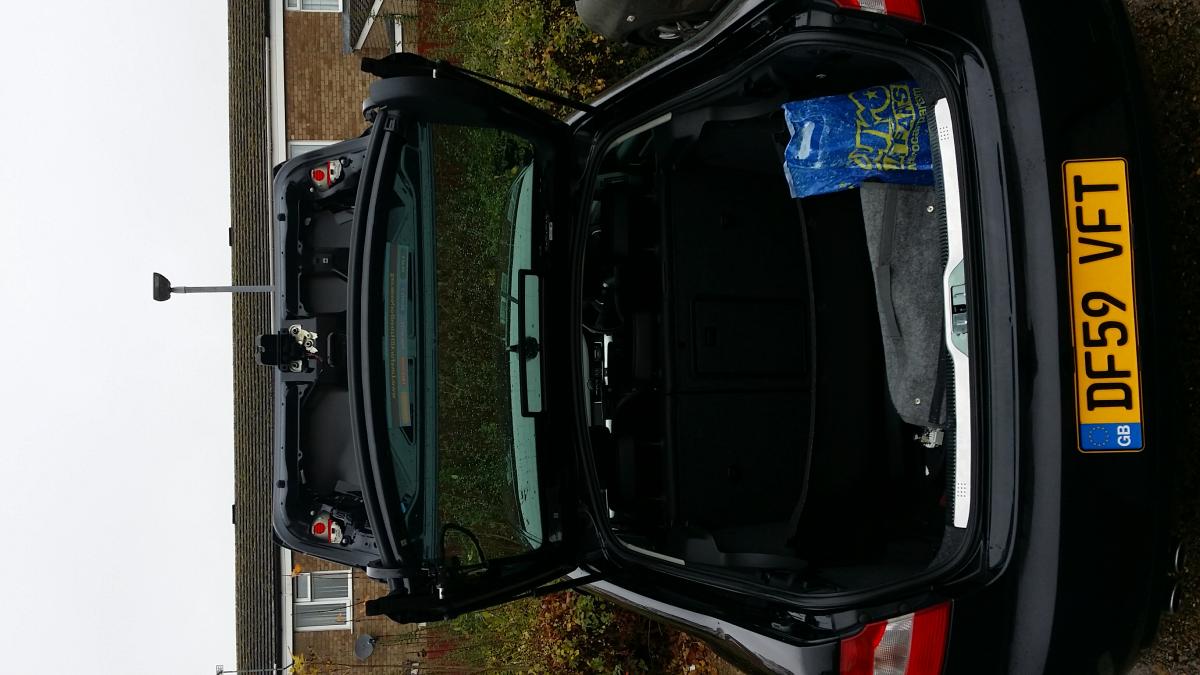

I'm going to attempt this, as soon as I can. I just hope all goes well. I'm worried about not having enough spare cable!
Im just chancing my arm here.
I have no issue with the twindoor but have some unusual issues in the rear end that may be the same cause.
for 4 years now the rear heated window hasn't worked. I posted here.
Several garages have spend hours (and charged for hours) but no solution.
Fuses / relays etc all seem fine.
Now I have an issue with a reversing light not working.
I swapped the bulb and its not the issue and put a meter on it and there is no voltage.
One thing i notice is that the MFD says check the right reversing light but its the left one that isn't working.
The questions I have are
1 - Are the twindoor, heated rear window and reversing and fog light cables all in the one loom and is it possible that they are damaged as the posts above.
2 - Is there a wiring diagram for the cables for all of the back of the car ?
One last question - as a temporary fix if I connect a jumper wire from the right reversing light to power up the left one will that be OK or will it cause an issue to the ECU ???
Edited by dfsuperb
The reverse light was one of my first issues with the whole boot door.
Initially I ran a cable from one to the other and it worked fine.
I would say that some of your cables are broken.
AFAIK, all the cables that provide power to the stuff in the boot door all come through the same point in the car.
I've never seem a wiring diagram, just pictures that people have posted on here of the cables.

Eventually got to bring my car to a local auto electrician who had done a few of these recently and they replaced a section of the loom away from the tension area and all works fine again.
It was emotional to have the rear heated screen working after nearly 5 years.  :biggrin::biggrin::biggrin::biggrin::biggrin:
