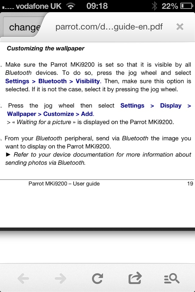

My next question would be how do ypu change the background picture?

Ive attached a screen short from a PDF on how to change the background,
Hope it helps
