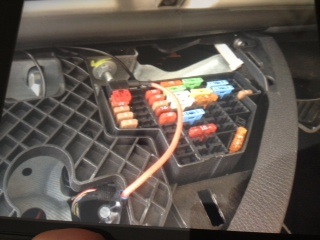

I just did mine again today to add a USB plug in the top box
I used a piggy back fuse and wired it to the parrot kit while taking a feed off for an extra cigarette / USB thingy so that it was ignition fed and not perminately live. I hid all the bits around the stereo underneath or to the right hand side making sure to tape bits together so they don't rattle or vibrate

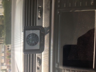

My top box now looks like this

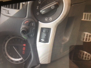

And when I was working on it. The red tape shows where the additional cigarette socket is located

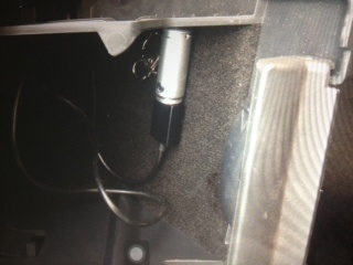

At last finally got them to upload,
God only knows why there on there side

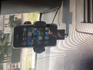

I split the lead with the inputs ,and ran one up to my phone holder so I can charge my phone,
The other runs to the box down by the steering wheel that one houses the usb feed,
