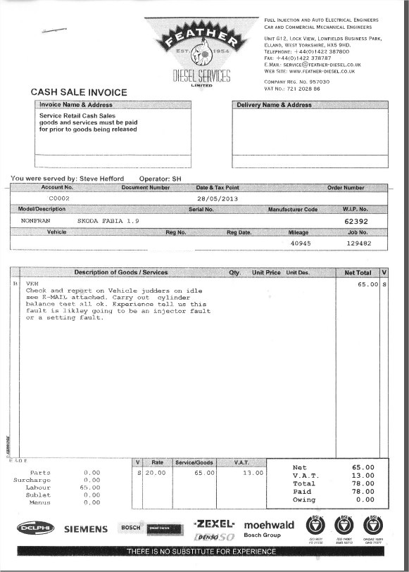

About 5 months ago I took the car to a place called Feather Diesel who also confirmed the running of the car is incorrect who are diesel specialists. See the report attached.
