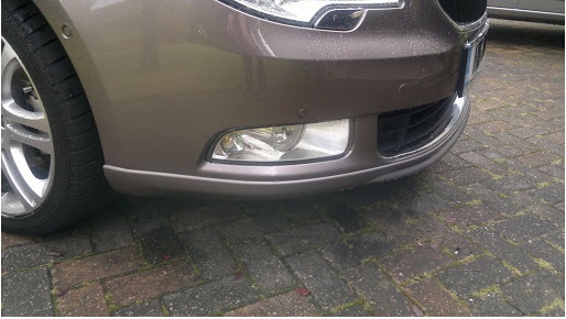

Does anyone have the OEM Skoda Superb front splitter/spoiler fitted to their Superb?
I'd like to get one for the v6, but I can only find tiny images on google, if anyone has one fitted I'd like to see theirs! :)

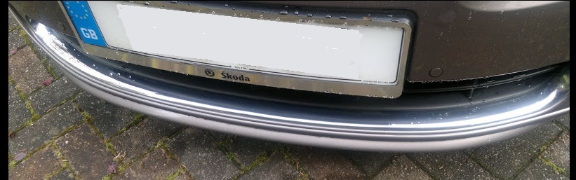

Spoiler all one piece and comes unpainted.
Secured by screws and adhesive.
Used polyurethane adhesive similar to...
http://www.ebay.co.uk/itm/PU18-SEALANT-ADHESIVE-SILICONE-STRONG-MARINE-RUBBER-POND-AUTO-GRP-CAR-WOOD-METAL-/221082176764?pt=UK_Crafts_Cardmaking_Scrapbooking_Glue_Tape_EH&var=&hash=item3379864cfc
Did not use the recommended tape method to hold in place until adhesive set.
Used bricks and wedges to apply a low pressue to hold in place for 24 hours.
This type of adhesive likes moisture to cure... sprayed with water to help it.
PU adhesive is like a very strong silicone type adhesive, use gloves...it sticks easily to hands!
Smooth off before set with isopropyl alcohol.... use this to clean mounting surfaces.

Thanks for that, think I'll look into one next month :)
