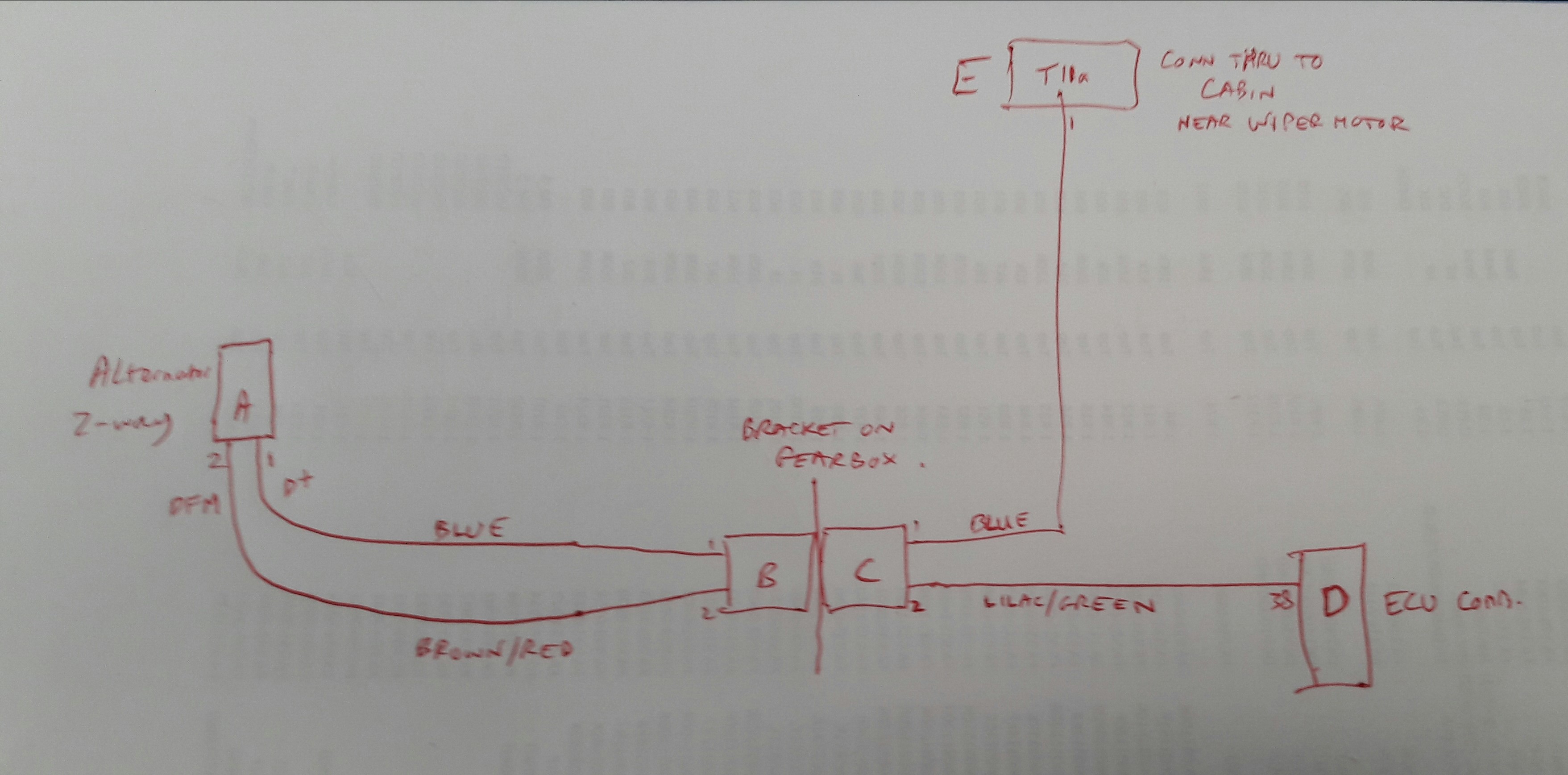

I wasn't quite sure what you meant by "I want to replace the whole cable", so I took a guess at the section - part of the alternator loom - that goes between alternator and one half of the connector pair on the gearbox bracket. Conns A to B in the pic below.  Which did you mean, if it wasn't that?

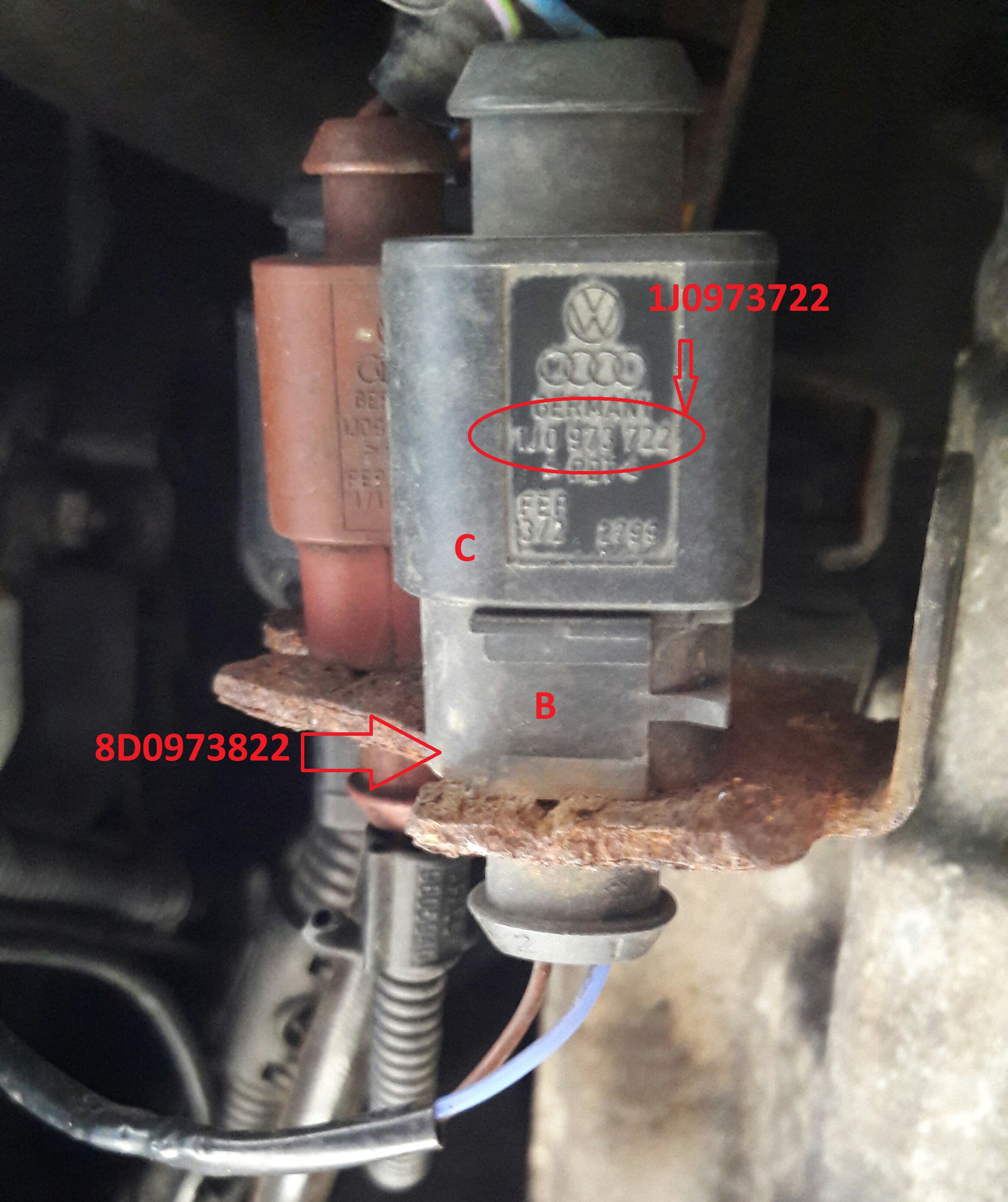

BTW my link above to a pair of conns that I thought might be A and B was a bum steer.  I've just found an example of an "A" connector that I know has been plugged into my alternator on the Polo, and the part number on the housing is 1J0973772. I've gotta go under the car tomorrow for something else so I'll try to see what PN "B" and "C" are while I'm there.

Something got broken when fitting the clutch, usual no battery light and flat battery, thought be easier just to replace whole thing as I have no idea where it's broken so replace the whole thing from a to e/D - b/c don't exist on my car as I've removed them for an earlier repair
  • Sponsor

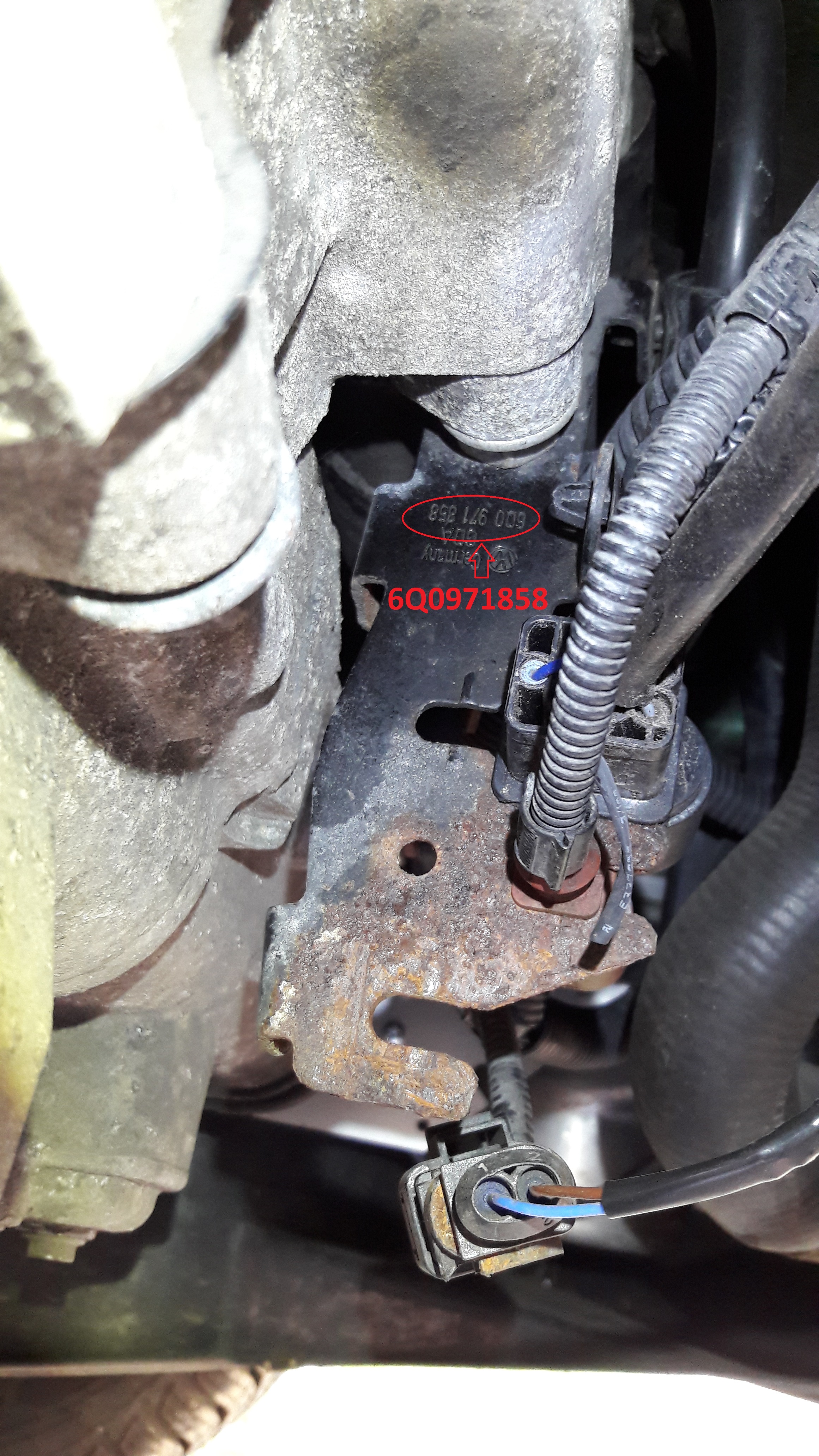

Blue wire's the one for you to try and find a break in then.  Can show you where it goes through the firewall (right hand connector block behind wiper motor, top left wire group, bottom left wire) and where it goes into the onboard supply control unit in the cabin later when I've found the relevant photos. Most likely to be busted near the gearbox bracket though, I'd've thought.
In the meantime, for what it's worth here are some part numbers for connectors B  (8D0973822, same as 1J0973822 I think) and C (1J0973722) in my little sketch above, both to be found on ebay for not too much cash separately, or both together for not much more like here for example.  Will try to find the part number of the rusty bracket too and add that in for completeness.

Bracket may vary with engine type/year/model/equipment. On my Polo (BBY engine, 2003) it's 6Q0971858 (no suffix) shown as the first item 19 here.
I would caution anyone trying to remove these pairs of connectors from this bracket that if it's as rusty as mine in the above picture, you're quite likely to break the connector that's slotted onto it, while trying to remove...
Here's a pic of the one on my Polo, from the other side compared to the previous photo. Should at least show where to look for the part number if yours isn't exactly the same.
I'll see if I can get a price for a new one on Monday, but the "Cancelled since 01.07.2012" line in the parts site linked above doesn't fill me with hope so I may just be refurbing that one.

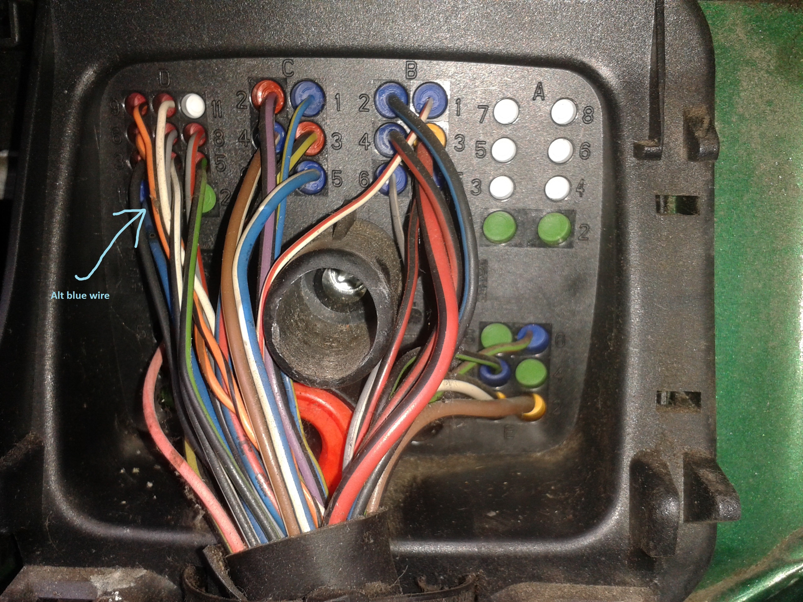

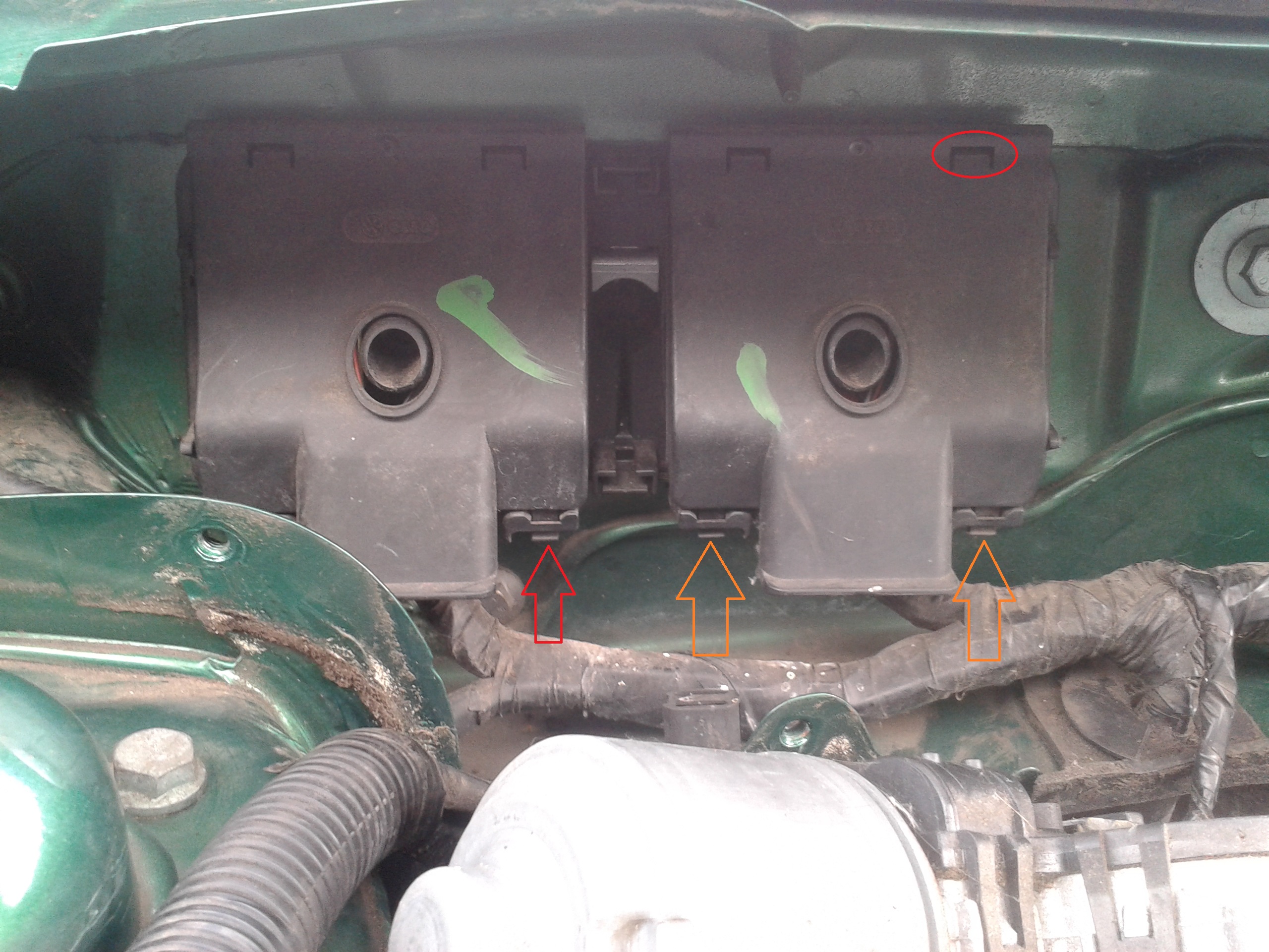

Here's the engine bay start of the blue wire, coming through from the cabin behind the wiper motor:
That's the right hand of these two connection boxes as we're looking at them:

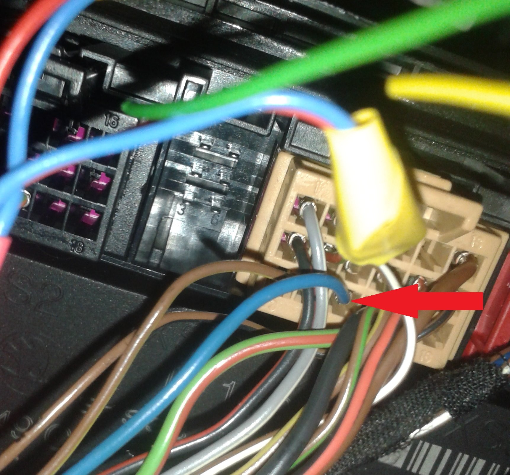

Red arrow shows the origin of the blue wire within the cabin is the onboard supply control unit: the pin that the blue wire goes to is  No.9 of an 18-way light brown connector that plugs into position "XS4" shown in this photo:

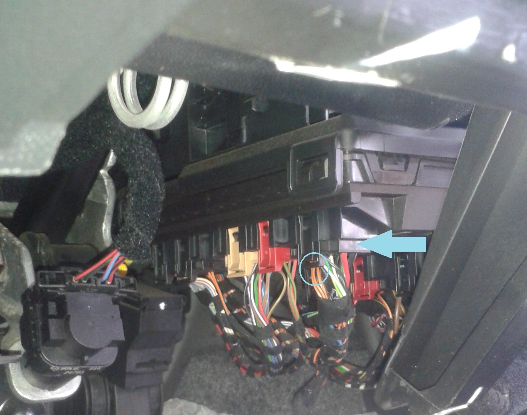

Here's another view from a different angle and further out of the same light brown connector. Lower dash trim above/behind the pedals must be removed for access.

Find the blue wire at the point I've shown behind the wiper motor, or preferably much nearer to the front of the car, and splice a new wire onto that. Or cut and splice a new one onto the wire coming out of the onboard supply control unit and feed it through into the bay.  :thumbup:
